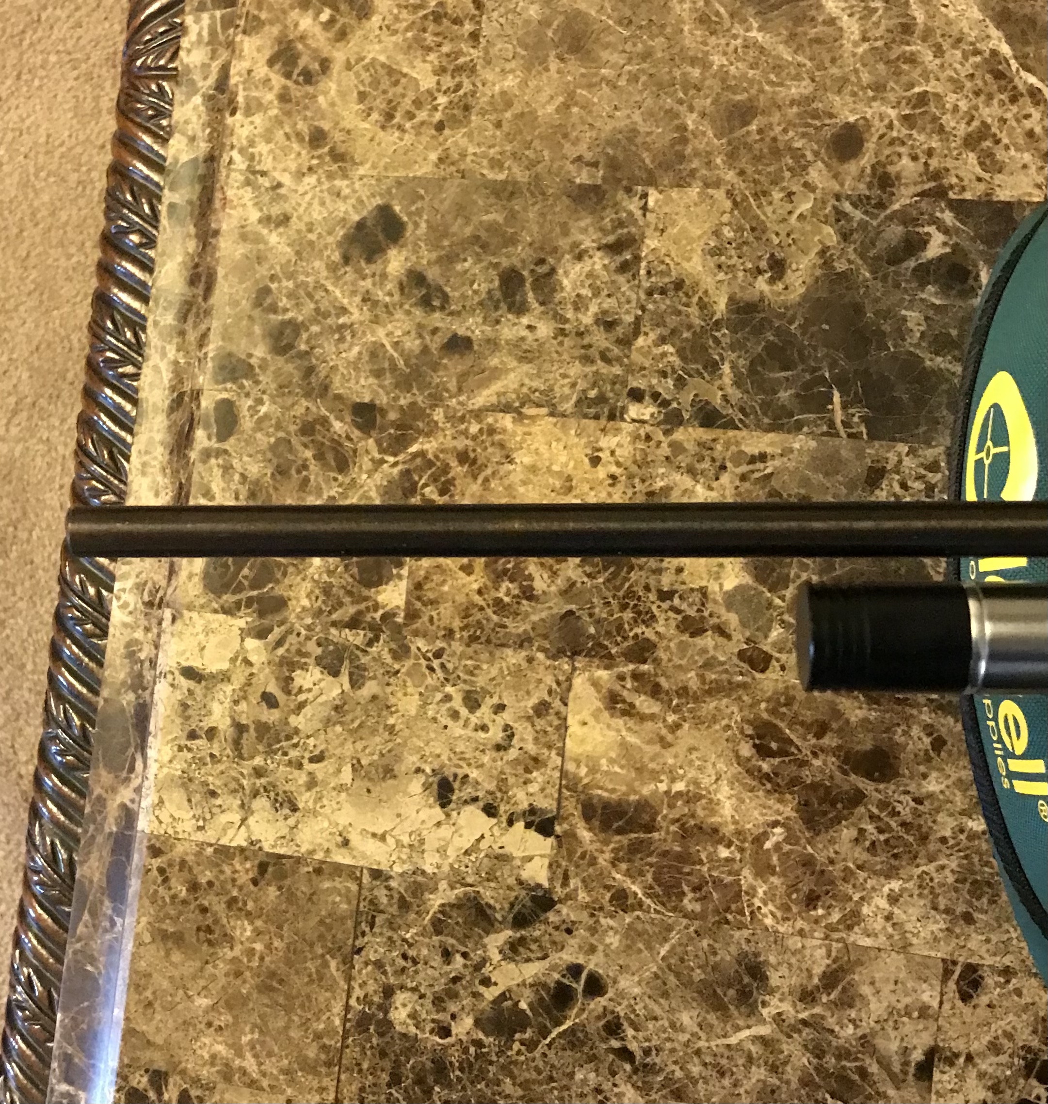

Thank you Darkhorse via fuzzygrub for the heads up. Had to drill two extra holes in the Fortitude tube for the two forward breech screws. Please excuse the terrible pic.
Nope, it's a 20" M-Rod rifle barrel. The Fortitude tube is even longer than the P-Rod tube with extension, so may acquire a 6.5" TKO, as the unit installed is only 5.5", I too have ocd lol -

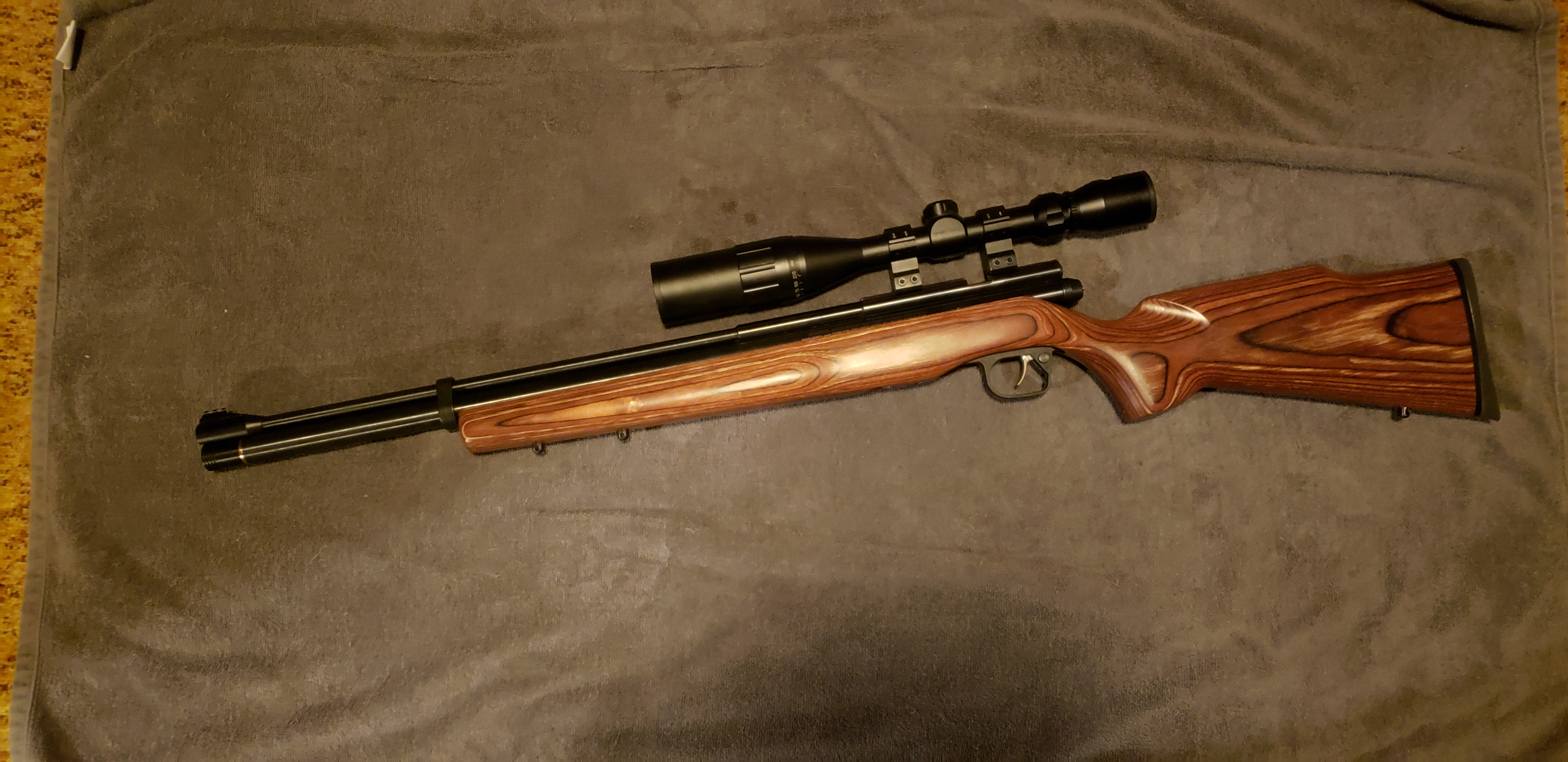

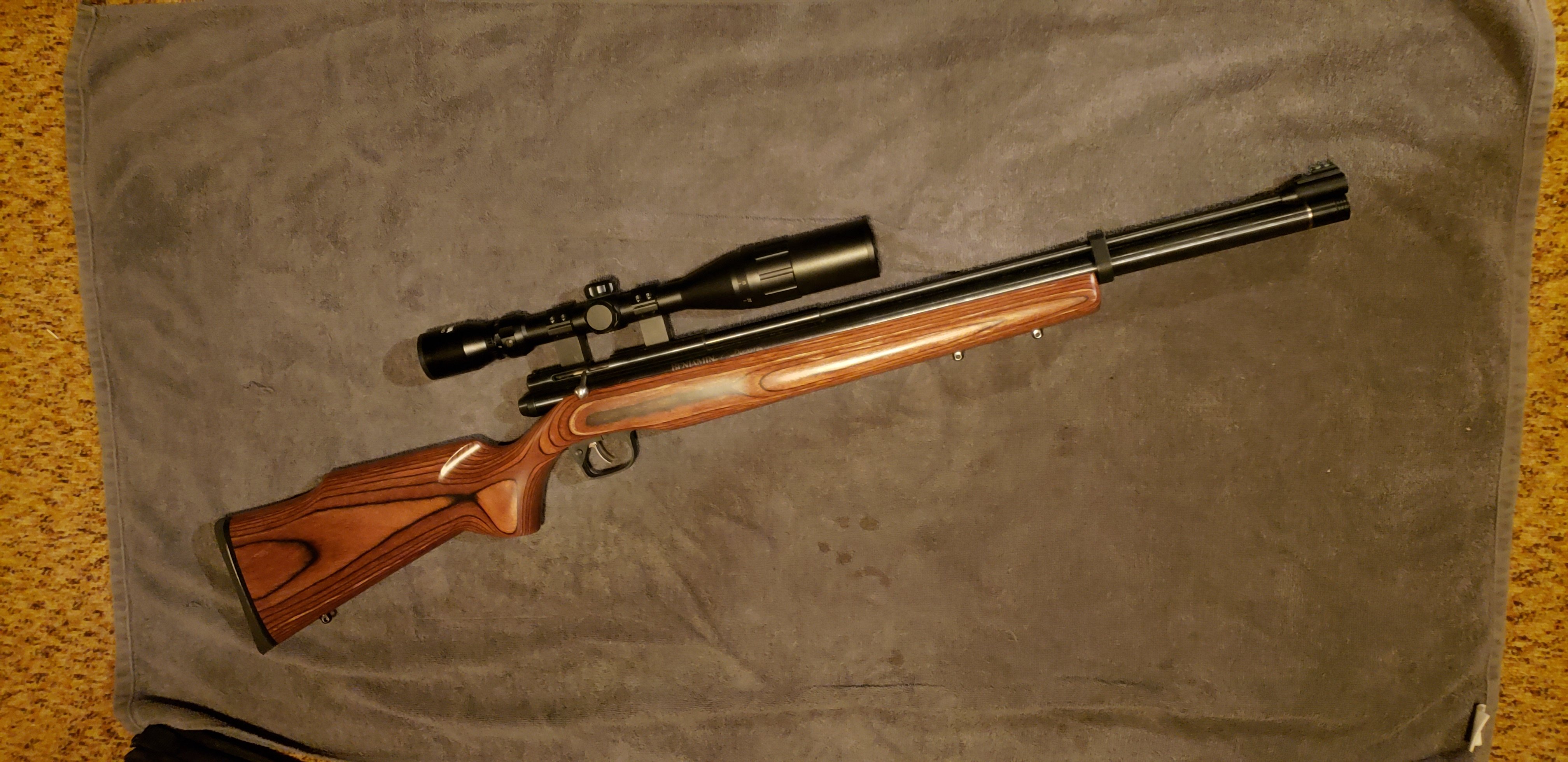

I would love a Boyd's rimfire hunter stock if I knew it would be lefty friendly.
I had my disco in one for a bit. Ended up not digging the nutmeg finish or the length of pull, but it looked nice and it was lefty friendly. Doesn't have a fat comb on one side or the other, just the rise in the top.
hhmmm...stock 13&3/4 lop too short? That is not too shabby a look, sling studs included.
