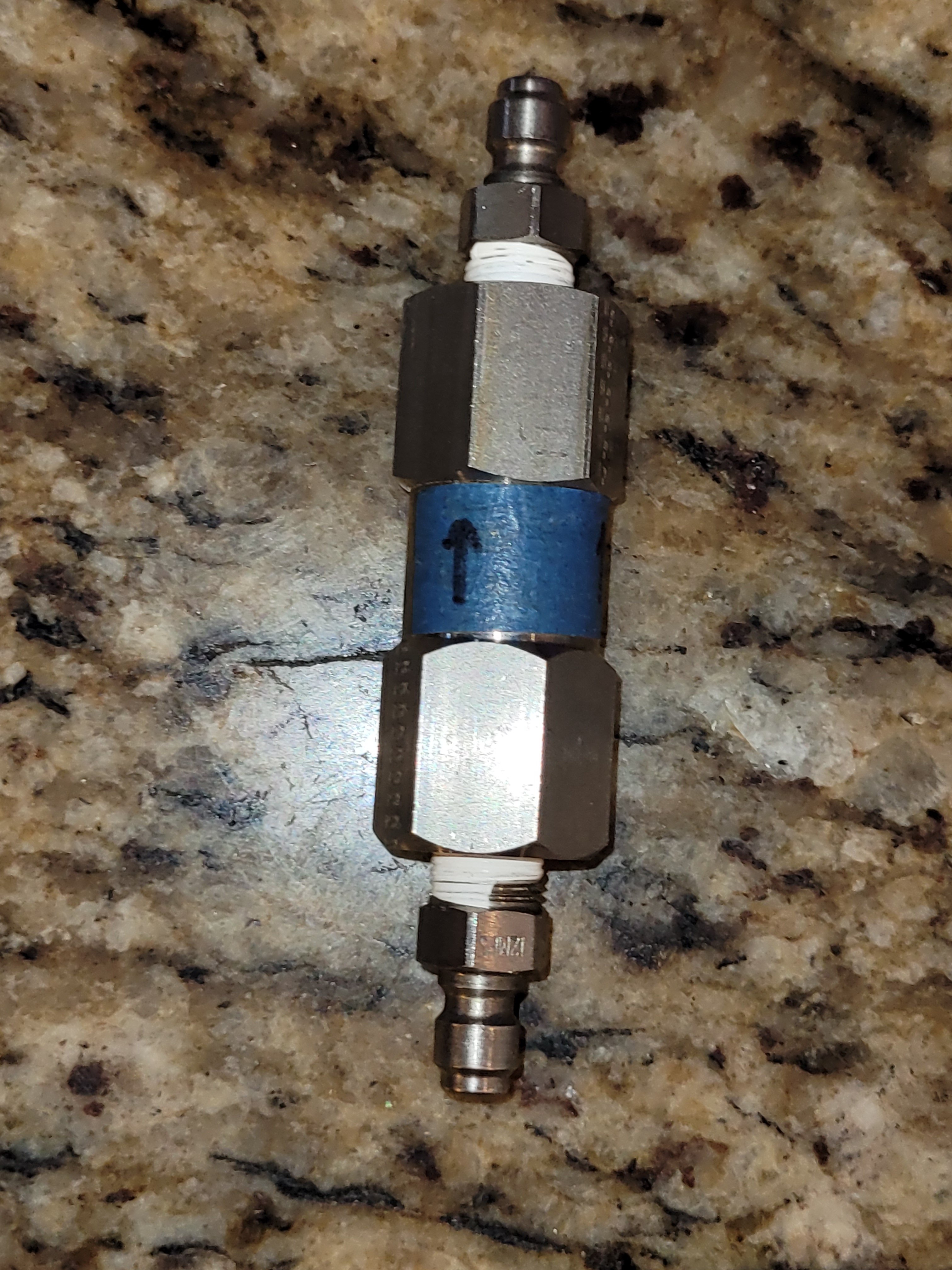

This is exactly what I have done. I wrapped some tape on mine and drew an arrow to indicate the flow direction. I have 3 of them and use them at different points when filling tanks. I use one right after the yong heng filter, then another after the coalescing filter/water separator. That way i can open my tank valve right away to pressurize the tuxing filter. Then the water separator can build up pressure before going into the tuxing media filter. This also allows me to vent different sections as needed without depressurizing the whole system.

Buy this :
And this with matching threads
Screw them together and you have your one way valve.
Exactly!!! Did the same thing last night with fittings I had in the drawer.
