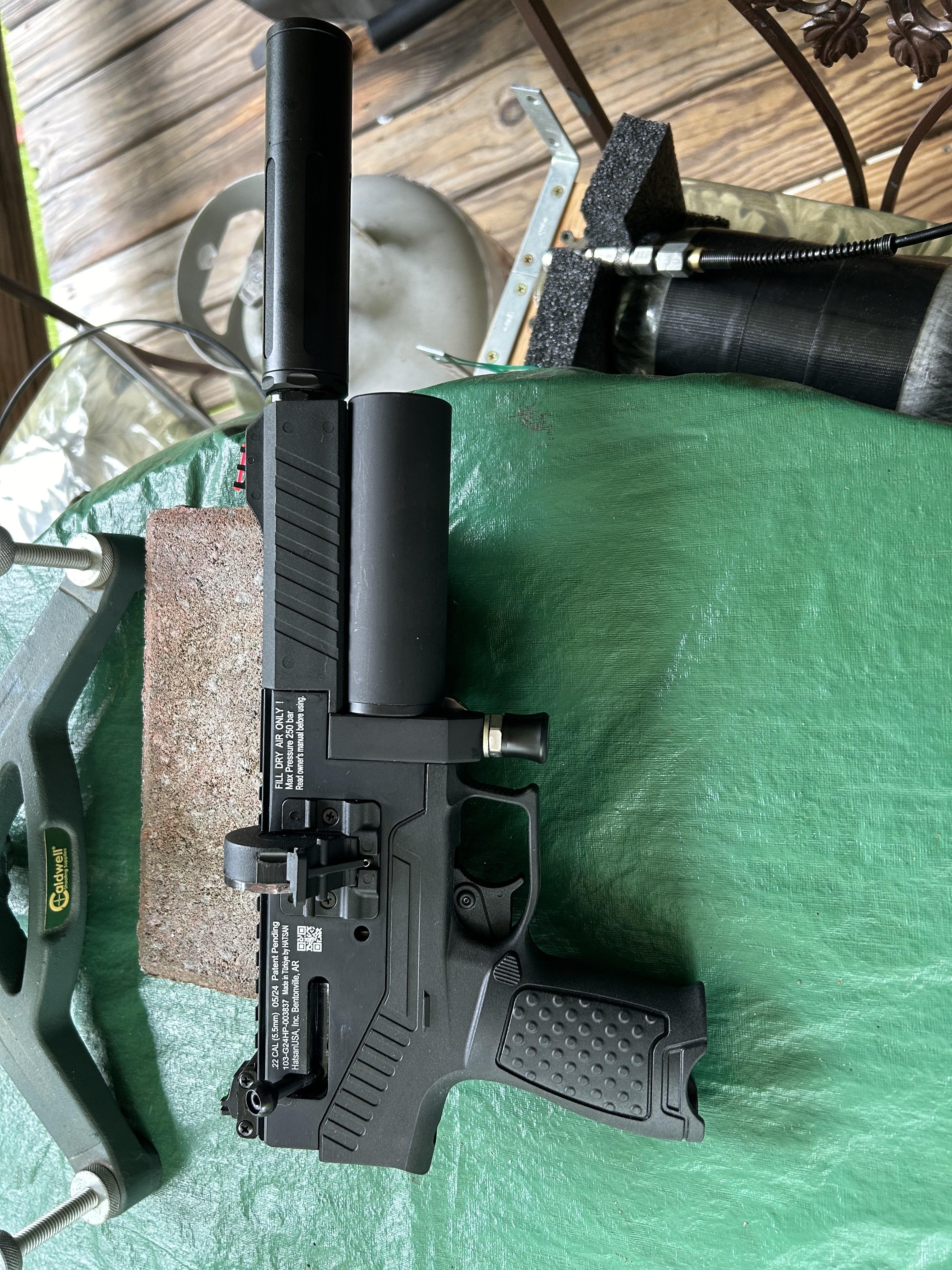

I have used my Hatsan Velox for a week now and have the following impression: Summarized, it is a good buy for what is can do. I have put around 1000 CPHPs downrange without one malfunction. This includes at least 200 pellets fired as fast as I could pull the trigger. I put a Donny FL Tanto on it and that reduced the bark enough to make it very backyard friendly. The Tanto in the tube fits nicely in the pistols case. Filling it to 250 bar with an accurate gauge will render 24 shots, albeit the velocity reduces about 6 to ten fps per shot. FX Pocket Crony for 24 shots is below:

What it is: Inexpensive, Accurate, Well Balanced, Well Made, Decent Trigger Pull, Great Plinker.
What it is not: A Huben G1 (but it did not cost $1200), Dime sized group at 10 yards, 30 ftlbs power.
If you are looking for an inexpensive PCP air pistol to shoot cans, army men, rocks, pine cones, leaves floating on the water, and varmints at 10 to 20 yards; it is a great choice. I shoot one mag and refill. That gives me consistent accuracy, muzzle velocity, and power. For a long shooting session, I tether it to my tank and set the regulator on the tank to 200 bar. I have only used the iron sights and have been able to consistently produce half dollar 12 round groups at 10 yards. I am sure the groups would tighten with a scope or red dot, but a half dollar with iron sights is about as good as these old eyes will do.

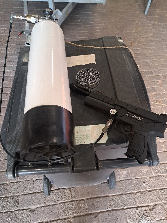

I yust recieved my Velox yesterday. Shot about 100 pellets without any malfunction.
Its better than what I expected so far.
Still in reviewing and testing mode.
I find it quite heavy and front heavy for of hand shooting.
And ofcourse is a G1 better. What can you expect for this price.
Around €400,- in The Netherlands

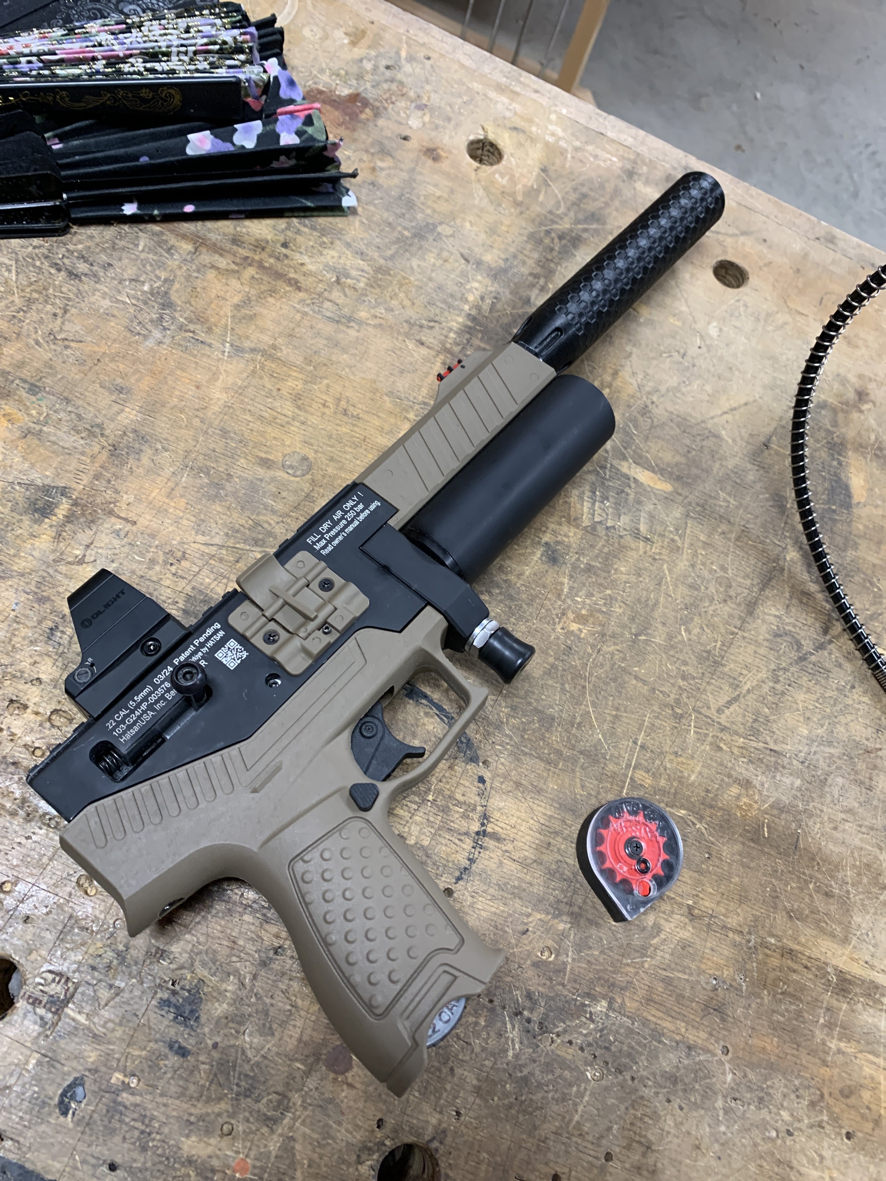

I have a Velox for a couple weeks now. I have also had zero issues with jamming except once when I tried H&N wadcutters. I own 2 other hatsan guns and in my opinion the machining on the Velox is better than the others. That said I did have a little rust in the barrel when I got it. ☹️ I put the Osight from Olight on top, love it. I think i shot it almost every day since I got it.

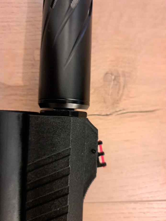

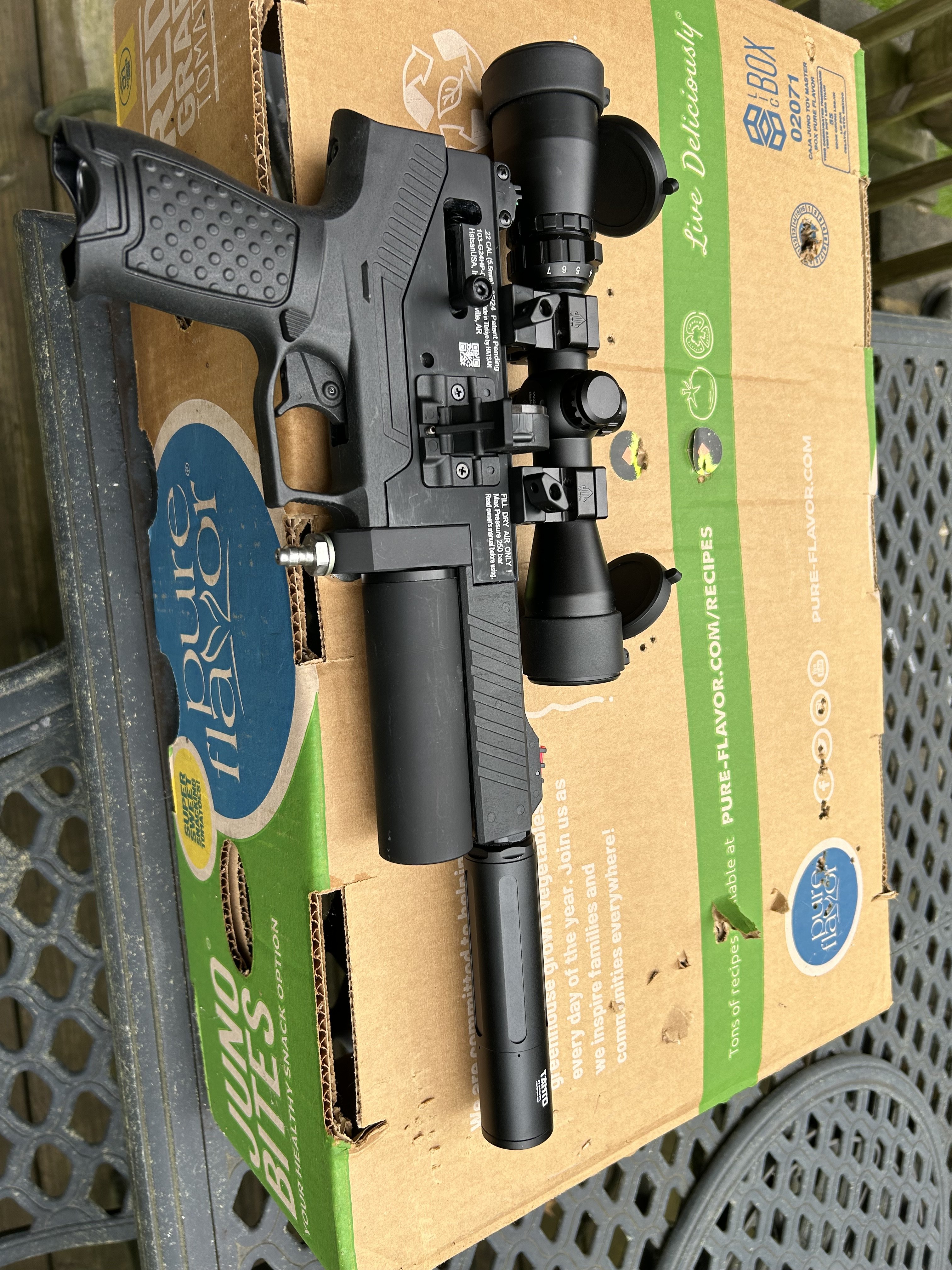

Thanks for this feedback. I know each person perceives things differently but I was super impressed with the balance point on mine which was right on the grips. I am 5’11” and wear a 9.5-10” US shoesize so probably have average sized hands but found the balance point right on center and similar to my SW Mod411. Mine does clip my DonnyFL Shogun in .22 so I might need to size up.
I am running a .25 cal buckrail mod on mine and had zero issues with clipping
