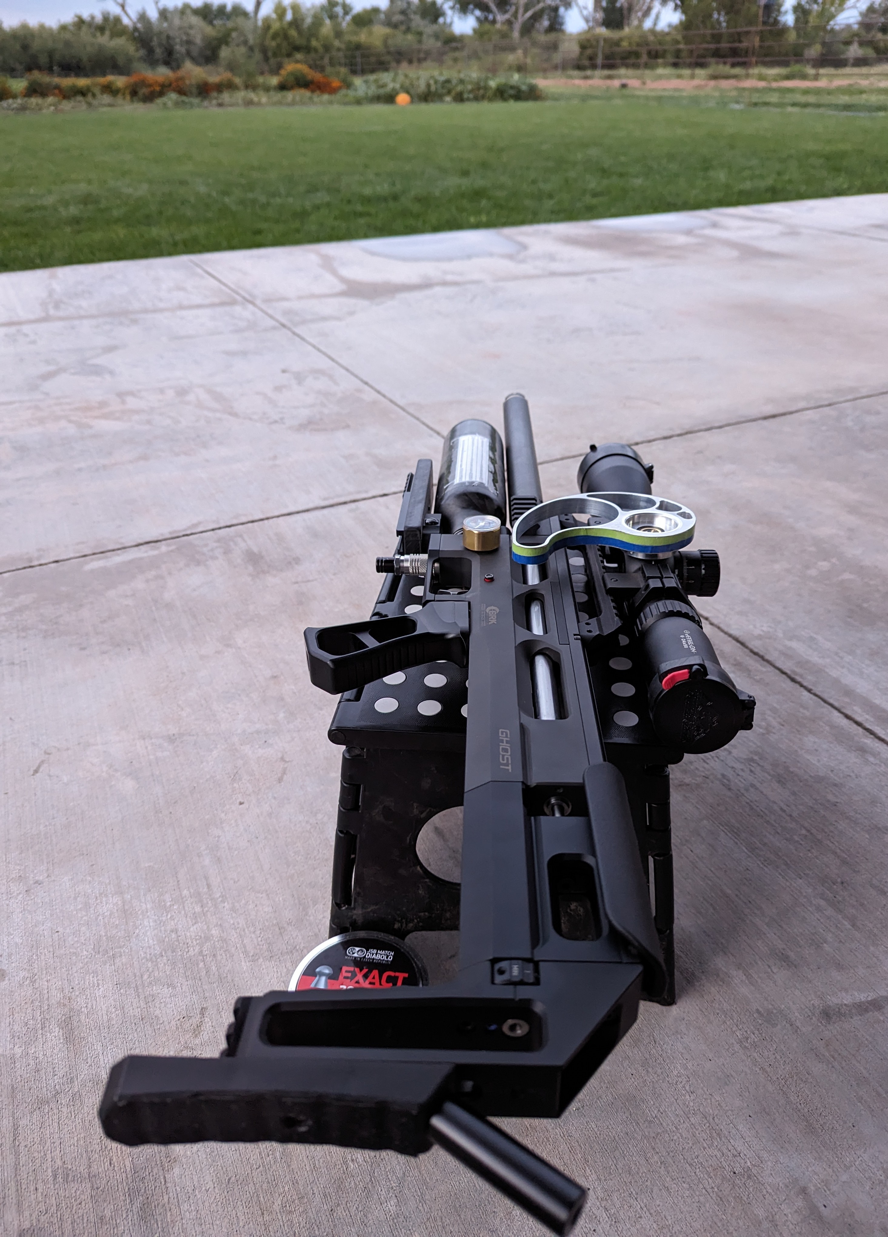

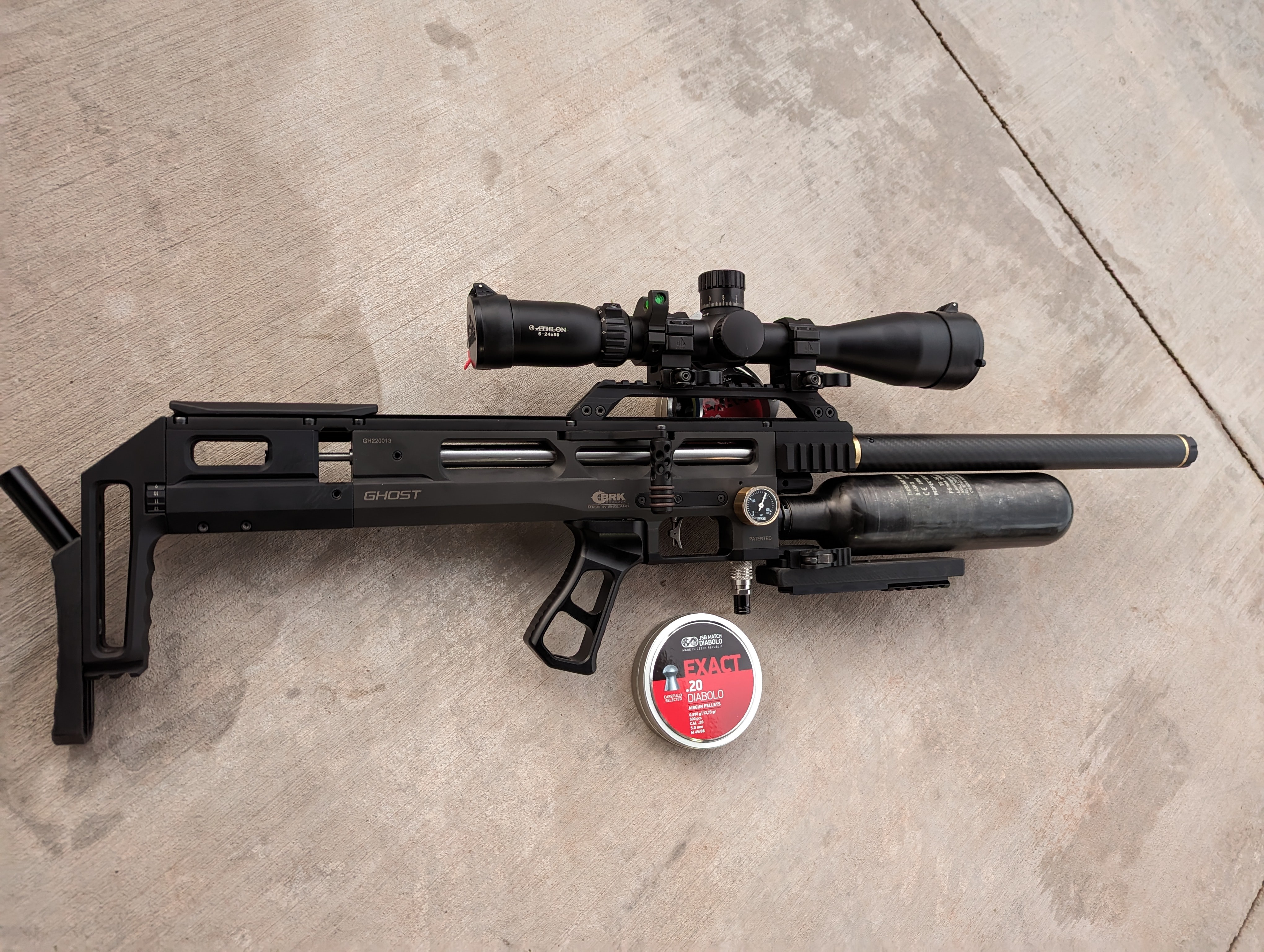

I just finished setting up my Ghost .177 carbine yesterday, My goal was a 11 pound HFT platform and i succeeded!
Derrick Wall took care of the beasty trigger issue and now its perfectomundo.
I had intended to swap the grip for an ERGO style i like but was bamboozled by the way the trigger linkage ran just beneath a very moveable attachment point for the grip..... thus i decided to wait on this mod.
I also added some Neoprene sticky kind to the bottom of the bottle to give my hands a resting place and protect it from the sticks if i slip.
Topped it off with a Nightforce NX8 MIT-X dirty reticle. Used a Rowan side wheel i had while waiting on J. Garland's Nautilus.
I added a Weihrauch moderator simply because all my training takes place in suburbia, but with the Weihrauch moderators i have no POI issues.
I added the PRS cheek riser (dumb) as it was already a challenge to get a good eyebox and keep the scope as low as possible.
I added a PRS Butt unit and a PRS flip out single shot loader.... i love me some PRS products $$$$
My HFT zero was at 32 yards to avoid hold unders. Everything was spot on with Strelock Pro.
I added a small aluminum foldable monopod to the forward pic rail to double as a stop for Sticks and a grip for standers. I wanted to use a different product made by Kinetic but it covered the airfill fitting.

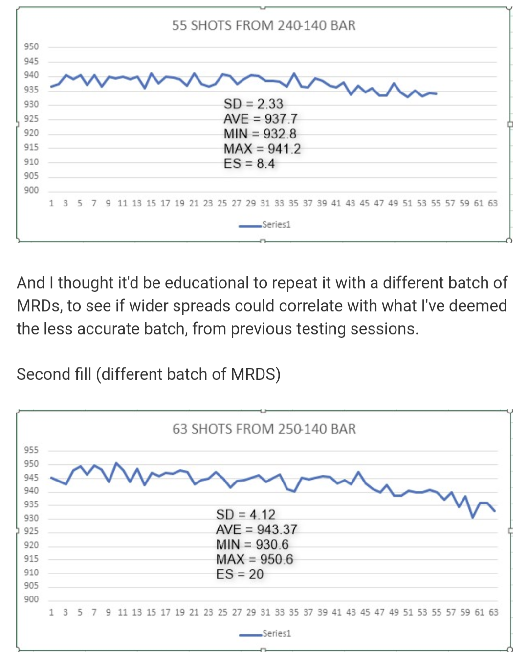

Nice review. This rifle has a lot of appeal, but my main concern is low shot count and low capacity, expensive magazines.
Shot count even in the small bottle is exceptional esp when properly set up. I shot over 100 shots today without a refill. I’m using PRS single shot loaders but it’s not like I can’t use a bigger magazine.

Yours must be a .177 caliber. According to what I've read, the .22 gets 40 shots and the .25 gets 30. Pretty meager methinks.
You got me wondering, enough that I skimmed through the long review and found a couple examples of .22 shot counts.
With the 300cc bottle, .22 and Monster RDs @ 925-930, I cited 34 shots from 250-140bar.
The following screen grab was a shot string from a 480cc bottle, but again, the .22 MRDs, but around 940fps..
So looks like 55 shots/fill (@ power output of just a hair shy of 50fpe) if sticking with a single digit ES, and up to 63 shots per fill if criteria is an ES of 20.
I found a comment @zx10wall made where he got 53 shots per fill from a .22 with a 480cc bottle, although his "tune" was a bit faster, at 955fps.
Sooooo, 55ish shots @ around 50fpe from a .22 with the 480cc bottle seems to be a reasonable expectation. (Data from two different Ghosts).

The reason you’ve been reading that the Ghost’s shot count is low is the imperfect state of tune for a given pellet weight. When properly tuned, whereas the hammer and regulator are perfectly balanced and not fighting to overcome each other, increased shot count is easily achievable.
The Ghost is equipped with a balanced valve that is easily opened even at high plenum pressures. The advantages are that it allows the valve to be struck at lesser impact—which minimizes or even prevents valve damage in the long term, as opposed to the harder smacks on conventional poppet valves—and lighter trigger pulls because of the lower tension on the trigger system’s sears.
I think the Ghost’s most prominent feature is how easily it produces high power at low plenum pressures, especially with its large plenum. As a result of this, the regulator-hammer spring tension system requires finer adjustments to achieve a desired velocity range while both the hammer spring and plenum pressure are in harmony and to achieve efficient air usage, consistency, and a significantly increased shot count. The Ghost’s balanced valve system is so sensitive that just a slight turn of the regulator’s adjustment knob to increase pressure will yield HUGE velocity gains. It’s my belief that it is made to produce a large amount of power without stressing the valve and hammer systems.
My Ghost Carbine, which has only the small bottle, is tuned to shoot 14.3 grain pellets at 10 FPE at a plenum pressure of only 50 BAR (according to its gauge), and I get over 250 consistent shots. I should note, however, that I swapped the hammer spring to a lighter one.
