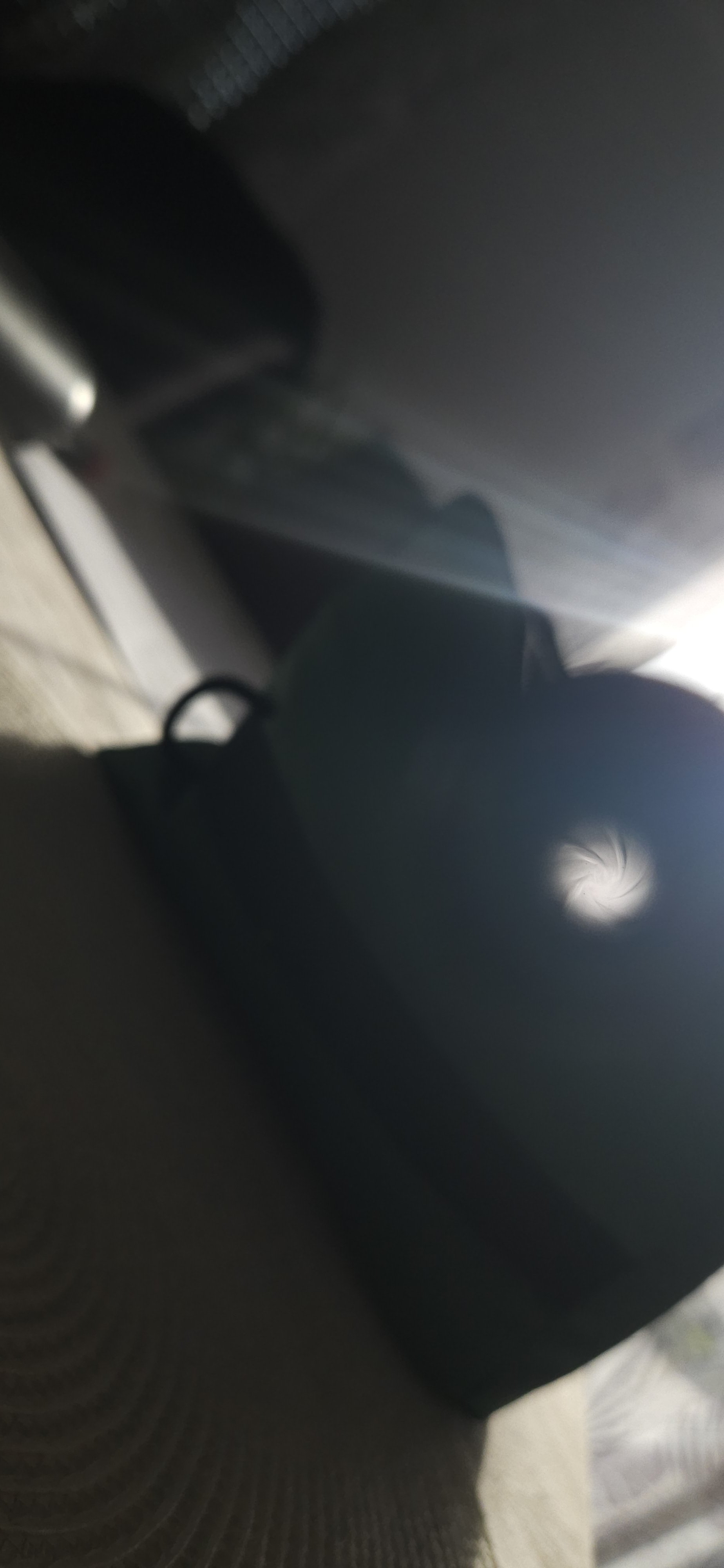

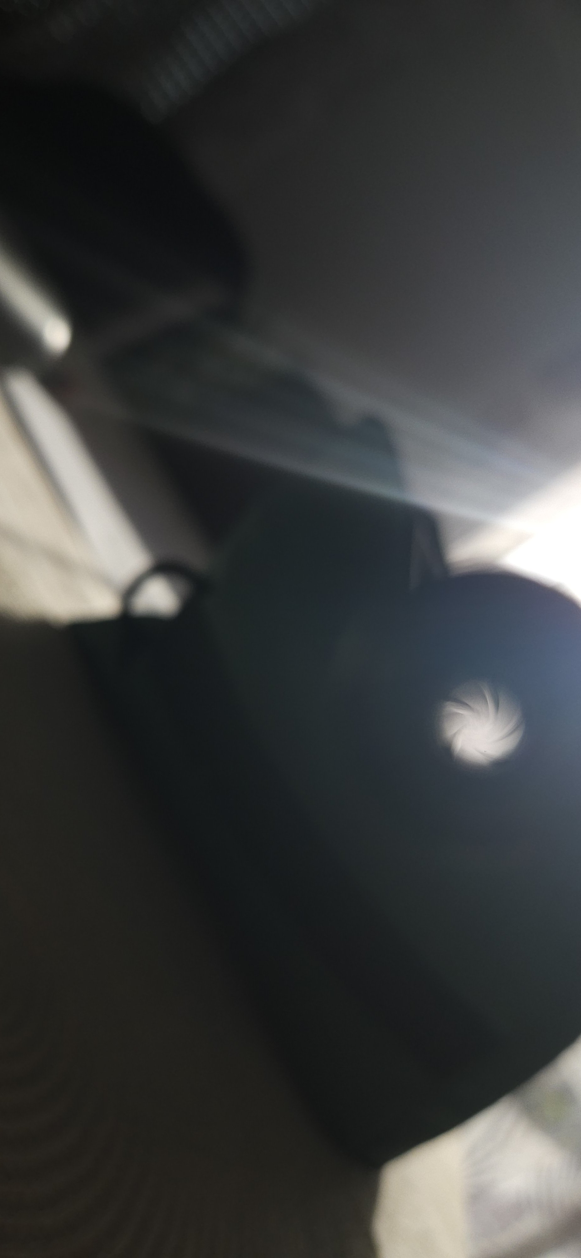

I try to make some photo of barrel inside
To check is polygonal
To me, sure looks like a typical 5 groove LW polygonal, made to Daystates/BRks specs.
There some photos floating around for a bit a while back of some Daystate/BRK "polygonal" barrels with lands that were sharp, and not as poly-like. But they also were not standard 12 groove barrels.
These photos of yours look like what I've seen as "standard" LW Daystate/BRK barrels, if there such a thing.
