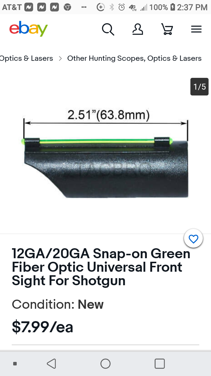

Not exactly on a P-Rod but briefly on a 1720t Which is very similar used a Williams rear sight on the dovetail and a 12 GA slip on fiber optic shotgun site with concentric shims at the front of the shroud. You can trim and epoxy if you want it permanent once sighted in. Front fiber optics come in different colors. YO!
You can even use any dovetail mounted rear sight if you want even from another gun such as a Nova Freedom. YO!

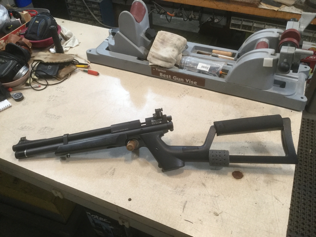

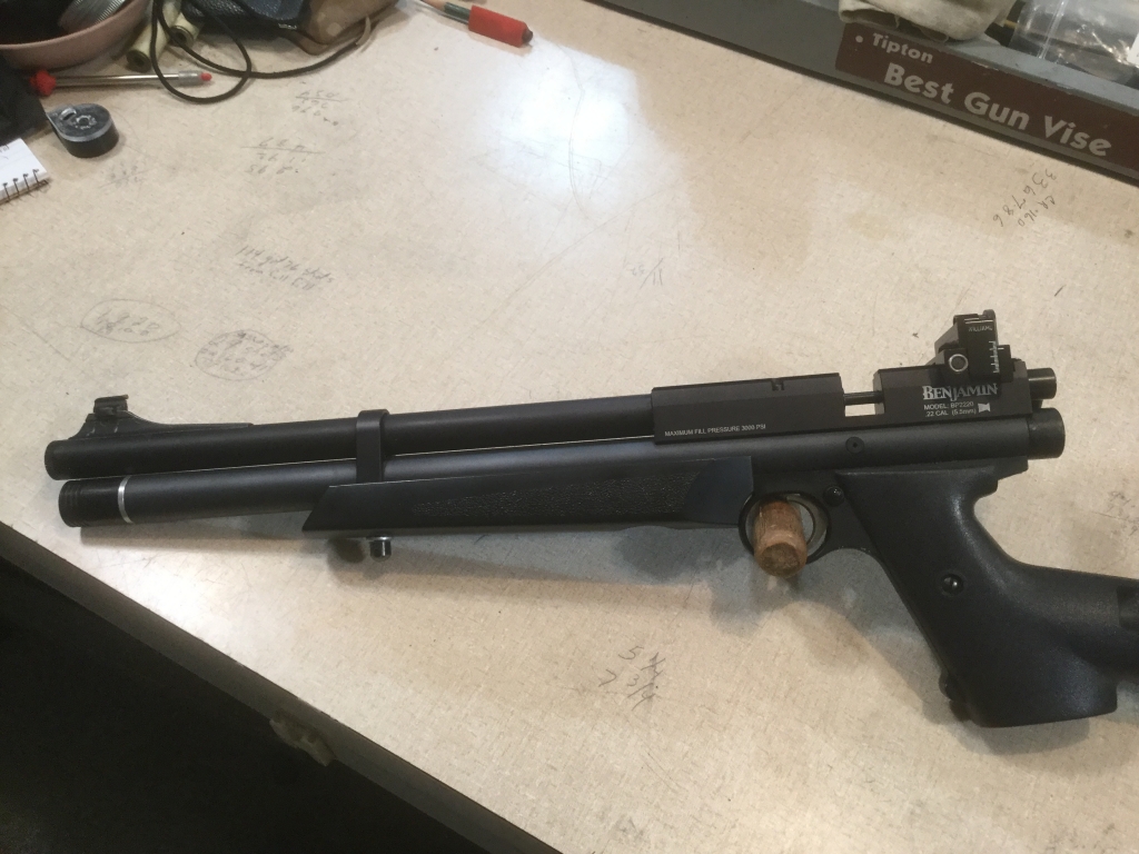

Yup sure have, this is what I used. Williams rear notched sight originally came with a new 2300s purchase, Front sight I made, turned and bored a piece of aluminum to the size I wanted. Put a shallow groove in it for the fiber optic, cut it, painted and glued the red fiber in place. Stuck it on the shroud with scotch double sided tape. The tape is real thin and does not come off easily. Rear sight is really nice, solid clicks, lots of adjustment. That one is a blade style, if I were to purchase again it wound have been a peep style. Old eyes find it easier with peep compared to blade.

I've removed scopes and red dot sights from eight guns, CO2 guns, springers and a pcp. Receiver sights on the rifles and open notch on the pistols. Rifles are Crosman 160, Benjamin Discovery, FWB 124 and 300s, BSA Mercury and now will be the P-rod. Just needed an idea or two on the P-rod as I preferred not to drill and tap the end of the shroud. Even considered the TX200, but the front of that barrel kind of has me stumped.
Actually, it's been really fun going back to open type sights even with my 80 year old eyes.

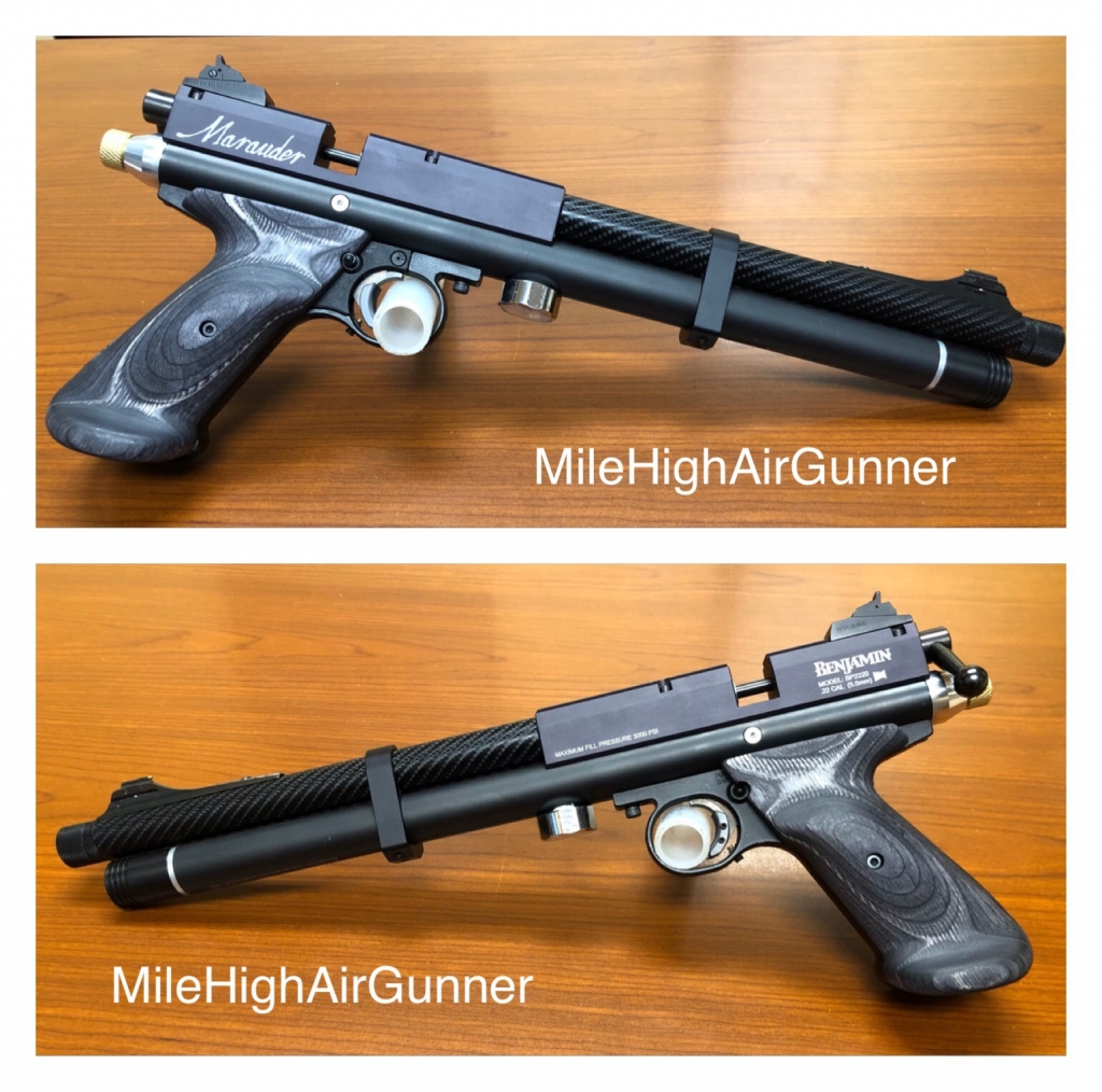

I have done the same as MileHighAirGunner on a Prod based pistol w/1701 tube. You need the high ramp to see over the mag. The base needs allot of elbow grease (filing) to fit the square edges of the breech. Front sight used screws. Also need to lock down shroud from turning on mount. I guessed wrong on ramp height and blade and ended up with just the ramp modified to also act as blade.
The shotgun snap-on sight does squeeze on the Prod shroud but is two low for mag. Even in single shot, too low for the rear sight. Should work on a steel breech with a prod diameter sized LDC.

This makes the 9th airgun I've removed optics from, red dot or scope, and am shooting with either notch opens on pistols or receiver on rifles. Even though I live in the country, our lake is full so no targets on lake bed and with other families unable to work right now, they are out here enjoying our lake houses. So, most any shooting I can do is in my shop. Open type sights just work better in the shorter distance.
The AR type stock I had on P-rod came off as the comb was too high for the receiver sight. Crosman stock works best now. Front sight is just in place temporarily with rubber cement so it can be easily removed. Contacted Rocker1 about a short extension to mount the front sight in a permanent manner and can be removed when I go back to a scope. Just need to verify his payment address to order the extension. Waiting on his response.

The front sight looks very well on the gun
Is it an off the shelf item from Williams or Marble Arms?
The rear sight looks to be a a Williams FP-GR.
Is it?
