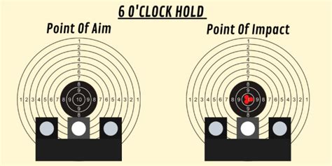

I find that a 6 o’clock works best for plinking and hunting. Maintaining visual on smaller targets lead to more hits.

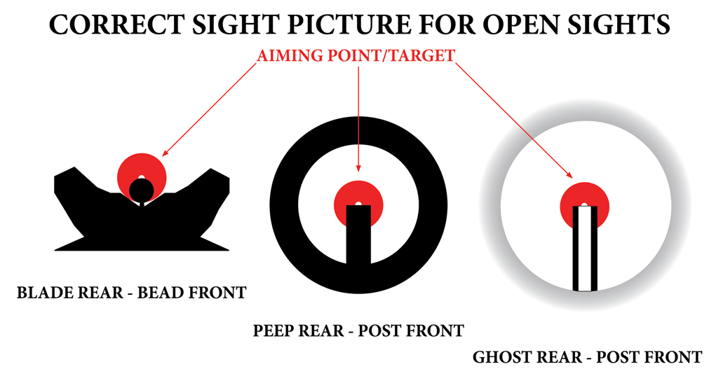

I shoot with open sights alot. Here is the sight picture I use. The key to using open sights is to focus on the front one, trust the sight picture, and like with any other sight, follow through.

For Olympic pistol and rifle, I use "sub-six" hold. For everything else, I use 6 o'clock.
Sub six was a revelation in precision shooting for me but would be unworkable for variable ranges, target to backstop contrast, and lighting.

50y R9 stock irons(lolly) cphp .177 using 6oclock hold

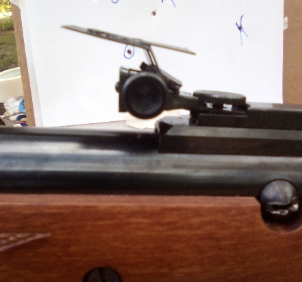

I got a thread on what's done here somewhere
2 examples of a few needed on hw sight fixes

I go with blade target contrast. With orange targets my black front post can aim at center. If the bull is black, I shoot at 6:00 because it's hard to see a black front post on black bull.
For hunting I always choose 6:00 so I have the critter in view before the shot.
