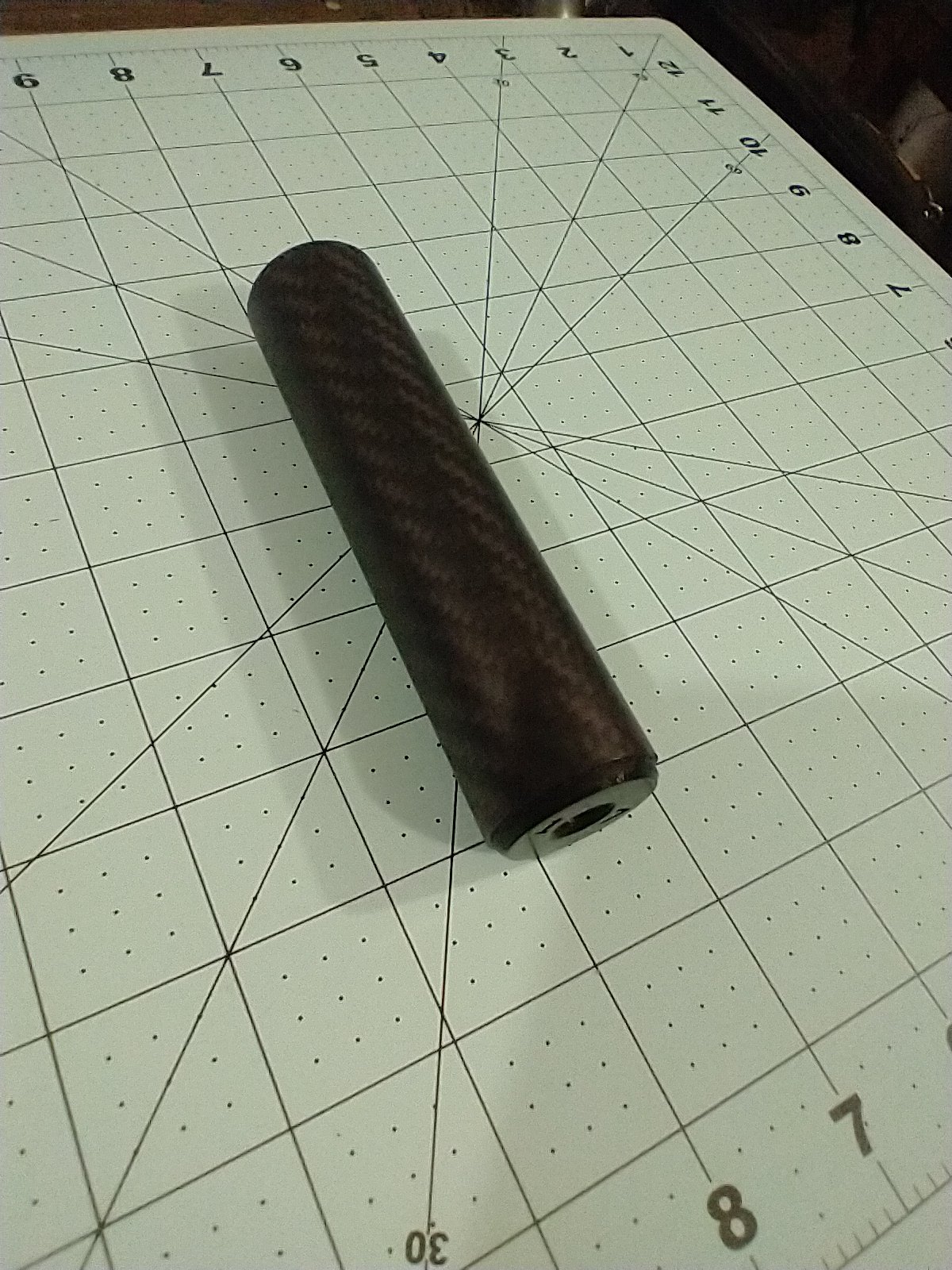

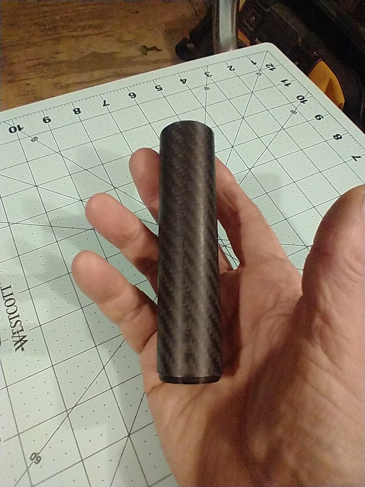

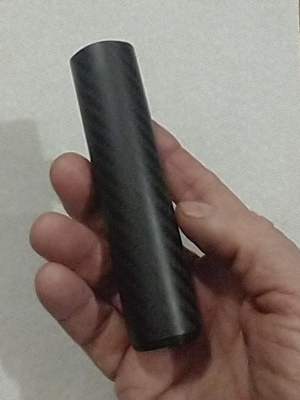

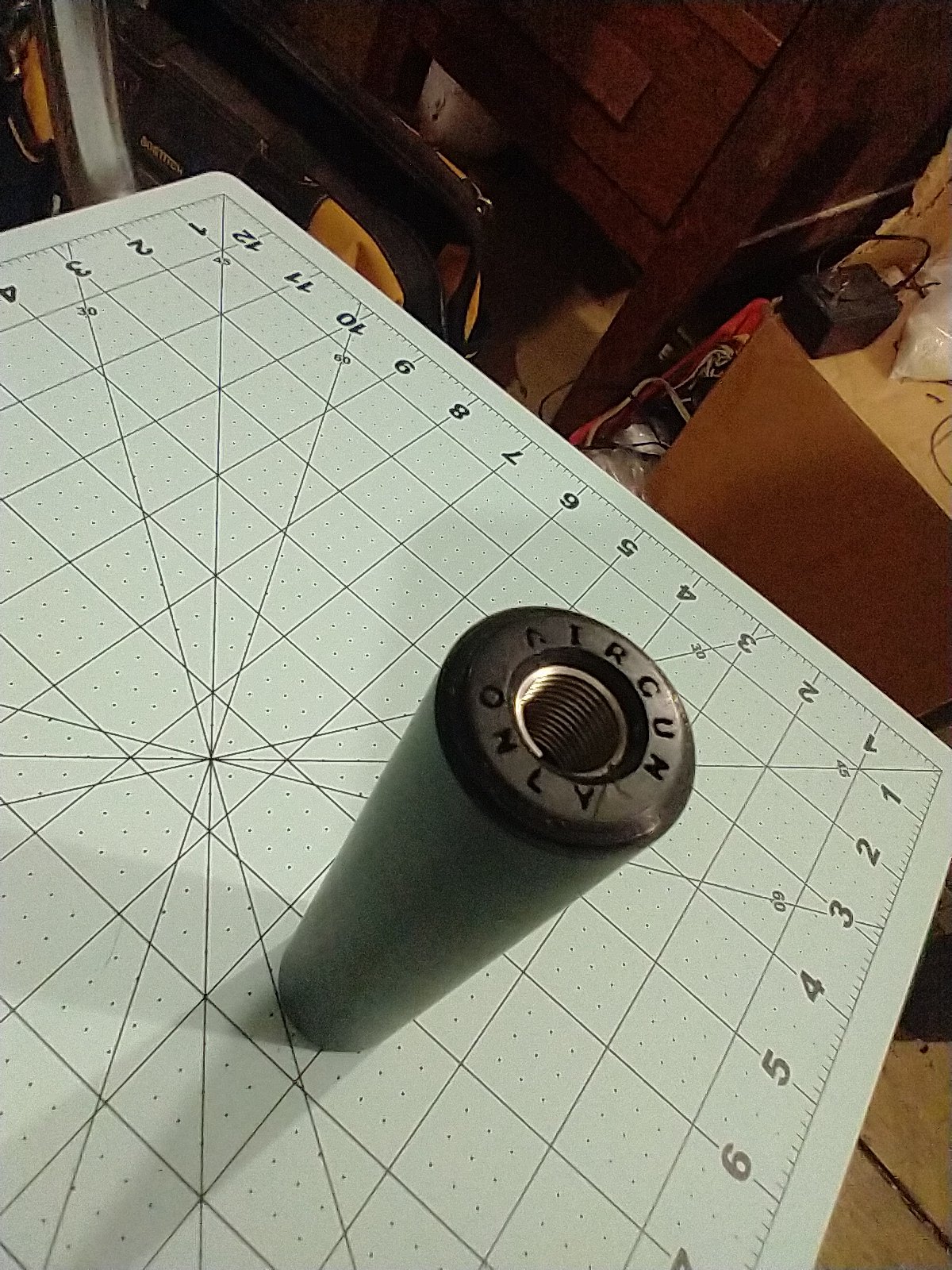

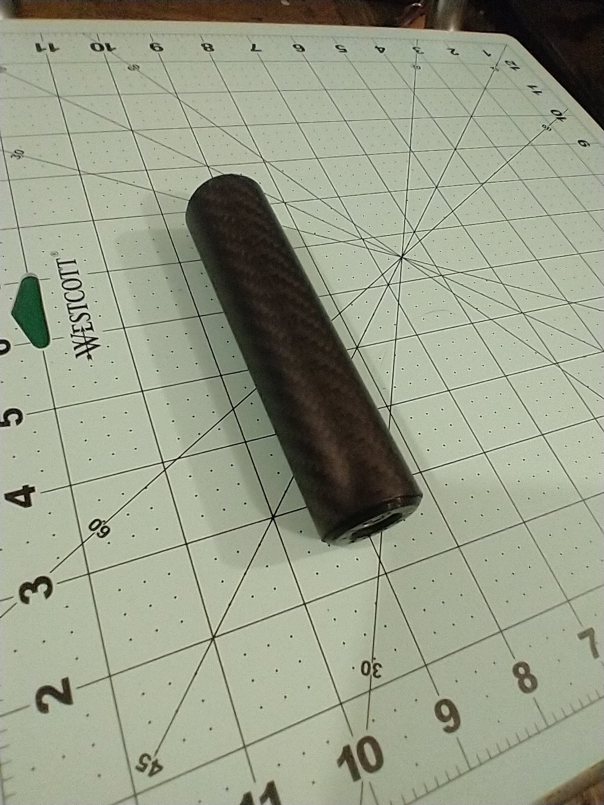

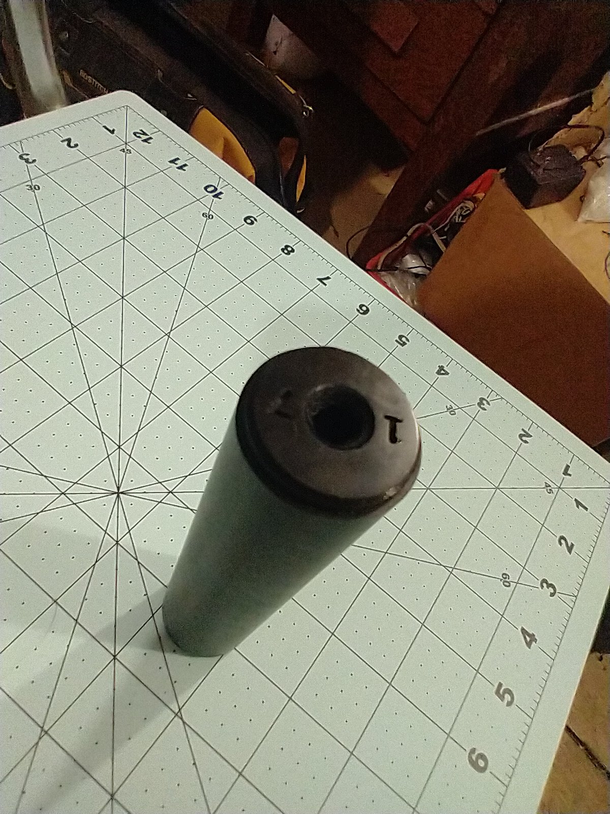

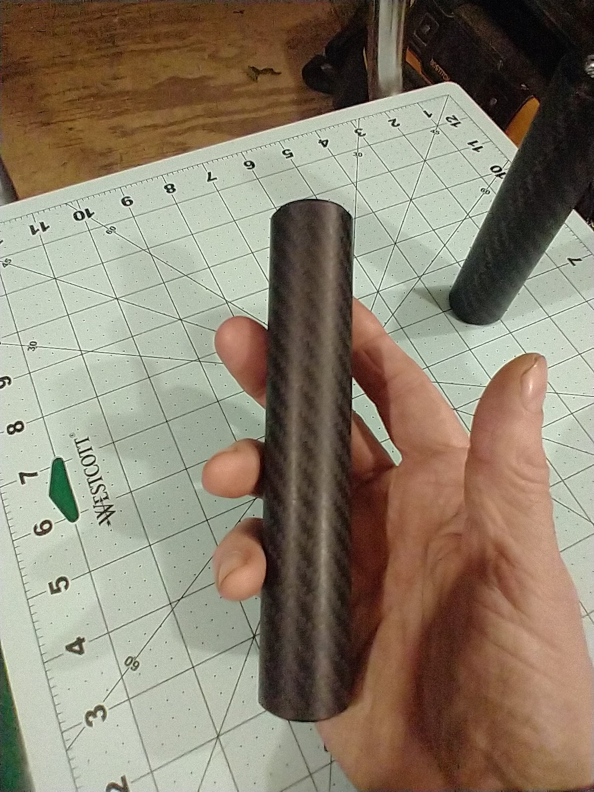

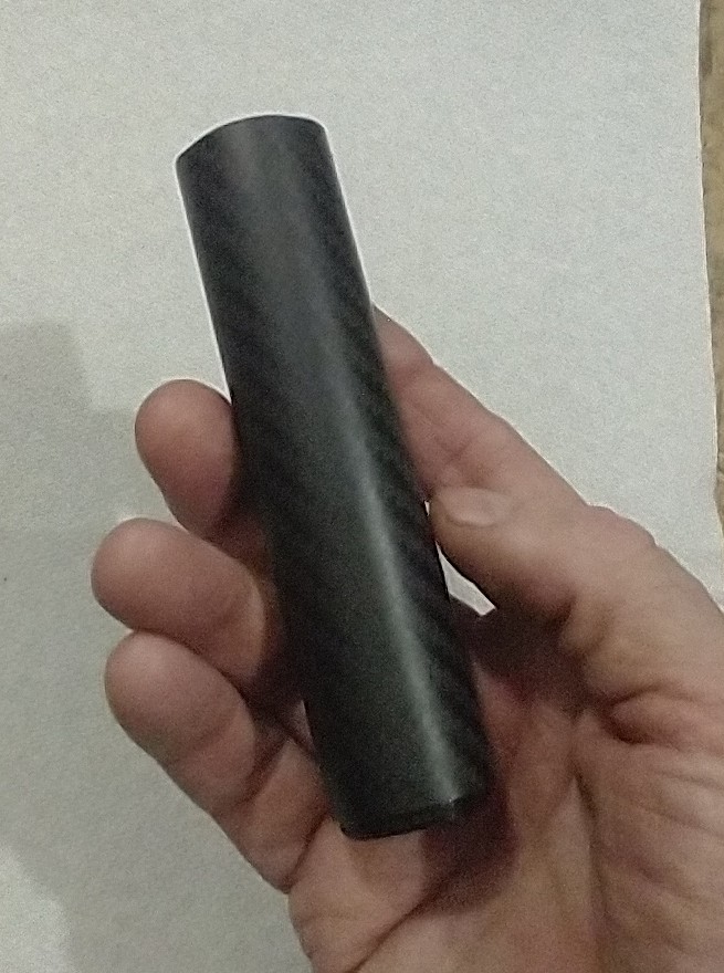

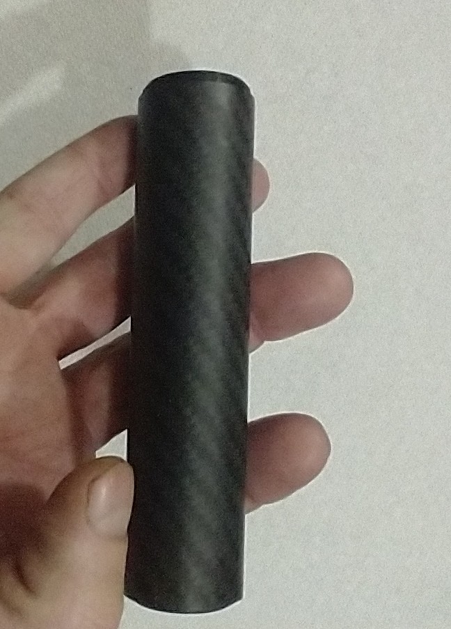

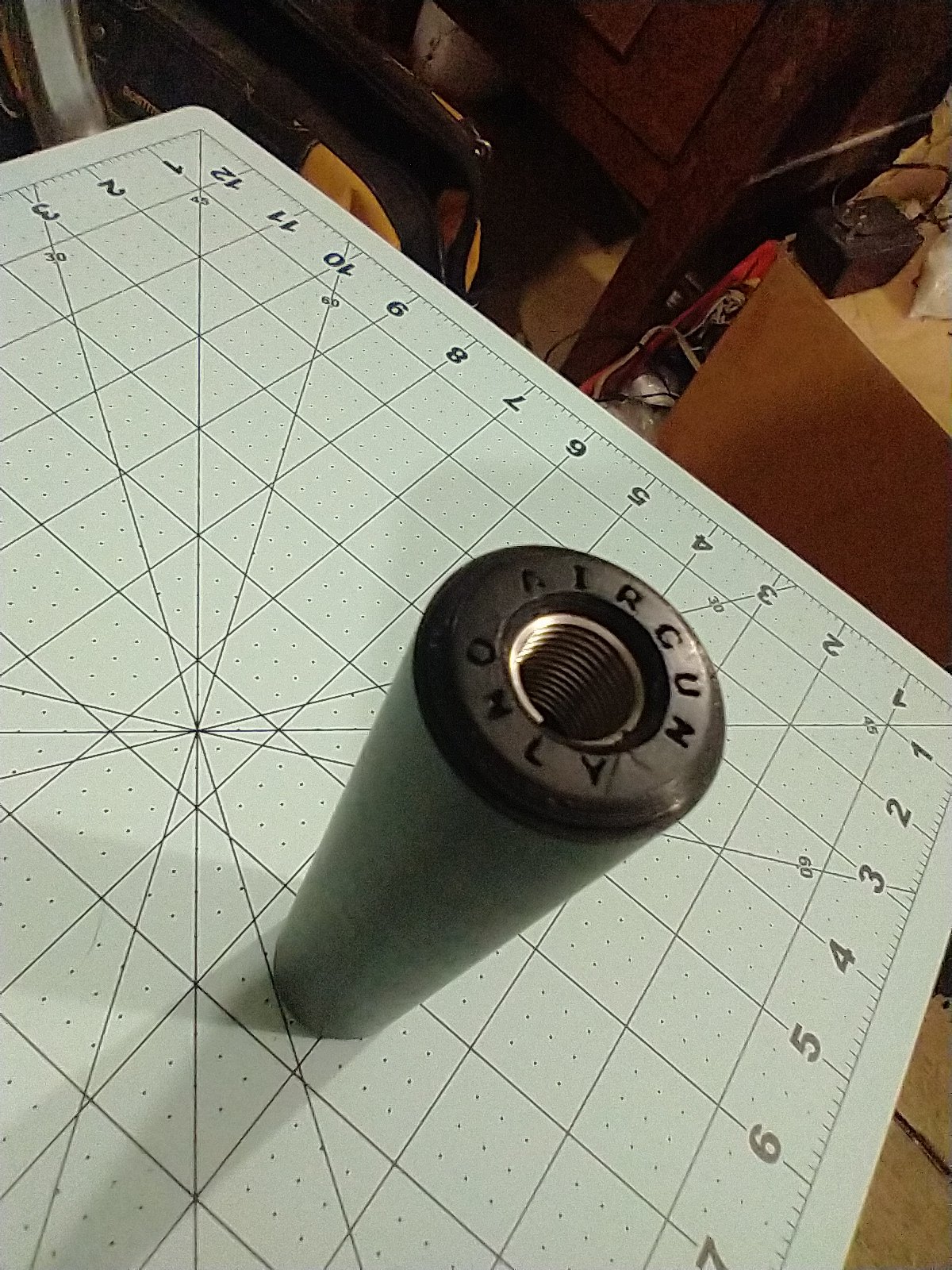

Those who frequent this section of the site are mostly aware that I've been working on design and implementation of a CF (carbon fiber) and PETG 3d printed moderator for about a year now.
The design is complete. The testers are happy. The device works and has been tested to about 80 foot pounds. It is a good moderator. It functions as a suppressor and as an air stripper and testers are reporting better accuracy with the device installed than without. It could be quieter but that would add cost and or degrade accuracy. It is a good compromise that stands on it's own beside the best names in the business.
It is available in .17, .20, .22, and .25 calibers and lengths between 110mm and 170mm. It is 30mm in diameter. The moderator features a helicoil insert in the plastic attachment. Getting that helicoil to be concentric in and parallel to the axis of the attachment and then getting attachment to do the same in the tube required the design of a number of (also printed) tools. I can now say that I can confidently build devices which do not clip when mounted on a barrel whose threading and bore are concentric and parallel even in runs as long as 170mm, possibly more. I can do that without additional machine shop tools. All the tools are also printed except the taps used and the metal parts of any jigs needed. The design and the process lend themselves to lost plastic casting. The tube could easily be replaced by a metal tube and a much more robust device then produced and costs could still be kept very, very low. That is a topic for a different forum as that product would certainly be NFA regulated. In other words the process itself is material agnostic and the device can be built with hand tools.
I have worked out the costs for all parts and materials (using FDM and plastics) and can build these moderators at costs which will allow me to sell them in quantity for prices between $45.00 and $60.00 shipped anywhere in CONUS. At that price I double my costs. That goes to labor and covers about 2 hours of labor per unit, possibly slightly less. A guy running two printers could produce enough parts for about three moderators per eight hour shift which he could also assemble. One person could easily run six printers in a production environment and produce perhaps ten units per man day.
I have no intention of doing that. I'll make a few now and then and sell them when my time permits. I have run afoul of Ebay (someone has complained (AKA shot himself in the foot)) and they have decided that airgun moderators violate their firearms policy They don't. You can find all sorts of airguns and airgun accessories including silencers and moderators with a simple search but once someone complains, good luck ever talking to a human without sending them a certified, notarized, registered letter ... in process.
Here are pictures of the final product as it stands today.

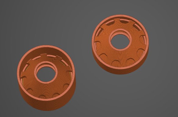

In the zip file linked in the post above you will find STL files which look like this:
This is an endcap. It inserts into the moderator tube 30mm x 28mm at the muzzle end of the moderator. There are 4 of them each is marked with a caliber.
This is an attachment cap. This part is thread specific. Each of them is marked with "AIRGUN ONLY". This part has a hollow cup at the bottom. The hollow cup is an expansion chamber that allows the escaping compressed air to expand and be distributed more evenly across the baffles. The next part inserts into that expansion chamber and functions to break up and strip off the compressed air as it exits the muzzle of the airgun. It also normalizes the air pressure across the surface of the tesla valves (baffles).
This is the buffer/stripper. This part inserts into the attachment cap and strips off the compressed air as it exits the muzzle of the rifle and normalizes that pressure across the tesla valve baffles.
These are the tesla valves (baffles) which redirect the air flow back upon itself. They consist of two cones one above the other. The compressed air builds pressure on the top cone and vents downward toward the walls of the baffle. It then passes into the chamber between the two cones and gets redirected backwards and up into the air flow venting through the pellet path. THE PELLET HAS ALREADY PASSED THAT POINT when the air begins flowing against itself.
Other types of baffles could be used to replace the valves included in these files. The critical value is the height of the wall on the valve as valves stack one upon the other. Adequate moderation is obtained with 3 to 5 valves. Good moderation is obtained with 6 or 7 valves and more than eight valves is probably overkill except in critical applications where silence is more important than moderator length.
These files are designed to be used with ANY tubing which is 28mm inside diameter. I have used PVC just to see if it would work. Works fine. You can print them and glue them inside carbon fiber using West System epoxy and you will have a moderator that should handle up to perhaps a hundred foot pounds although that would likely be pushing the edge of the envelope pretty hard. You should expect a high failure rate with that construction method above 70 foot pounds.
You could also use these files in lost plastic casting, a form of lost wax casting which uses your printed part to make a mold and then replaces the plastic with metal. The resulting parts could be made of bronze, brass, aluminum, or even zinc. You could use a brass or copper tube instead of a carbon fiber tube and cut threads into the parts. That would let you assemble an all metal moderator if such was your application. I'd recommend that for high power applications.
These parts can be scaled in your slicer ;) So you could theoretically make a moderator of any diameter and/or length. I like Prusa slicer. The taller tesla valve is nearly optimal and in performance critical applications you should scale it in in X, Y, and Z by the same percentages. That will limit the various dimensions you can achieve but not that badly. There is a readme file which explains how to calculate length given the other dimensions. You should be able to figure that out without a lot of help.
