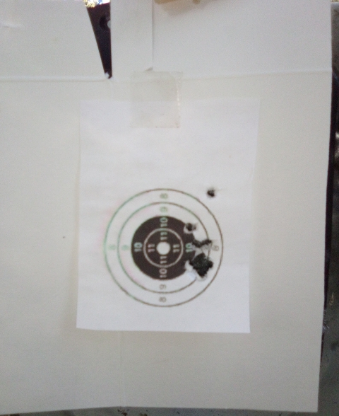

A 50 foot test of h&n vs cphp
A 50y h&n vs cphp

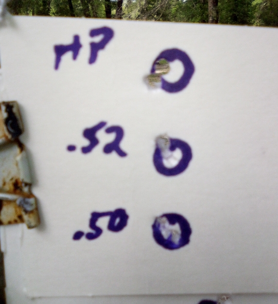

If a pellet consistently hits a 2" steel target at 50yds then I'll see how well it goes with a 1" target at 50 also.
