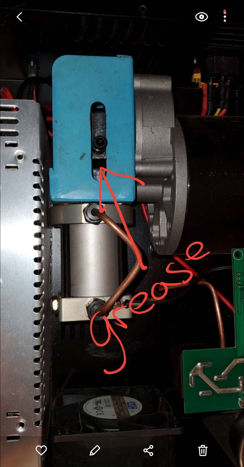

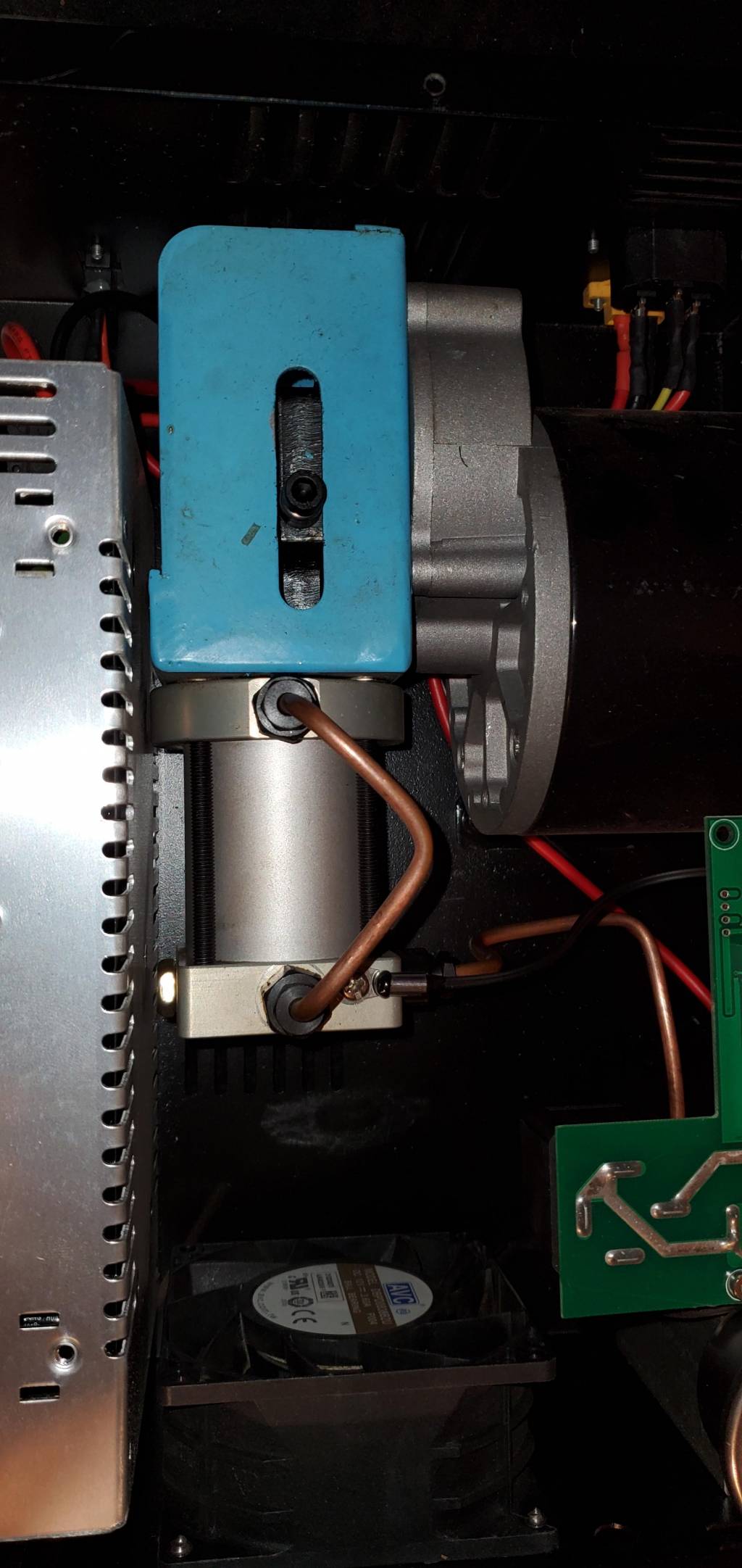

The connecting rod snapped on my GX after 6 months. I now have the Ares compressor its really quite comparied to my GX and fills faster. But no 12v :( sadly
Edit, if you grease the connecting rod every 20 fills it won't have the same outcome as mine. Picture shows where to grease with arrow.

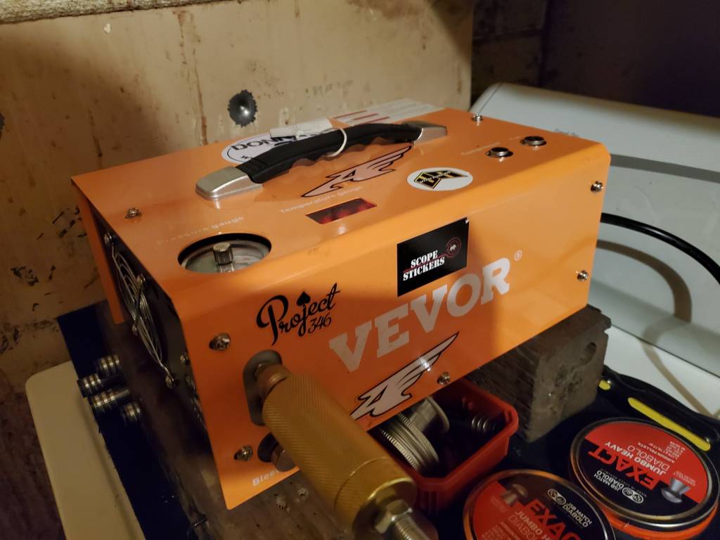

If you're just looking for a portable compressor the Vevor one I have has been going 2 years strong now running on 12v with minimal maintenance. Greasing the crankshaft & connecting rod. every 30 fills Changing to O-rings on the filter when they feel dry. Comes with all the replacement parts other than the grease. I use marine grease as the parts sweat from the heat. The fan is the loud part. But if you take the cover off and balance the fan dynamically its pretty quiet. With the fan balanced its 72 db.
https://m.vevor.com/pcp-air-compressor-c_10037/vevor-30mpa-high-pressure-air-pump-scuba-pcp-compressor-auto-stop-12v-110v-220v-p_010482656541#goodsDetail
Vevor has one year warranty but its such a hassle. They want pictures, video. Then they will make you take it apart to try and fix it with a tech through email, who can barely type in English. It will go on for weeks. Vevor is in Southern California but their customer service is in China. I'd go with Amazon if you don't have the patience.

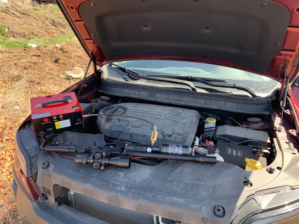

I used the GX CS1 in the field over the weekend using the car battery for power, it worked like a charm to fill the guns.
The only thing I wish the different is the compressor’s “jumper cables” were longer so they stretch from the battery ground then use a large and cheap cookie sheet as a base (metal to protect against heat build up) or a portable metal top yet sturdy table. In the future I’ll look for a table to meet the needs for the guns, compressor and general use.

My friend has the same compressor. I agree the battery cables are too short. We solved the problem by bringing a 1400 W lithium battery generator with us. Now we set everything up on the tailgate and plug it in.
I made a tool battery rig for my 12 volt needs, I get at least 4 fills from 3000 to 4500 on a pair of 9ah batteries. These are bigger fills on my Umarex Hammer and my extended tube Bulldog, about 10 minutes each fill. I also have a bunch of power tools that use the same batteries so they are multipurpose for me. And if all else fails, I can still pull out the car cables and if needed I bought a set of 15 foot 4 gauge jumper cables to get it away from the car. Everything goes into a rolling plastic tool box https://www.homedepot.com/p/RIDGID-22-in-Pro-Gear-Cart-Tool-Box-in-Black-221734/205441921
