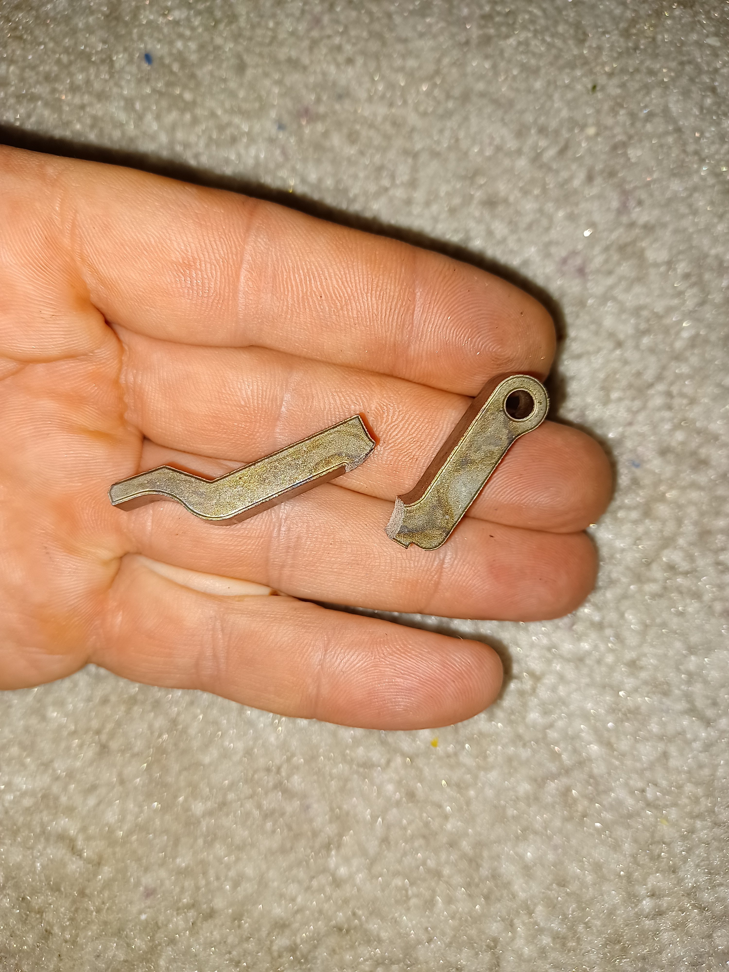

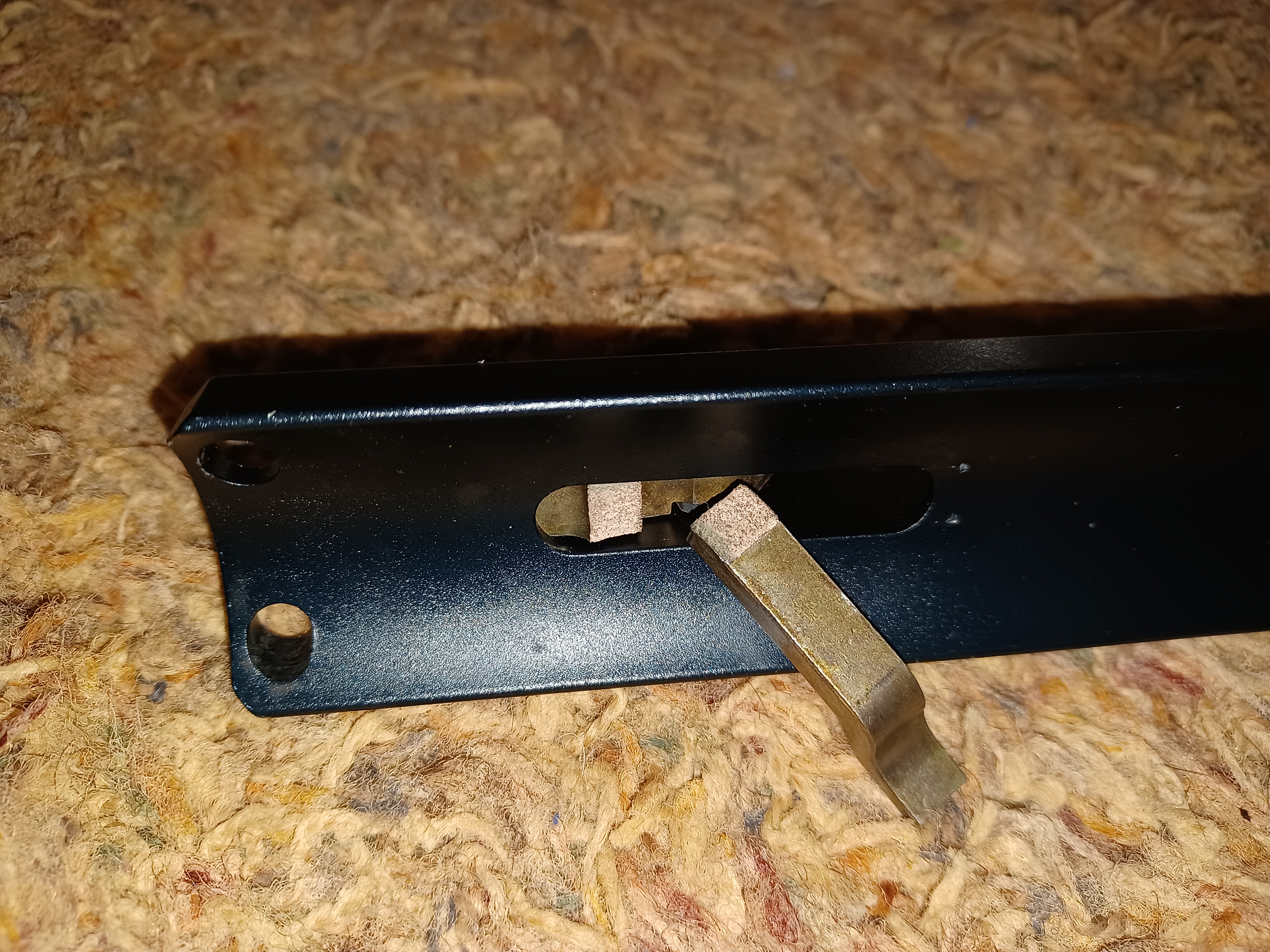

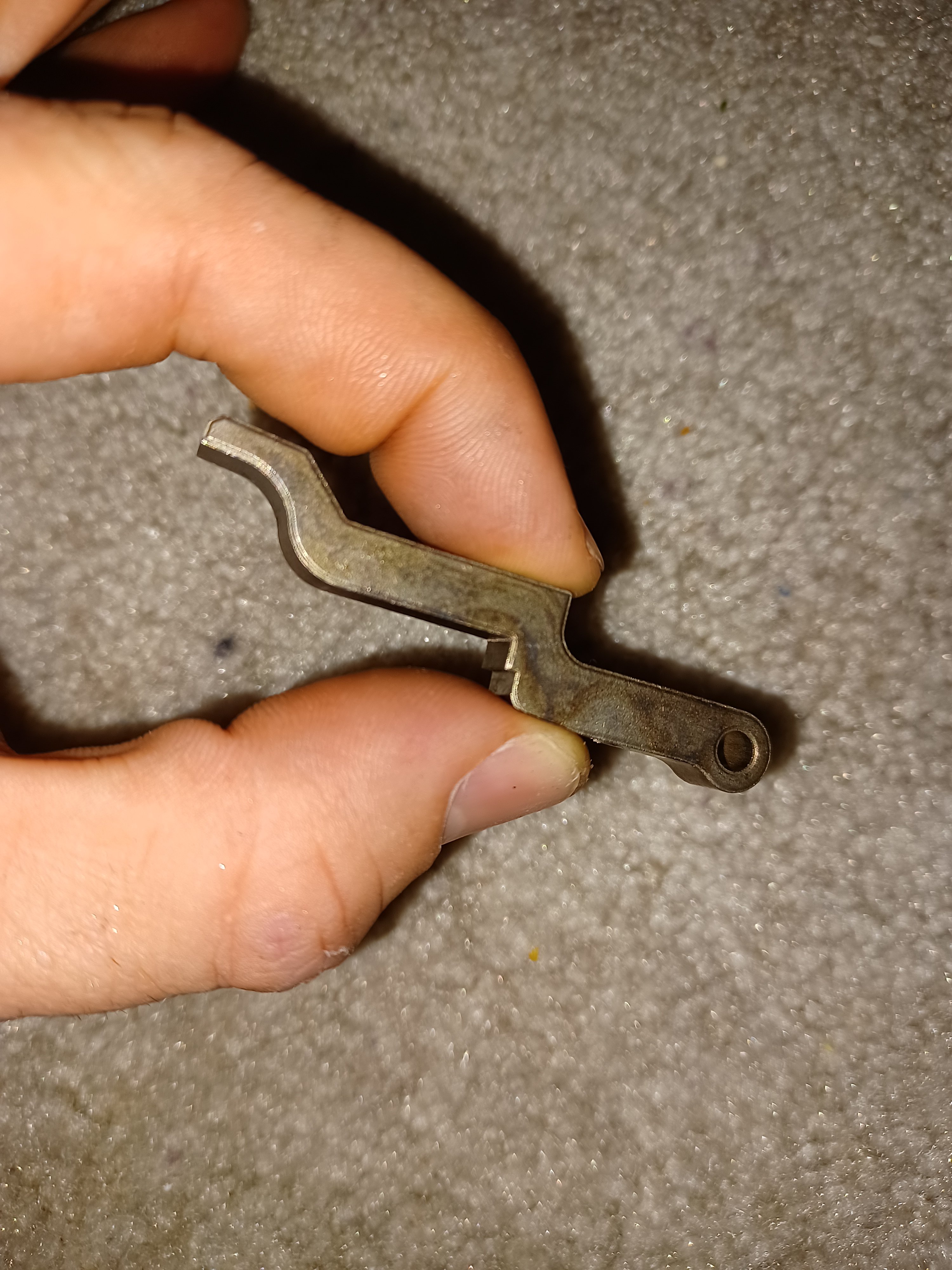

I wanna say it was around $80? If you do it, I recommend having them use hardened steel like a wrench would be made out of. Taking the rifle apart isn't too difficult. There's pins that hold the sear parts in place that are a bit of a pain to push out. Here's pics of my broken one:View attachment 508137View attachment 508138View attachment 508139
Thanks. I will dig into mine in the next few days to figure it out. Appreciate the response. Thanx again.

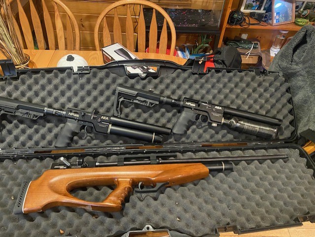

I own 3 AEA guns. An HP SS in both .25 and .30 as well as a Challenger bullpup .30 with 32 inch barrel. I also own about 15 other pcp rifles and more often than not, reach for one of my AEA's. I shoot the hell out of them, I have had 0 issues with any of them. The HP's are dead nuts at 50 yards and semi-auto. For the money, what more can I ask for!
