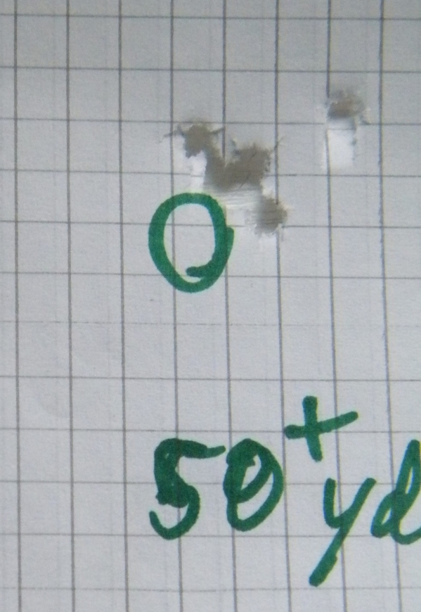

I have excellent results with power tunes and shoot .177 HW97 that makes ~17fpe. In the last match of the season I was closer to the scores of the PCP guys than the second place guy was to me in my Hunter Piston class. I believe this was due to higher winds than the rest of the year and I have much less to compensate for both wind and trajectory wise than the guys who shoot at 12-14fpe
51.5 yards outdoors, the squares are 1/4in
