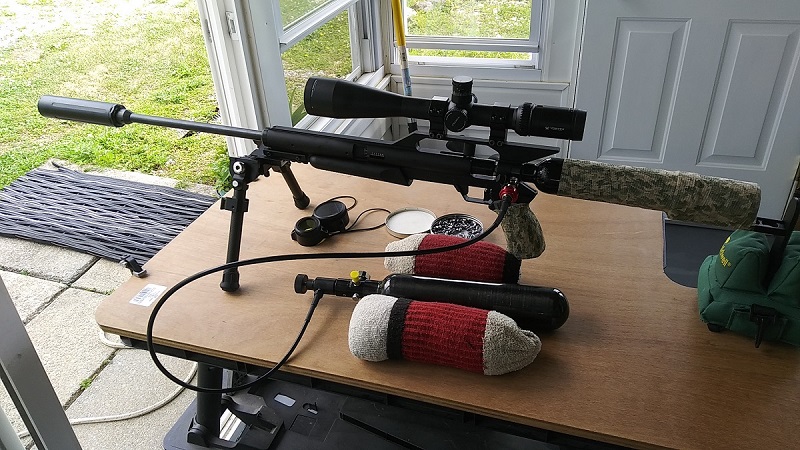

Started as a Benjamin Armada. Now a bottle gun with Cothran valve, custom breach, and 36" TJ barrel liner. It was a lengthy development project. Knowing what I know now, I would look at the Texan .257 long.

Here's my externally regulated .22 cal Escape. I'm shooting 27.5 hollow point slugs at 950 fps and with the external bottle I get 50+ shots per fill. I'd like to build something similar in .257.

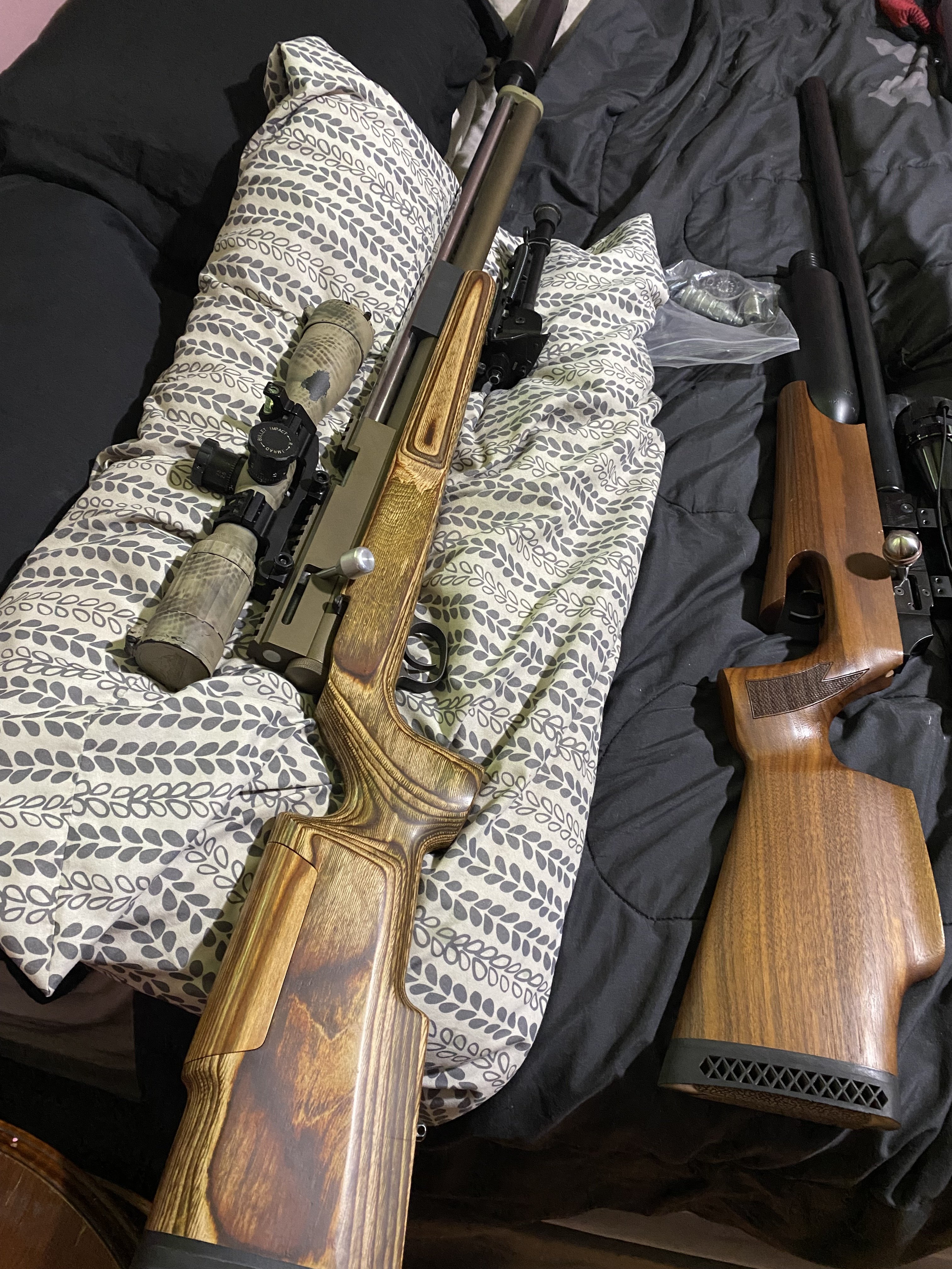

This 1-14 Lilja barreled .257 Scandalous & I have held a consistent sub 2" group at 400 yards when tethered to a step down in-line reg. It is a true hole on top of hole 1/8' 100 yard shooter. I was shooting it at 3600psi but it does fine from 2800-3200psi also. At 3000psi it's sending a 72 grain .2573" Griffin at 1080fps.
I plan on taking it out tomorrow, probably with a 4.5-27 Athlon Midas on it, as I haven't shot it since having Precision Rifle Works thread the barrel & 3D print a spacer. It did not need a spacer as it came perfectly from John Bowman; but that heavy Emperor .357 LDC had me thinking I was definitely going to need it. I'll post results at some point.
How'd your outing go James?
Tell ya the truth it was disappointing, only because current fill apparatus will not allow me to shoot it simultaneously w/LDC & step down in-line reg. Maybe there's a shorter 45* QD FF that would allow clearance. This was the first time I had fired it with the .357 Emperor on it. Wish I could shoot it like that while tethered but no can do for groups. On a 3600psi fill it'll yield 3 shots that are predictable enough for varmint hunting of reasonable ranges. Thankfully there's no mentionable POI change with that monster can on/off. I highly doubt I'm going to buy a good thermal & hunt coyotes, but it's capable. I honestly wouldn't want to carry it.
I was laying prone and shooting at a 0* angle target 105yrds out. I wasn't as early as I liked and the wind had picked up let alone the mirage was pretty dam bad at ground level. I tried a Athlon Midas but I don't like the reticle. Went back to the SWFA 16X. Groups were good when I did good. I got 3 inside of 1" 3 times but that was out of like 60 shots.
Edit: I should say I started around 3200psi, dialing it in I saw as hot as 980fps but I settled at 3K and 944fps. I recently sold a compressor and probably plan on selling this because optimum speed is currently configured for a 3600psi fill, yielding 1080fps w/a 72 grain .2573" Griffing RBT. I could easily buy another big compressor (or see if a Hill pump cause a heart attack lol) but since I moved I just don't care to drag everything out. I use to be able to shoot 300-400 yards off my front porch. Believe me the Scandalous can shoot. IDK, maybe I will buy a Edgun or FX and just hand pump it once a week, turn it down to 12ft/lbs, get 300 shots.
It was just pretty windy, I should have a better scope & I am still not sure if all the others that I don't think I pulled were due to mirage, or more wind. So nothing great to show but thanks for asking.

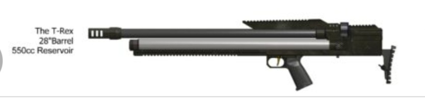

I know is not going to happen..but if someone makes something like this in 224 or 257 ..I'm in who ever the manufacturer is ... or now that I see is plausible I go the bulldog route in both calibers.. in 224 .50g in 257 ..75g .in this configuration the AAA with 32 in barrel and a longer air tube ..would be a killer gun ....the bulldog could use a 33 inch barrel n not be longer than the actual gun that has 29" + some shroud space.
