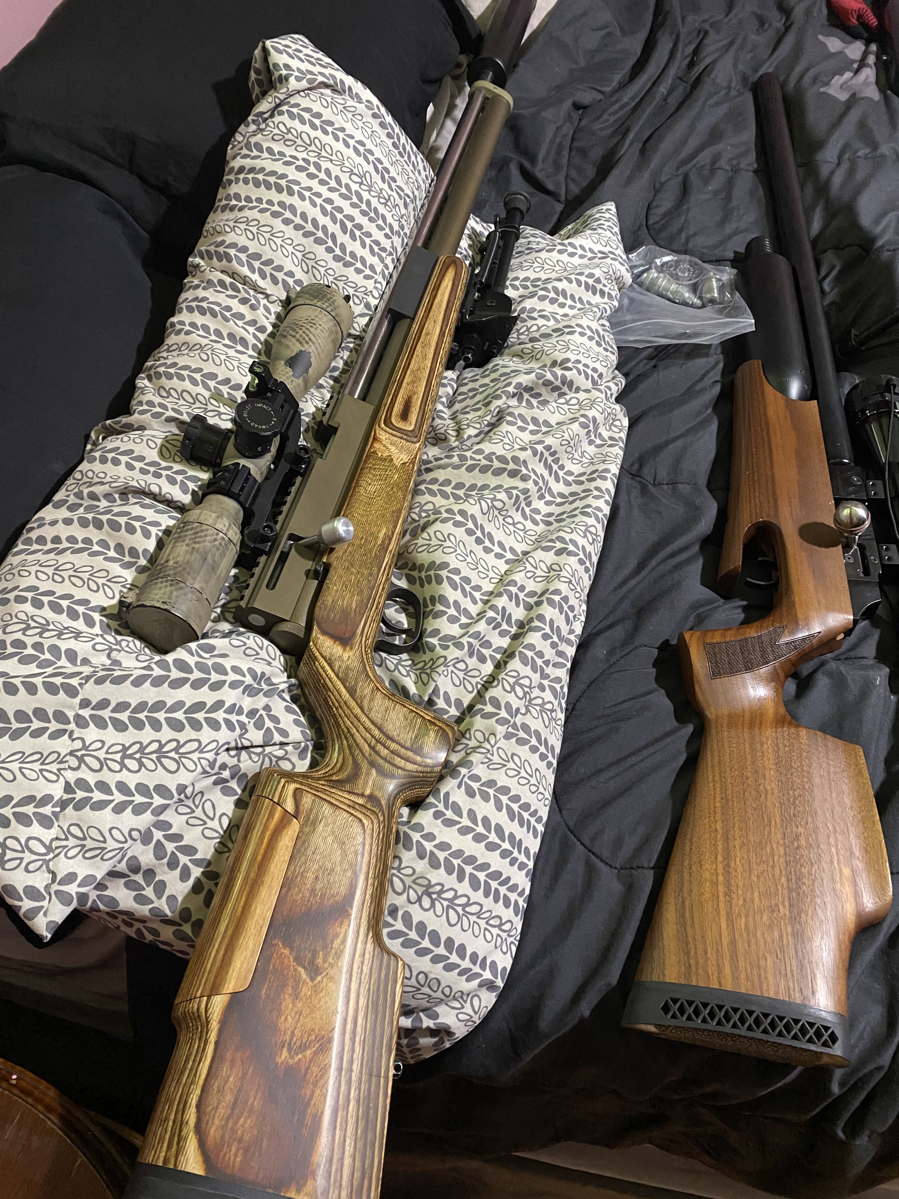

Tell ya the truth it was disappointing, only because current fill apparatus will not allow me to shoot it simultaneously w/LDC & step down in-line reg. Maybe there's a shorter 45* QD FF that would allow clearance. This was the first time I had fired it with the .357 Emperor on it. Wish I could shoot it like that while tethered but no can do for groups. On a 3600psi fill it'll yield 3 shots that are predictable enough for varmint hunting of reasonable ranges. Thankfully there's no mentionable POI change with that monster can on/off. I highly doubt I'm going to buy a good thermal & hunt coyotes, but it's capable. I honestly wouldn't want to carry it.
I was laying prone and shooting at a 0* angle target 105yrds out. I wasn't as early as I liked and the wind had picked up let alone the mirage was pretty dam bad at ground level. I tried a Athlon Midas but I don't like the reticle. Went back to the SWFA 16X. Groups were good when I did good. I got 3 inside of 1" 3 times but that was out of like 60 shots.
Edit: I should say I started around 3200psi, dialing it in I saw as hot as 980fps but I settled at 3K and 944fps. I recently sold a compressor and probably plan on selling this because optimum speed is currently configured for a 3600psi fill, yielding 1080fps w/a 72 grain .2573" Griffing RBT. I could easily buy another big compressor (or see if a Hill pump cause a heart attack lol) but since I moved I just don't care to drag everything out. I use to be able to shoot 300-400 yards off my front porch. Believe me the Scandalous can shoot. IDK, maybe I will buy a Edgun or FX and just hand pump it once a week, turn it down to 12ft/lbs, get 300 shots.
It was just pretty windy, I should have a better scope & I am still not sure if all the others that I don't think I pulled were due to mirage, or more wind. So nothing great to show but thanks for askinView attachment 284530
