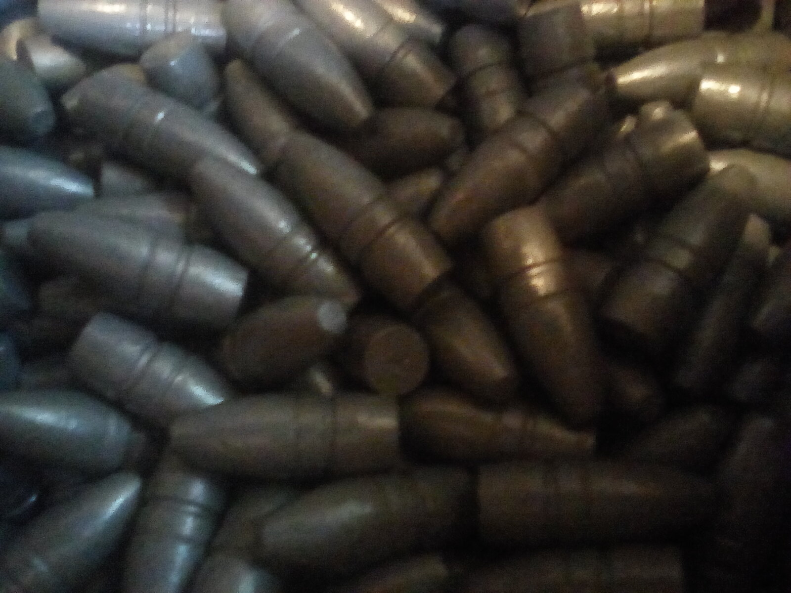

I don't understand why swage airgun slugs don't have high b.C designs... To make normal vld slugs they use a solid swage lead core and pull.the jacket over...Point being you have to be able to swage a true VLD design with high BC...I understand cast slugs not the best,,but why cast designs have higher BC designs than airgun swage slugs.. Lee 230 grain .309 mold is the highest BC lead slug that can be used in a airgun... Its BC is over .6 something..

So far, I prefer casting my own as there are better mold options available when looking for the optimal shape.
the main reason why a jacketed brass bullet is not used is that the airgun probably wouldn't be able to fire it and if it did, the drop in velocity would be very high. Not to mention the airgun, where the slug is inserted directly into the grooves of the barrel, it would not fit there at all
no i understand that you can not use copper jacket.. My point being we should have the tech to be able to swage lead in the same designs as are powder burners. Probably more steps to do i would imagine..Your lathe turned .223 67 grain slugs are nice:)..I want try some in my new old tech Airforce Condor builds
The tech is there no doubt... if a pellet can be swaged then so can a BT HP with any other feature imagineable. Certainly a more complicated machine when compared to the ones used for the flat base slugs available everywhere.
Probably just a demand thing too... most off the shelf PCPs can't handle the weight that comes with the vld shape... no one likes shooting at 700fps. Except springer guys. 😝
