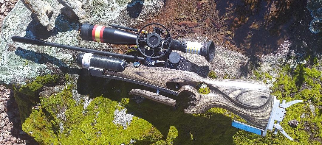

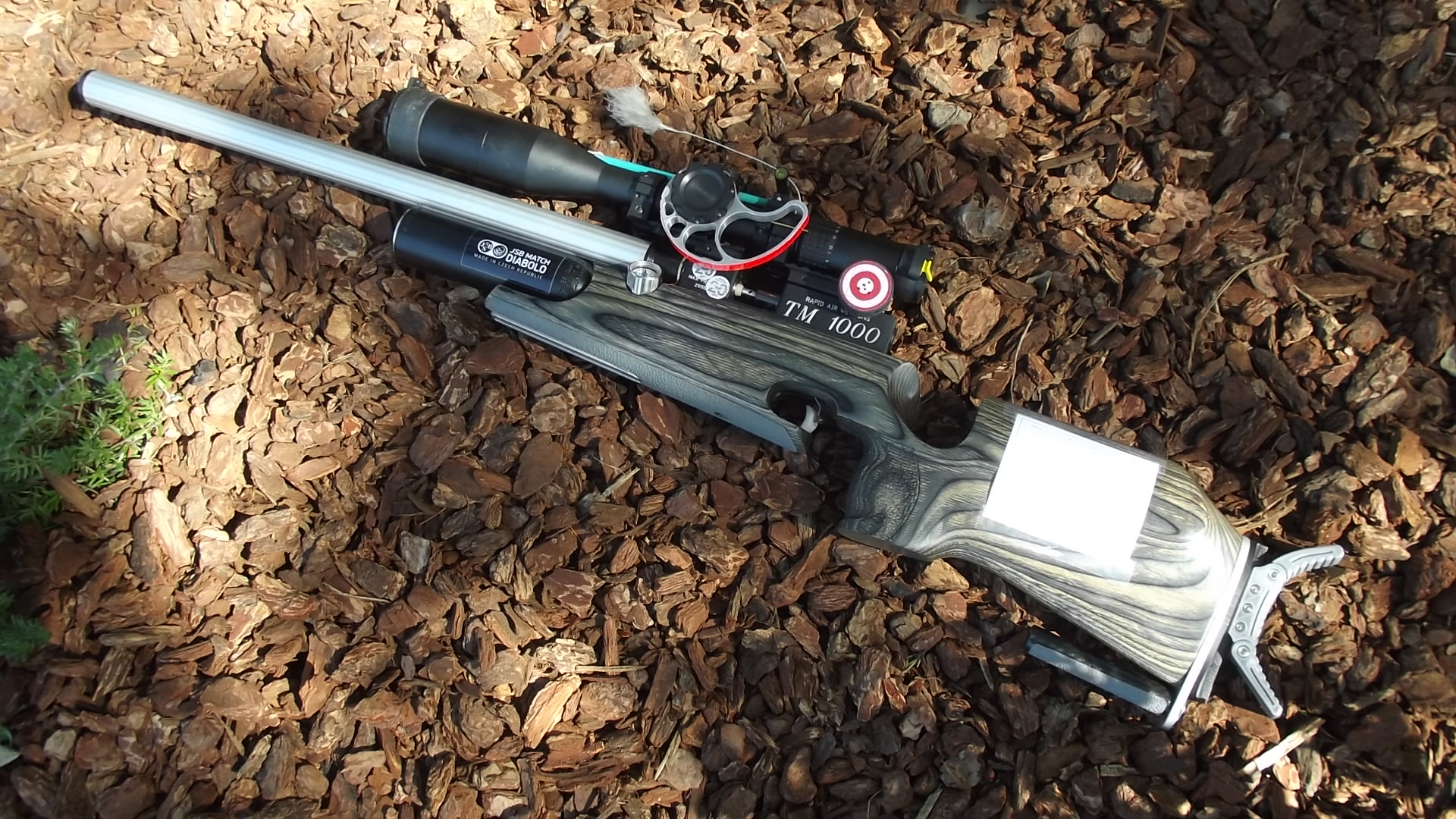

Currently run a 350cc carbon on my RAW, previous for many years a 200cc off a BSA R10 was fitted. BOTH weigh about the same.
Reactions: cavedweller
CALM nerves, controlled breathing, steady miens of support RULES THE DAY in field Target.
Many years back my son, who was 15 at the time was shooting a custom HW77 in an Anderson custom stock that won the very first ever Canadian National Field Target match!! That springer weighed 17 lbs total. Does this mean the heavier rifle will be the winner ?? What can you handle ?
Youth has much of the required on there side .. minus experience in most cases ;)
Weight for some, Less weight for others .... High scope for some, Low scope for others .... Sitting on the Ground, on a Bag, On a stool or Bucket ... shooting a Springer or PCP are all choices we make for choosing a FT class. All the above choices still need to get figured out in being able to be steady and hold a solid POA each and every shot no matter the flatness of the ground, angle of the shot or winds present. Only when you do all those things better than the others do you have a chance to be a champion in a major competition. Yea bit of luck helps too :unsure:
Fact is...weight will steady motion....once the weight has become steady, it is more likely to stay that way. Light weight takes less force to make it move, so it becomes more difficult to hold steady. Once the muscles begin to fatigue, everything moves, so....if you can handle the extra weight, it will become your friend in a rifle.
