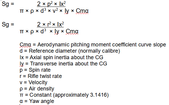

The normal equations for stability factor are:-
The second equation, which is normally in radians per meter, is applicable only at the muzzle, which is usually the point of minimum SG. Further down range, SG becomes a function of spin rate divided by velocity (both squared). All the other terms, except Cma, remain constant for an airgun pellet trajectory.
