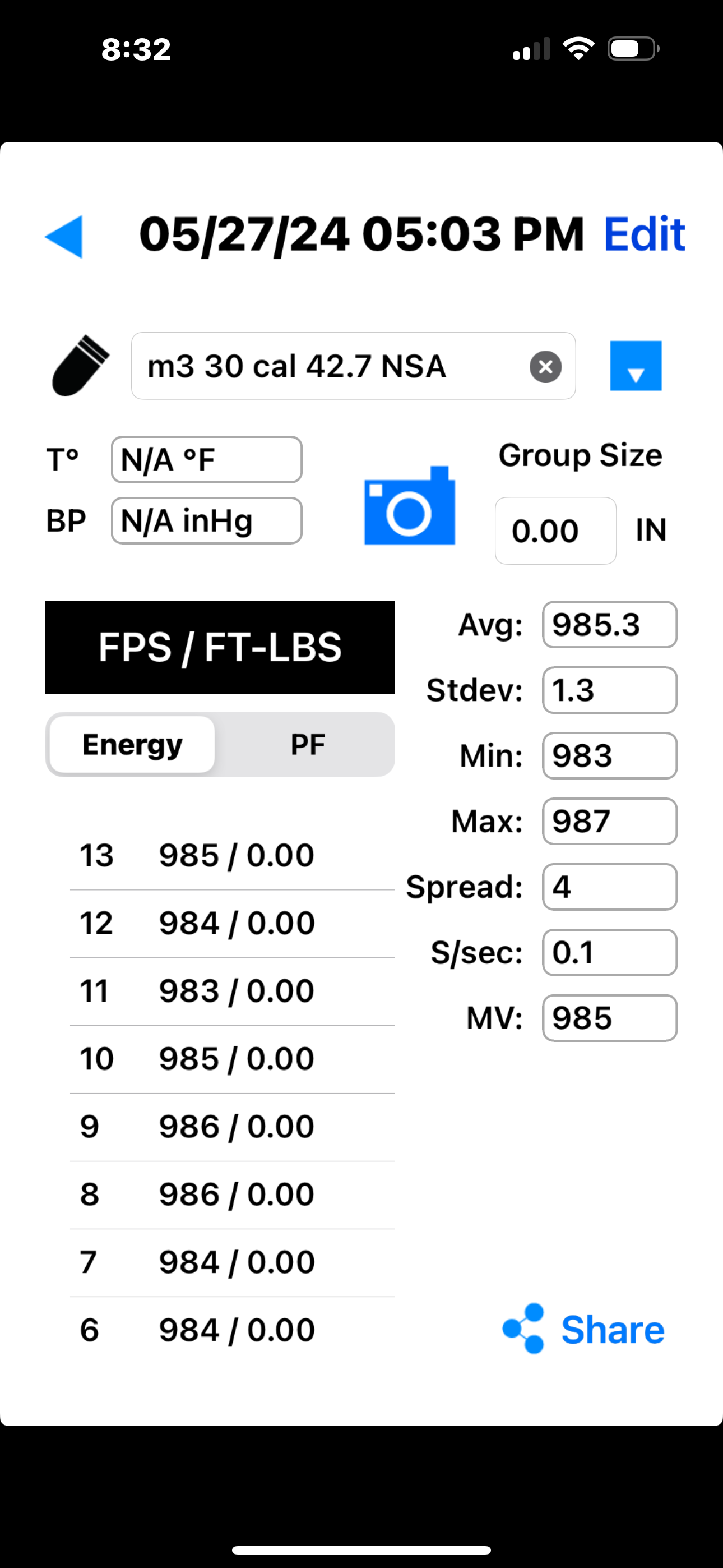

Fx m3. Shooting slugs. And very accurate
