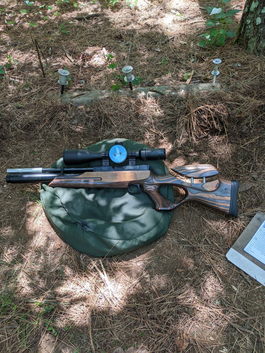

The scope I got back is excellent. The glass is wonderful, it seems to track well, and the eye relief doesn't get touchy anywhere within the mag range. I use it for HFT and it ranges excellent at 16X. However, the numbers bunch up really tight on the sidewheel after 25 yards. A big sidewheel is a must, and maybe still not good enough for seasoned FT guys (I am not) but Optisan doesn't offer one anymore. And the knob is tapered, so a simple sidewheel with a hole won't work.
But I was able to lift the logo off the knob, and remove the knob with a single screw. Drill and tap two holes through the knob, and mount a flat sidewheel. Problem solved.
