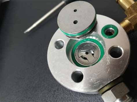

Hey Guys,
What is the orientation of the 2 metal flapper valves located in the head of the yong heng compressor? Need some help here, forgot to take pictures of it.
Well when he holds it up at the window and see through it i only see the one.

They are two, believe me. It's on the other side of the location of the one he showed. Next time I have it apart I'll post a picture of it.

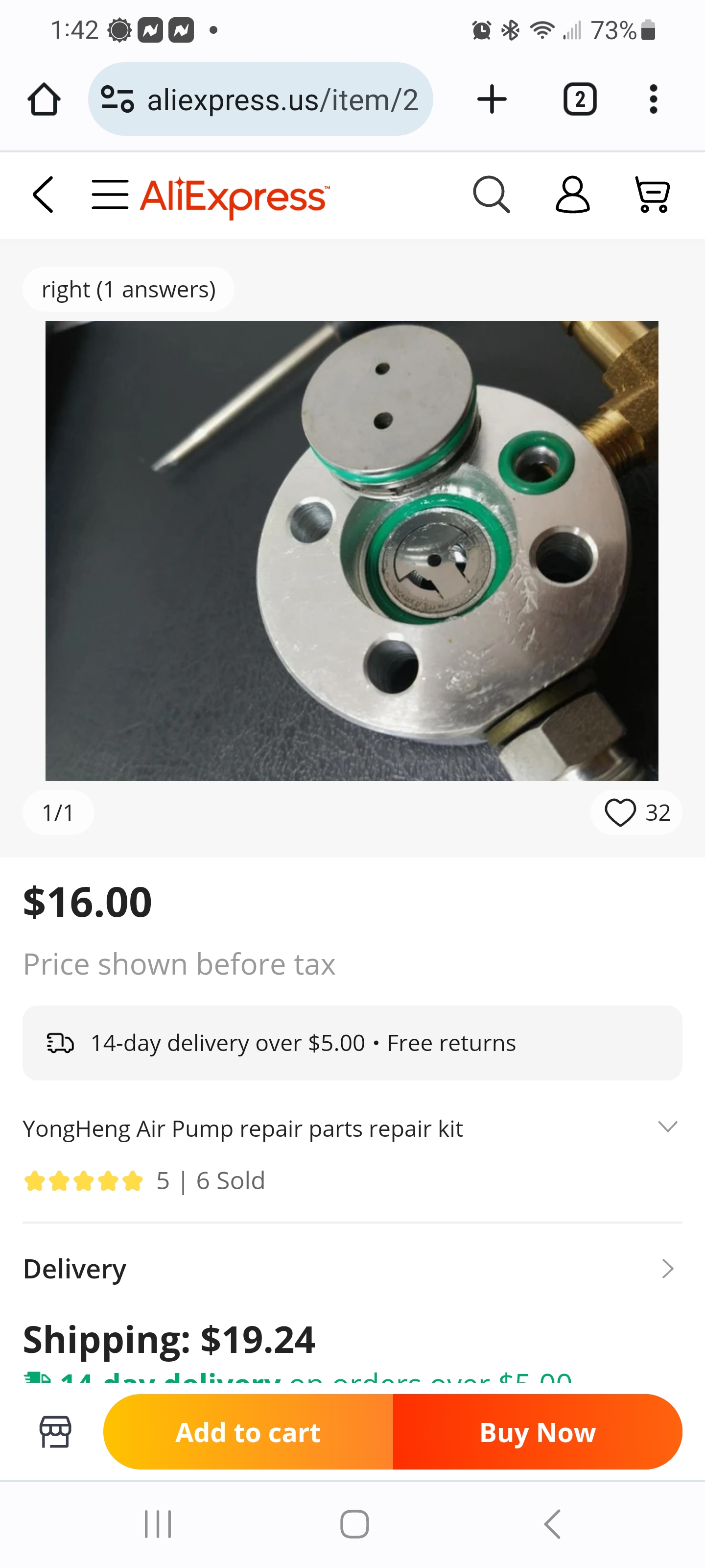

I assume your talking about this one under that cap with the 2 holes?

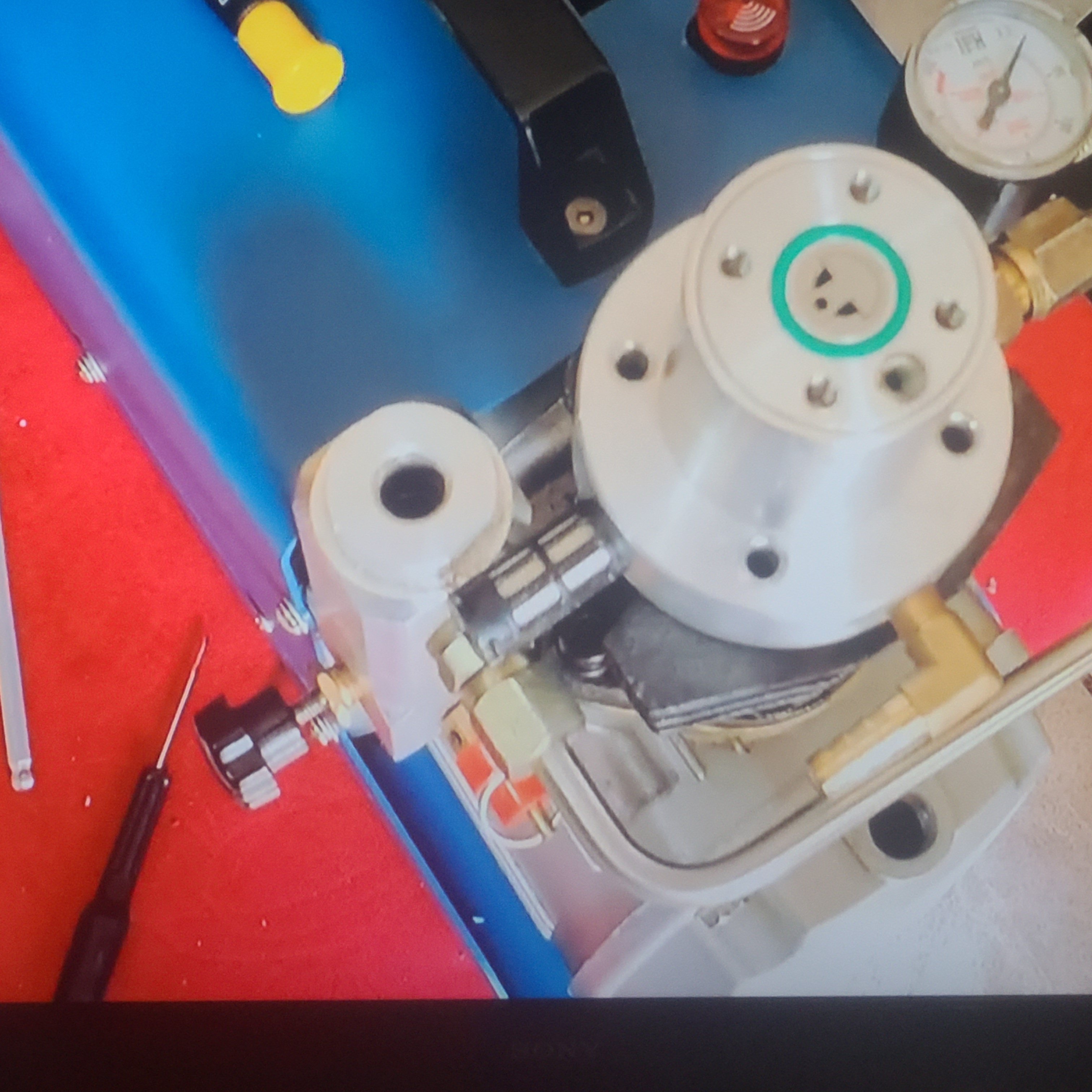

Now watching a vid a guy showed the one from your picture and took his finger and spun it around freely . Did not seemed concerned about position of it .
The one i pictured ??? I guess position it likewise with the "stem" part facing that silver fitting ..

If you look down the hole in the top of the second stage, where the air tube fastens, you can see the second reed valve that is hidden under the round disk, seen by looking through as he did.
