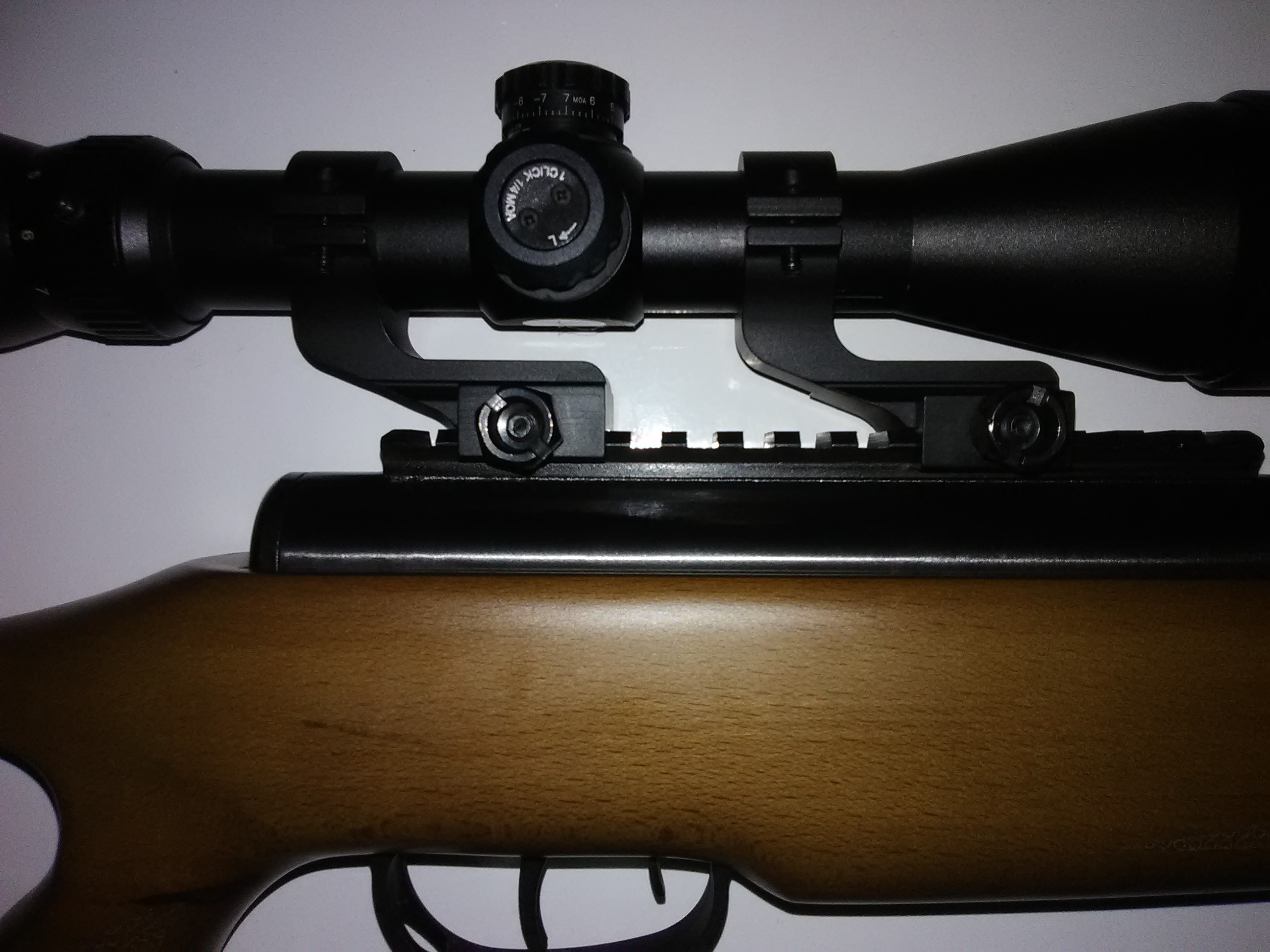

Decent price, they go for lots more new. Bought same, in XL, from neighbor, few years back, he didn't like it. The XL nitro piston is 27mm, non-XL is 25mm, non-XL is better choice. Mine came from factory with Crosman's brand scope. CenterPoint, 3-9x40AO. Think first three digits of serial number is manufacture date, mine, 718, makes sense for July 2018. Had to use cantilever scope mount (picture) since didn't want to trim stock for proper scope eye relief. Terrible triggers but easy modifications can be found on YouTube, sounds like yours has already been done. Hope you continue to enjoy, feel free to ask questions. WM
