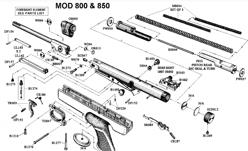

Hiya,just done the seals on a original mod10 pistol, a lot of the trigger was already removed when i got the pistol,haxe instructions for a mod5 thinking they would be the same completely different, so has anybody got some pictures or info on the assembly of the mod 10 trigger as I am struggling, cheers John
I believe the Model 6 is the same AKA Beeman 800/850 as the Model 10.
https://www.gunspares.co.uk/products/24758/MOD-800850/#parts
