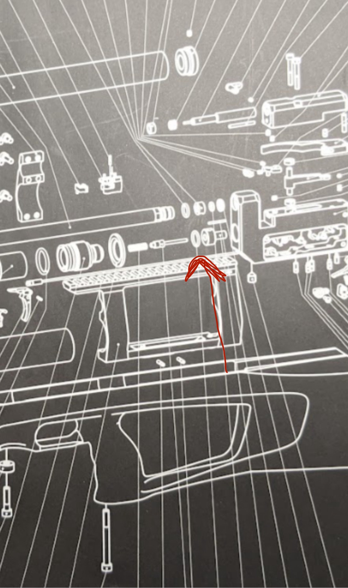

Ok vet folks, I discovered my original vet long has developed a slow leak after 5 years use, how dare it! LOL! I changed the o ring at the back of the air tube between the PP and the block. This gun does not have many o rings and it leaks about 40 bar of pressure overnight, say 12 hours. Gun was decocked at this time. So, which o rings do I go for next? The replacement o ring kit is small , think 5 rings total, 2 are for the probe, 1 for the back of the air tube, 1 for the reg, my guess is the last one is for the air gauge in the front of the tube. Am I on the right track? I know this should be easy, but the gun has been so reliable, I forgot a lot. Just don't want to have to degass and do breakdown and reassemble several times. Yes, I'm lazy. I don't mind working on a gun, but prefer shooting them instead! LOL! Thanks
