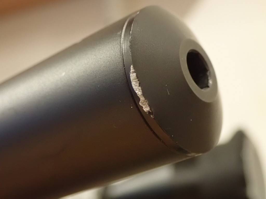

Talking conical on the end like the scraped one pictured. No clearance necessary.
OH I see the confusion. That LDC with the scrape is mounted to his gun permanently with epoxy or locktite if this clears the air.
No no, you're right, my bad. Donny recommended a cone on the part of my moderator needed to clear the air cylinder on my Prod, so I wouldn't scrape up the shroud. Wasn't quite big enough, but you're talking about the opposite end -- yikes, sorry. Wasn't thinking for a moment. I misunderstood somehow. Sorry to be misleading.
