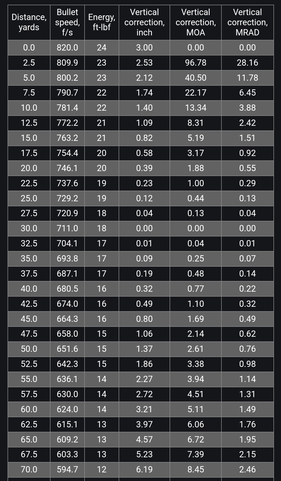

Here's a chart from the ChairGun app showing what @Motorhead was explaining with using the 30 yard zero.

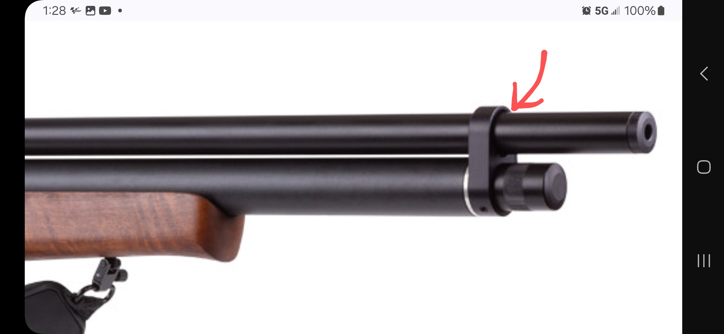

Also with the Marauder, it has that floating barrel that may get tweaked downward from sitting against a wall. And because of this you may not be able to get that elevation out of it. Setting them against a wall like this also tends to move the point of impact around at the next shooting session. To fix this impact shift on my semi auto Marauder I jammed a thin oring in between the barrel shroud and the barrel band to hold it tight. A few wraps of black electrical tape to take up the space would dobthe same. This procedure may cause point of impact issues when refilled, or it may not-- you'll have to experiment with the results.
