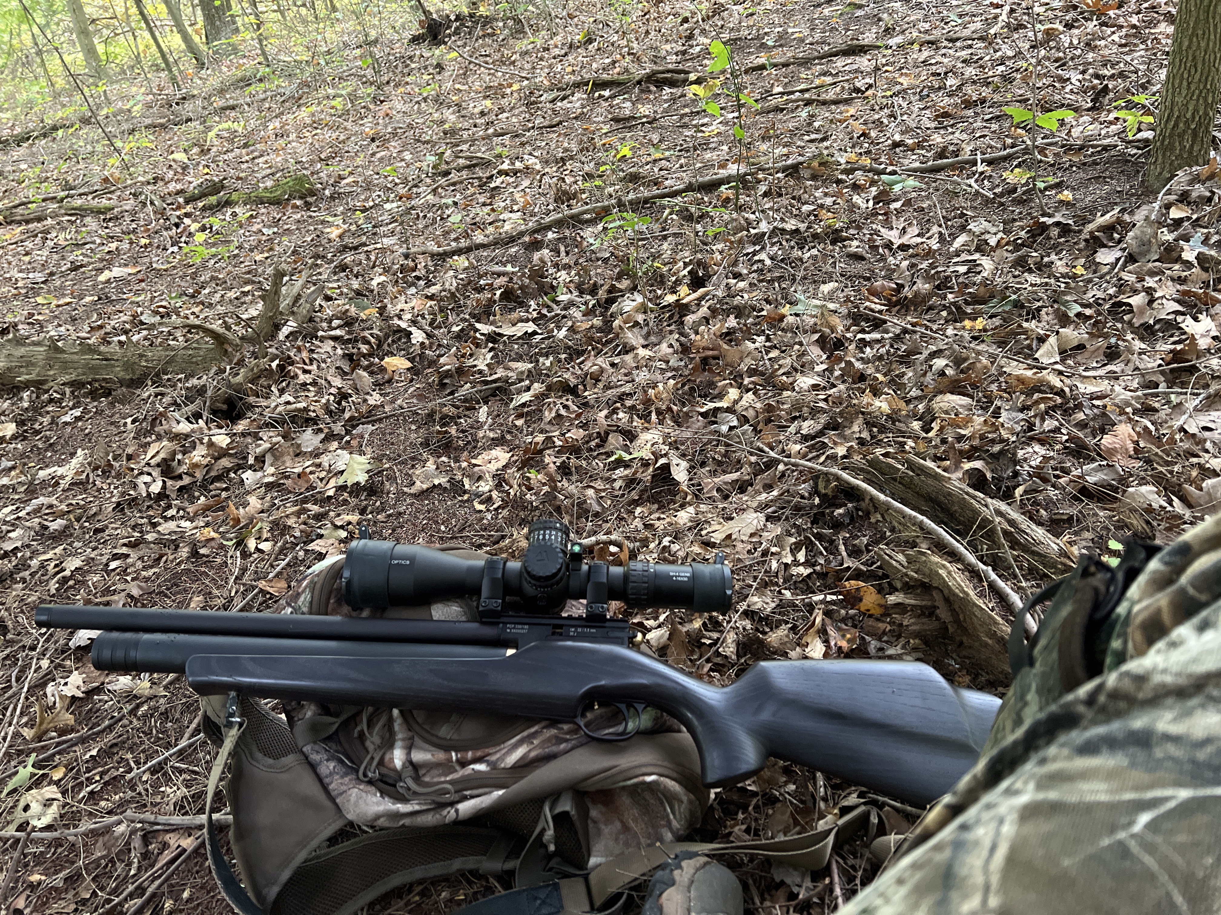

I’m hunting right now. When I got here it got rainy so I figured it would be a good day to hike, hang a camera and do a little scouting. My original plan was just to sit for squirrel. Needless to say my M3 is in its case in my car. They are not a rough and tumble gun. This is.
May I ask what make or model that is? I like that one.
That hortitsia is a sweet little carbine. Seems like every eastern bloc airgun company makes rugged guns
