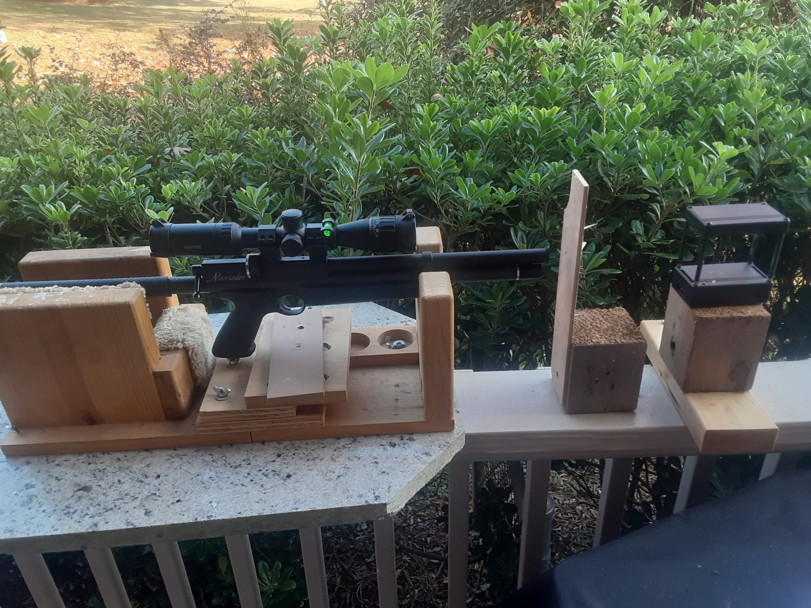

In case anybody isn't already aware, I am on the "two holes is better than one" side of favoring simple domed pellets for hunting. But that does lead to a logical concern with what the pellet does after penetrating the animal. Could it zipping off and damage something? To get some data I did some tests today. I do not think they prove much of anything but I found them interesting and maybe some of you will too.

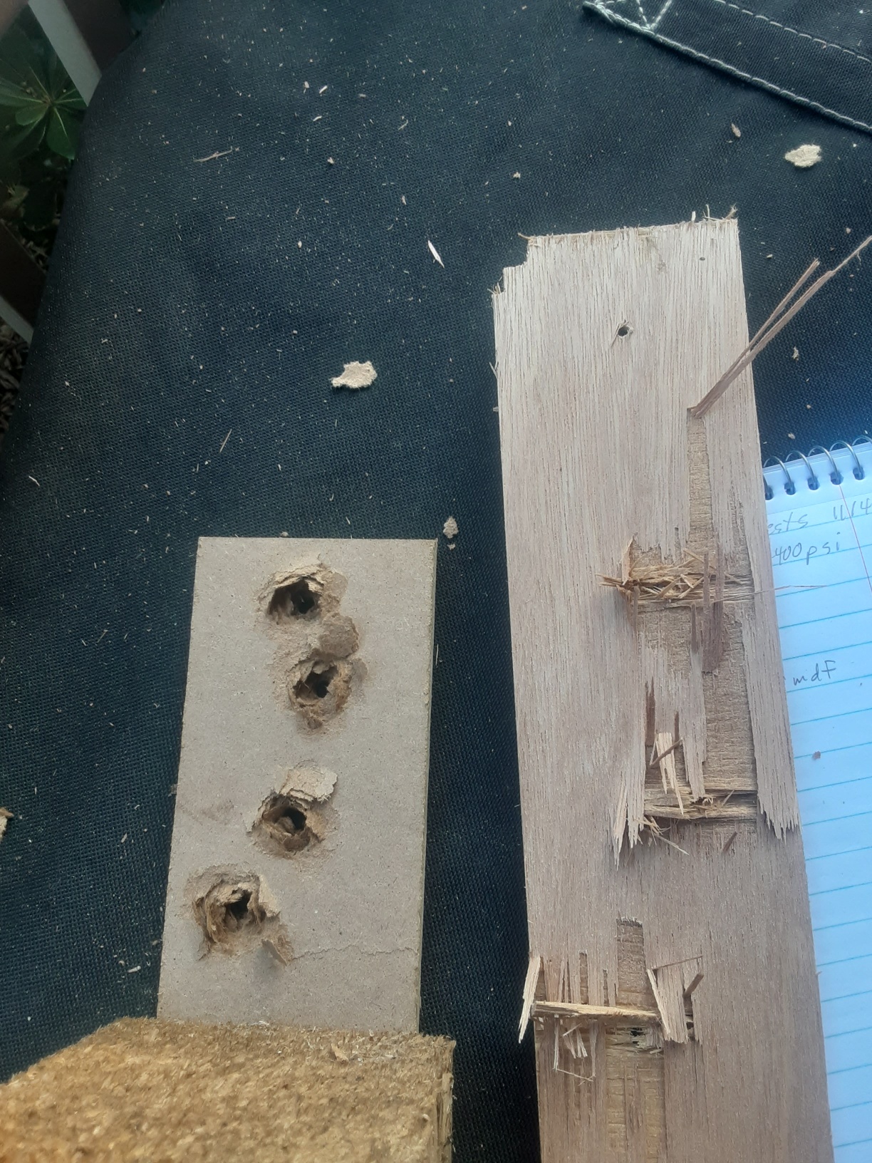

I shot through first scraps of luan plywood and then scraps of 1/4 inch thick MDF and measured the velocity after the pellet exited. I will include a picture of my crude "test rig". Essentially this was at the muzzle. My cheap chinese chronograph does not have a remote display nor does it record (at least in a way I can use). So I wanted everything close so I could just look at the chrony and record the velocity. I used the luan to test things out because I only had a couple small scraps of 1/4 mdf. I find mdf to be less variable in results compared to plywood. I used 1/4 mdf because I consider it crudely approximates penetration of a squirrel. My pump up 177 will not shoot through 1/4 mdf and didn't make it past the shoulder bones of the one squirrel I shot with it. But my guns that shoot through 1/4 mdf kill squirrels nicely and sometimes go through a squirrel - but only on a broadside shot. I used my Prod that was shooting 14.66 grain copper plated FTTs at just over 700 fps this morning (it was cool, about 50 F) for about 16 fpe and my P35-177 shooting 10.66 grain H&N Baracudas at about 890 fps for almost 19 fpe. In wet paper the P35 penetrates a little further than the Prod and it retained a bit more velocity in this test too.
The Prod projectiles slowed to about 100 mps or 330 fps going through the MDF. Or about 3.5 fpe at exit. The P35 projectiles slowed to about 525 fps and 6-7 fpe at exit.
I do not worry much about over penetration with these guns. I suspected the pellets would have limited fpe left if they exited and this seems to be the case. I think this overstates the energy they would have typically because the projectiles often so not exit the squirrel. This is probably beyond worst case for the energy at exit. Probably. But could a 7 fpe pellet penetrate something? Yes, I think it could. I don't think it could kill even a small animal but it might break or injure something. But it doesn't have the same risk as it had at exit of the muzzle and distance will further decrease it's energy.
What about my other PCPs with 30-40 fpe? I'm out of MDF scraps at the moment but I think it's reasonable to think higher fpe airguns would also loose 10-15 fpe going through 1/4 MDF and at least that much going through a squirrel. My 30-40 fpe guns do normally shoot through. If they are still carrying 15-30 fpe then they are more likely to hurt something. I thus see a reasonable argument for potentially using expanding projectiles in guns like this to limit the projectile velocity at exit. What I actually do, however, is to avoid shots where there are things in the path of my shot that could be damaged. That habit got pretty ingrained in my decades shooting powder burners.
I thus see expanding projectiles as possibly having a role for higher powered PCPs but not for lower powered PCPs. I don't think we increase the chances of a clean kill with a 10-20 fpe gun by using an expanding projectiles because it's penetration is not going to be too much with a non-expanding one. But for 30+ fpe guns, I can see an argument for making a wider hole instead sending a projectile zinging off with potentially harmful energy left.

Also, MDF compresses a bit before it cracks and penetrates the surface, especially off a round nose pellet type impact. That would sap alot of the power out of the projectile as well. It also has more rebound to it.
I've had pellets ricochet back at me from low powered pellets guns and MDF board, where as they'd dent a pine 2x4 and it would drop there.
I have no doubt a 177 pellet at 5 fpe will kill a squirrel with a well placed brain shot. But I know from first hand experience it will not get the job done on a shoulder shot on a mature squirrel. I was only about 10 yards away but that gun has a peep sight and I was worried about placement so I went for the shoulder - bigger target. Should have shot it in the head I guess. But my bigger decision was to use guns that would kill cleanly with any reasonable placement.
The lighter guns, my 177 pump up or my Sheridan pump without many pumps, will indeed bounce off MDF. The only significance I attribute to that is it indicates limited penetration capability. No concern about over penetration. I am concerned with under penetration.
I like MDF tests mainly for "head knocking" ability. Ability to penetrate the skull. Not of squirrels, those are lightly constructed, but of larger animals. I test in wet paper to test penetration through muscle tissue. I could have done that today but it was easier to set up a little MDF penetration test. Some people think penetration through 3/4 of MDF indicates a gun will go through a pig skull. Only one of my air rifles has this sort of penetration. My ~30 fpe 22 and 25 will go through 1/2 but not 3/4 of MDF.

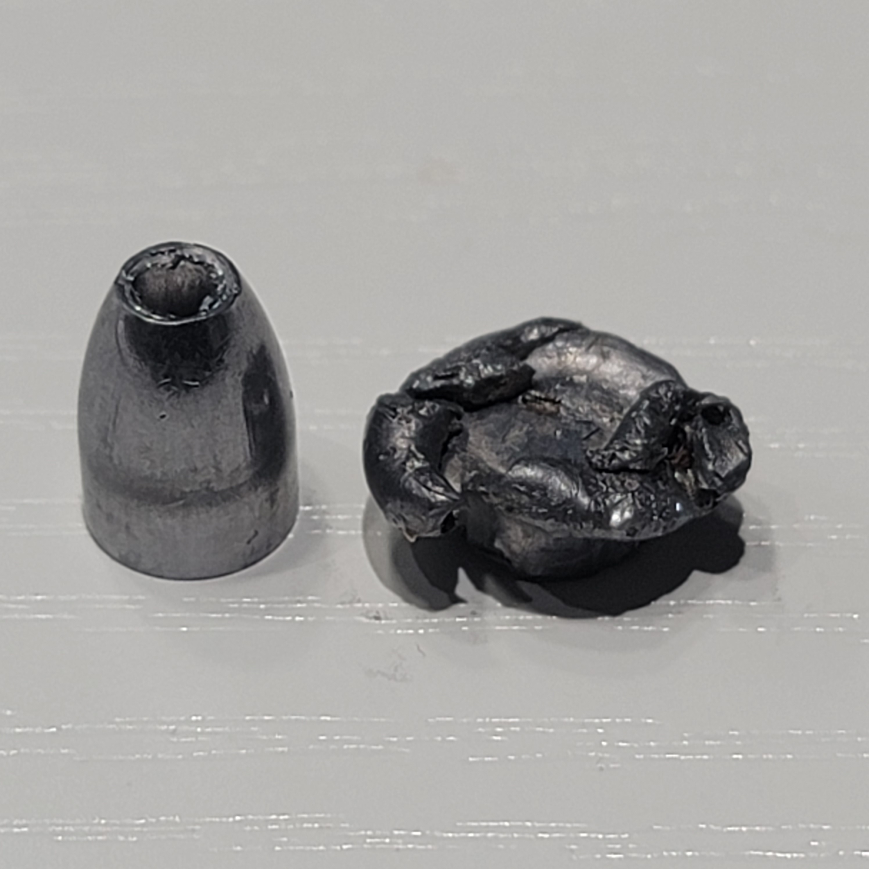

Expanding on the 30+ ft/lb conversation, using those higher powered guns can really over penetrate. I've doubled a few times on ground squirells and tripled once. The triple kill was with younger squirrels gathered in front of hole and was intentional on my part. However, seeing that, I'm more cautious than ever when shooting on the horse properties I have access to.
Expanding projectiles sound like just the ticket, but with squirrels, I haven't found a projectile that expands quickly enough to minimize my concerns.
Slugs do an excellent job and are accurate in most of my rifles. However, I've retrieved expanded slugs after a pass through & ricocheting off of the ground and penetrating into railroad ties or banging off of large rocks.
The hades, Crow Mag's, polymags- again, some shoot accurately within 65 yards, but can still warrant care with backgrounds. One thing they don't do is ricochet viciously and carry down range as ferociously as slugs or hybrids.
I'm more cautious than I used to be after seeing how far a slug can travel even after hitting meat or thin wood from 30+ ft/lb guns.
There are more .30 and .35 cal air rifles out there than ever- very effective and capable, we must take responsibility for every discharge.
There is a place in my rifle rack for a range of energy delivering guns- used appropriately, each is an effective tool. If we had a projectile like the .17hmr in frangibility, I'd be using my higher calibers more frequently for small game.
Mid size game is a different story. Head shooting a raccoon or coyote - I'll always reach for as much energy as I can get.
That being said, a coyote I shot in the boiler room from my .30 Uragan, at 117 yards, had the Neilsen slug go through and through and then slapped into a rock embankment 20 yards further, making a secondary thwack loud enough to let me know it was still carry dangerous amounts of energy.

...That being said, a coyote I shot in the boiler room from my .30 Uragan, at 117 yards, had the Neilsen slug go through and through and then slapped into a rock embankment 20 yards further, making a secondary thwack loud enough to let me know it was still carry dangerous amounts of energy.
This is one of the reasons I no longer use NSA slugs in my airguns. Even at higher energies, they simply fail to expand, even on larger game.
This is why I've chosen to keep shooting Hybrid Slugs, but again, if they are not shot with sufficient velocity, the expansion is limited.
Here is a photo of a .30 cal Hybrid Slug after full passthrough on a groundhog bodyshot at 66 yards. The slug traveled 10 foot after exit.
