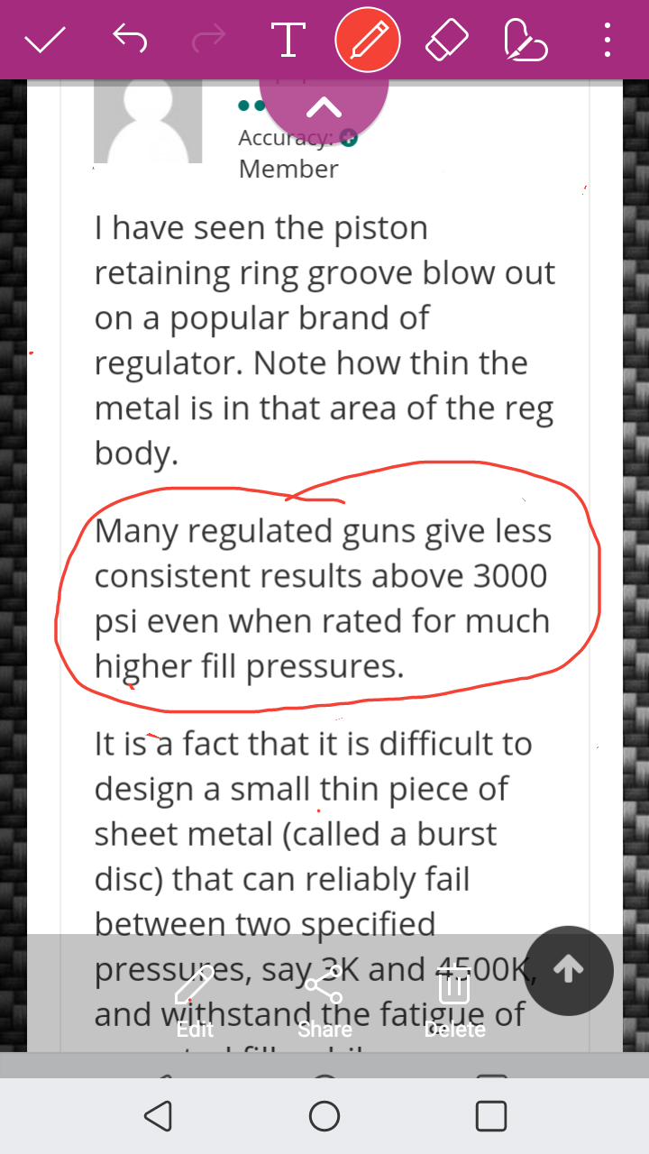

You do know these cf bottle on our guns and air tube are pressures test over 10,000psi right? I've seen some dude on YouTube tested his marauder pistol air tube to over 12,000 psi behind protected glass and it did not blow up and the prod tube is so small compare to other guns. Tell me, when did you acquire an compressor to fill your gun to 15,000 psi. Most of our compressor is max at 4500 psi. There is no way you gonna blow up your gun with that pressures.
As for op. One or few times over fill wont do harm. But i wouldn't suggest overfill often or leaving them over fill for long periods of time. If you just over fill you can always degass it

You cant be that naïve to not know the difference between a tested or burst pressure vs a working pressure. If Billy YouTube continually overfills his Mrod, he is going to have a problem eventually. I personally don't care who overfills a gun. Topics like this just add to my list of people I wont buy a used gun from. I don't know at what pressure the metal of your chosen air vessel starts to stress. What we do know is the pressure we can safely fill it to for probably the life of the gun. Most of us have overfilled our guns. We overfill because our gauges are off. We shouldn't fill our Prods to 4,000psi because we want more shots. Its not fair to the guy you sell that gun to.
