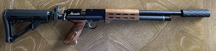

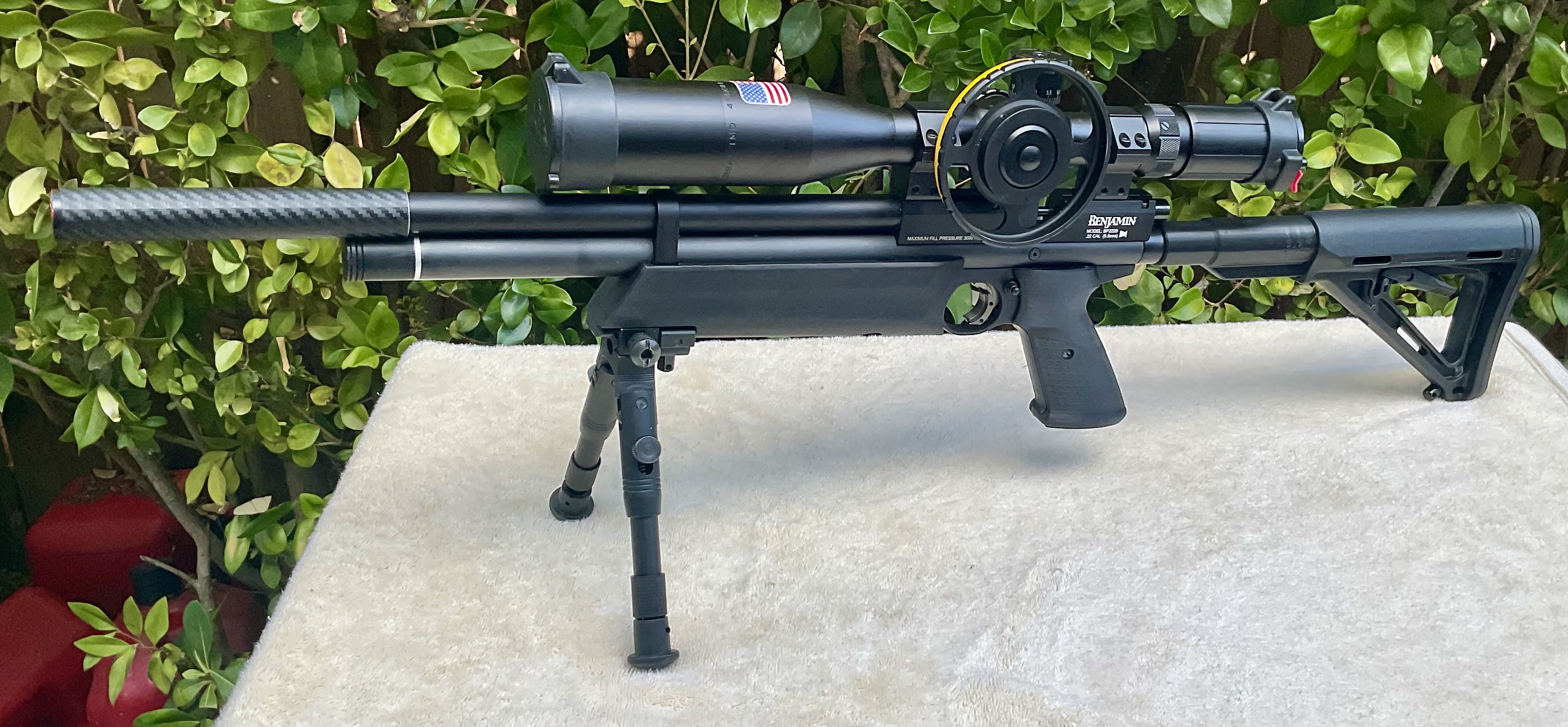

Just finishing up this build
How you like that trigger shoe? I’m building my 2nd P-Rod now. I’m tuning it now then it’s going in a wood stock. Trying to get to the 16-17 fpe mark.
I like it fine.How you like that trigger shoe? I’m building my 2nd P-Rod now. I’m tuning it now then it’s going in a wood stock. Trying to get to the 16-17 fpe mark.
are those pmod lowers or something ordered and do they work with the regular marauder? love that lookNice set up! Here’s mine, The m-rod trigger group is a game changer to! The original trigger isn’t bad but the Mrod is awesome. How’s yours shooting?

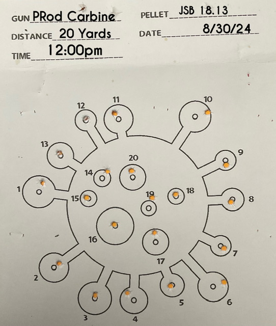

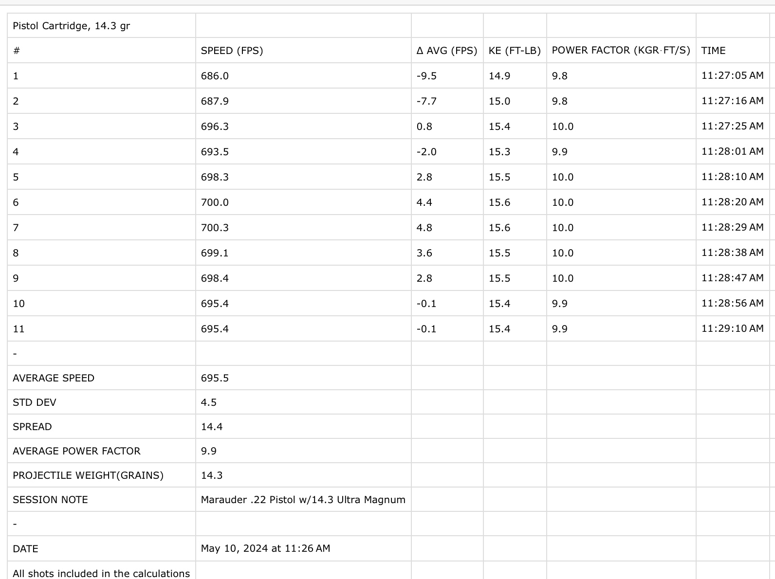

A target recently shot with the PRod.
Note: The 18.13 pellets shoot at 640fps:
My buckrail p-rod set up is around 15 fpe to. It’s a pretty good spot for consistency. It shoots really well too. My other one im tuning now is right about 16 fpe. Might try to get a little more for fun. Tinkering with them is as fun as shootingI like it fine.
This one shoots at 15fpe with factory equipment.
Settings:
HT 1.0CW
HS 6.0CW
Factory TP
14.3 Premiers

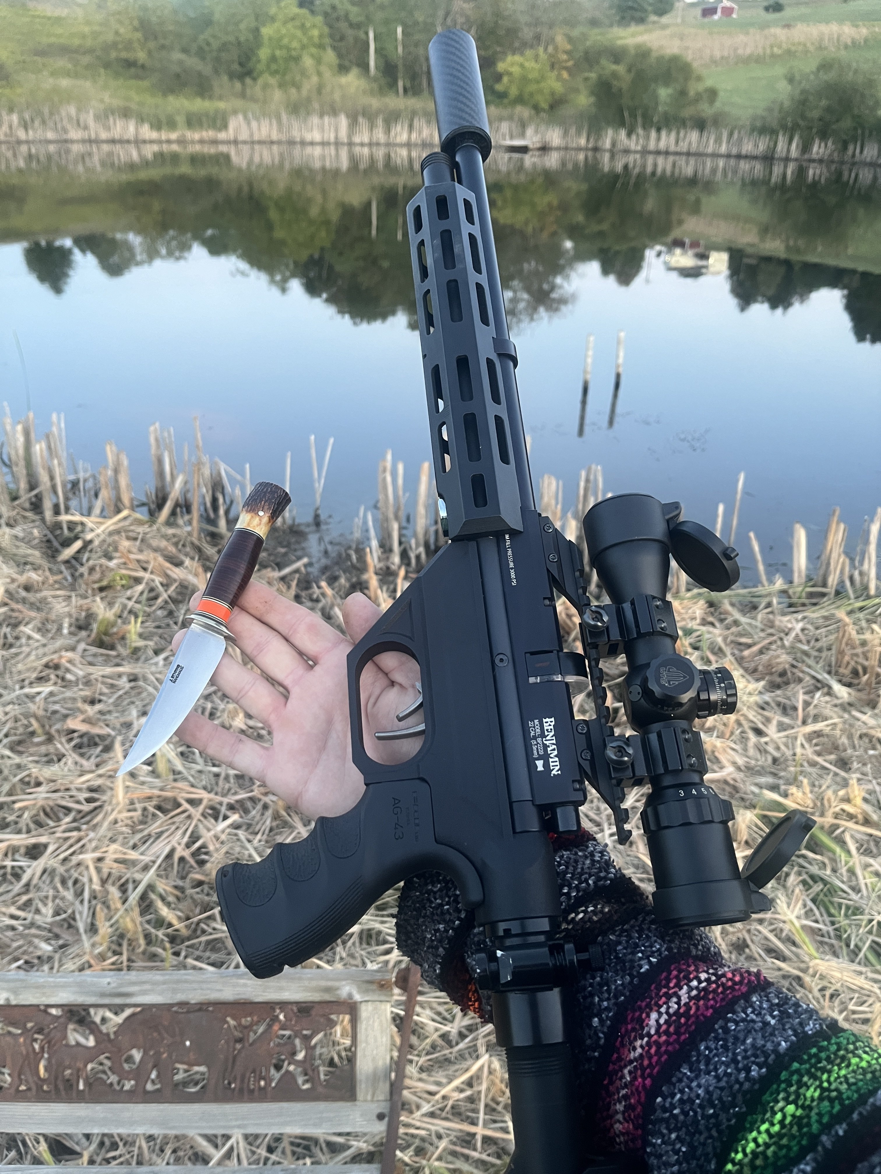

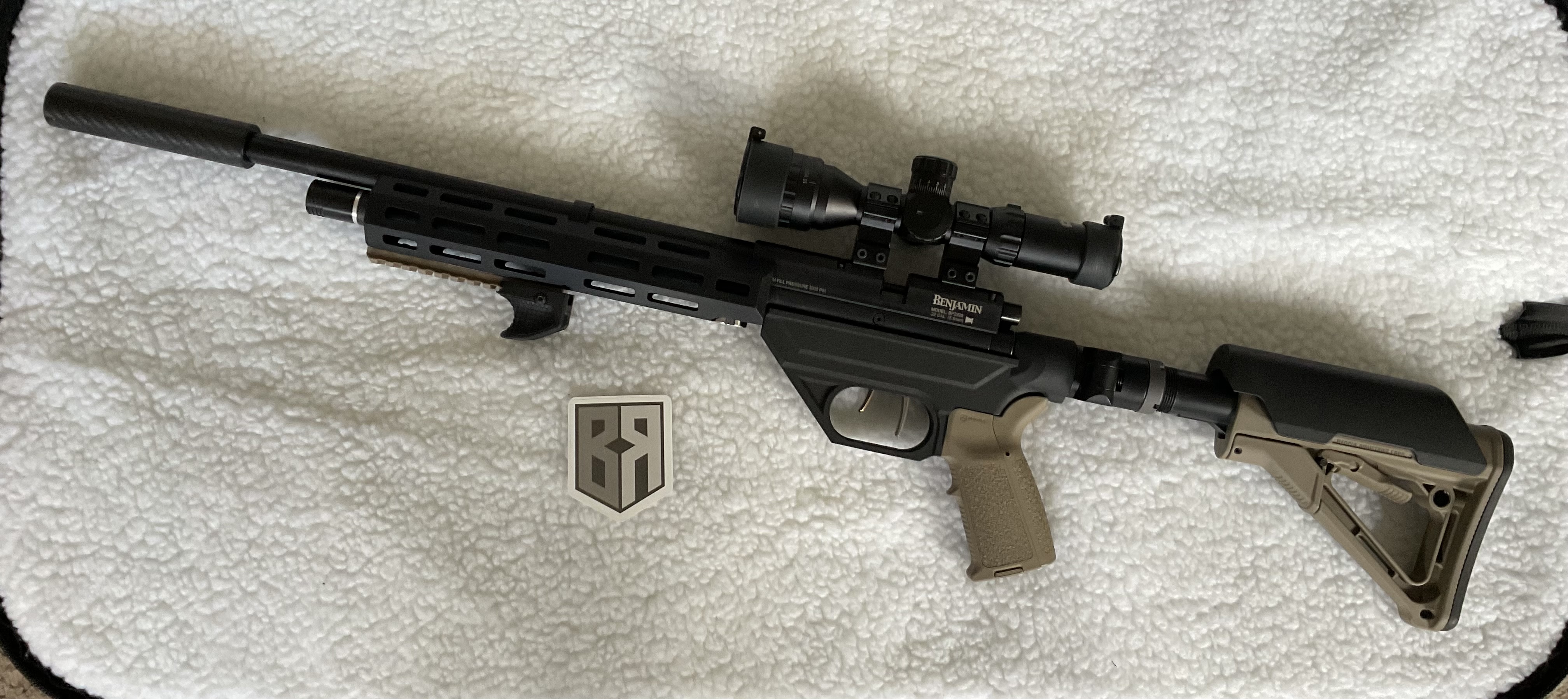

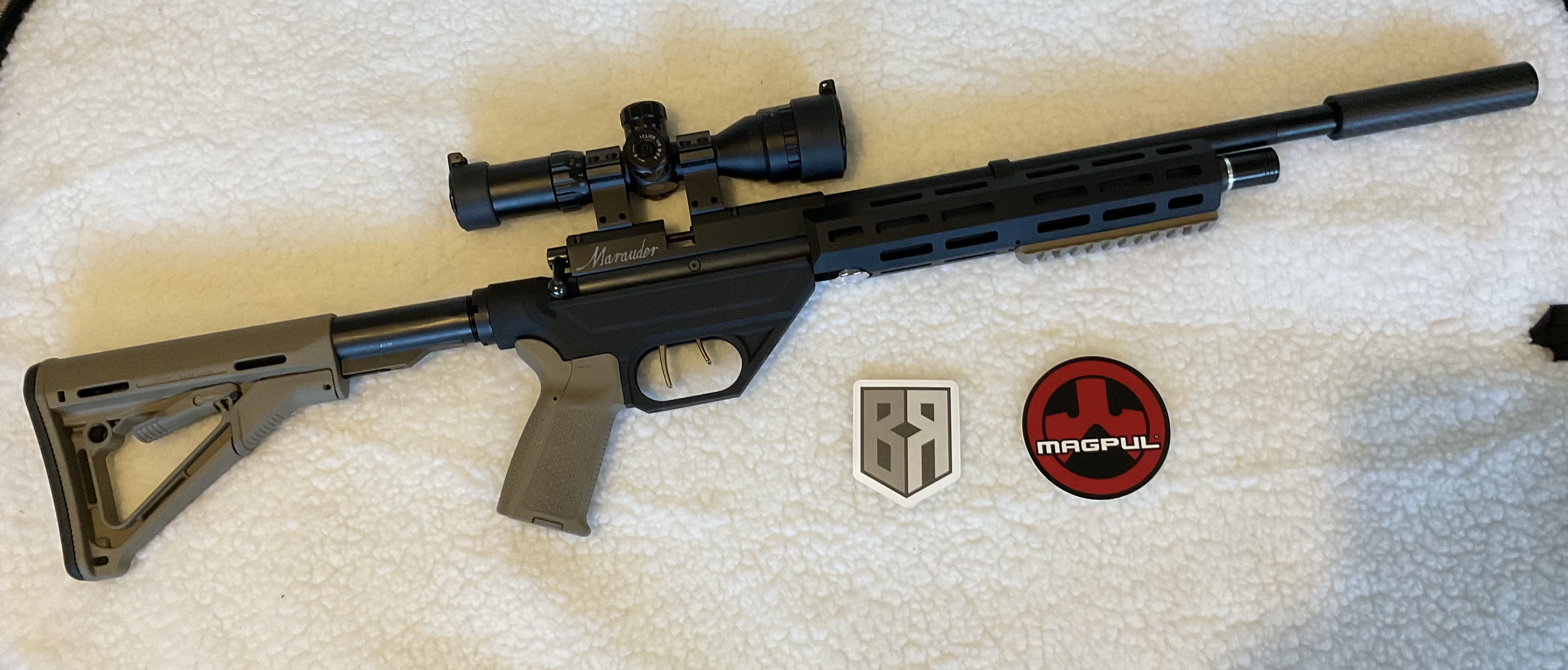

These are the Marauder Pistols with Buckrail Tactical conversions. Basically a new grip adapter that accepts the mrod trigger and ar grips/stock. I’m not sure if Buckrail makes them for the mrod. I believe someone does though.are those pmod lowers or something ordered and do they work with the regular marauder? love that look
and now im on the hunt lmfaoThese are the Marauder Pistols with Buckrail Tactical conversions. Basically a new grip adapter that accepts the mrod trigger and ar grips/stock. I’m not sure if Buckrail makes them for the mrod. I believe someone does though.

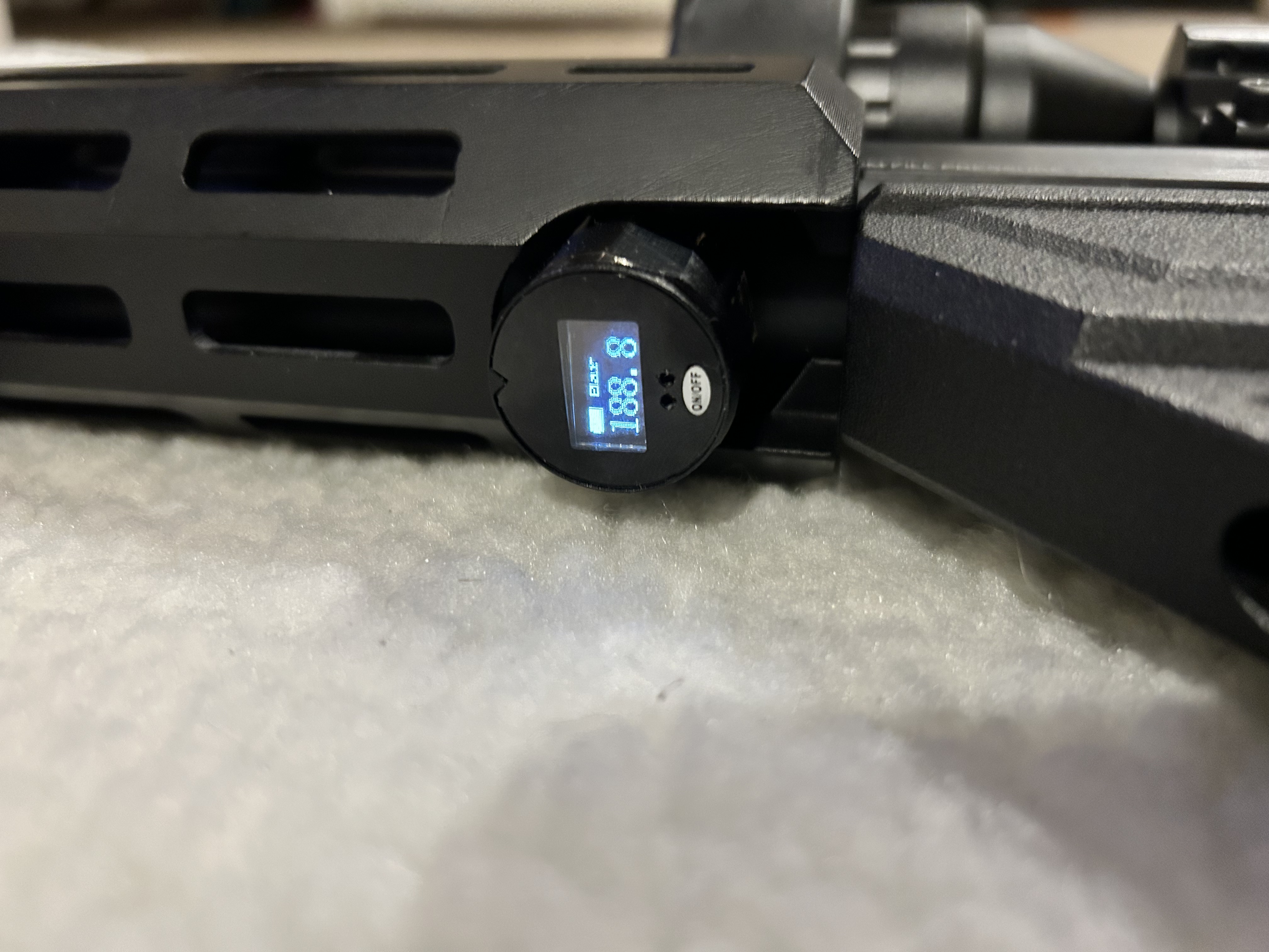

I like the digital gauge. What size threads is it? I looked at them myself but couldn’t find out for sure what I needed. I know Benjamin switched to straight threads in 2020 but is is BSP?Little update, fitted a FX folding stock adaptor, cheek riser and a digital gauge reading in bar
Be sure to post your wooden stock. I too would like to get a wood stock. Definitely gonna have to upgrade to the M-rod trigger groupHow you like that trigger shoe? I’m building my 2nd P-Rod now. I’m tuning it now then it’s going in a wood stock. Trying to get to the 16-17 fpe mark.
I like the look with the wood front grip. I think the only way to use the mrod trigger group is to get rid of the whole prod pistol grip & trigger.Then use the buckrail adapter. I’ve seen a a custom wood prod with a Boyd’s disco stock and Mrod trigger. It looked real nice. If I ever do another I might go that route. These things are addicting and can be expensive haha.Be sure to post your wooden stock. I too would like to get a wood stock. Definitely gonna have to upgrade to the M-rod trigger group
