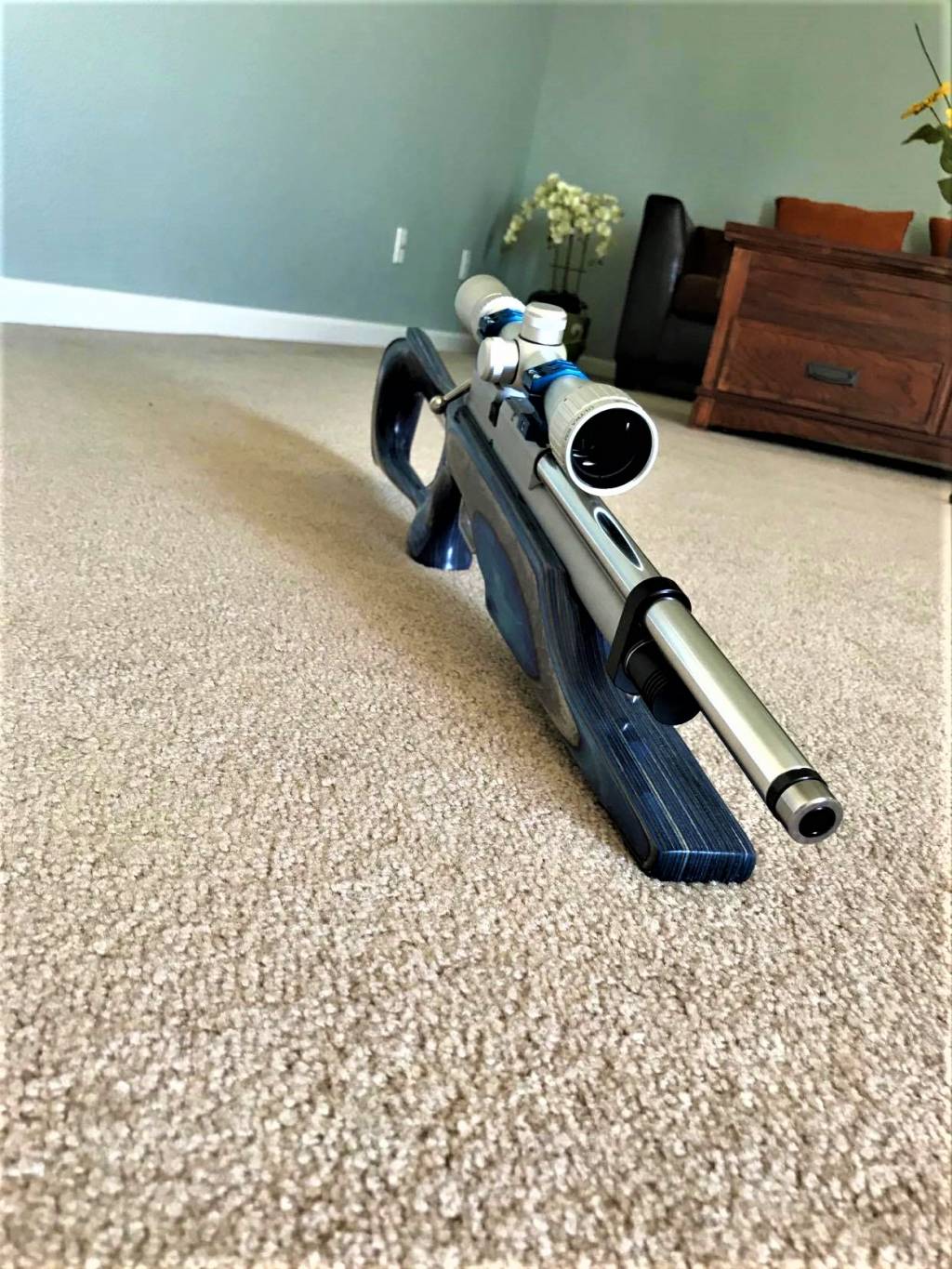

When I regulated mine I eliminated the throw button because I made my hammer and spring all one piece to eliminate hammer bounce. Your hammer spring is always important, regulated or not, $200 gun or $2,000 gun.
