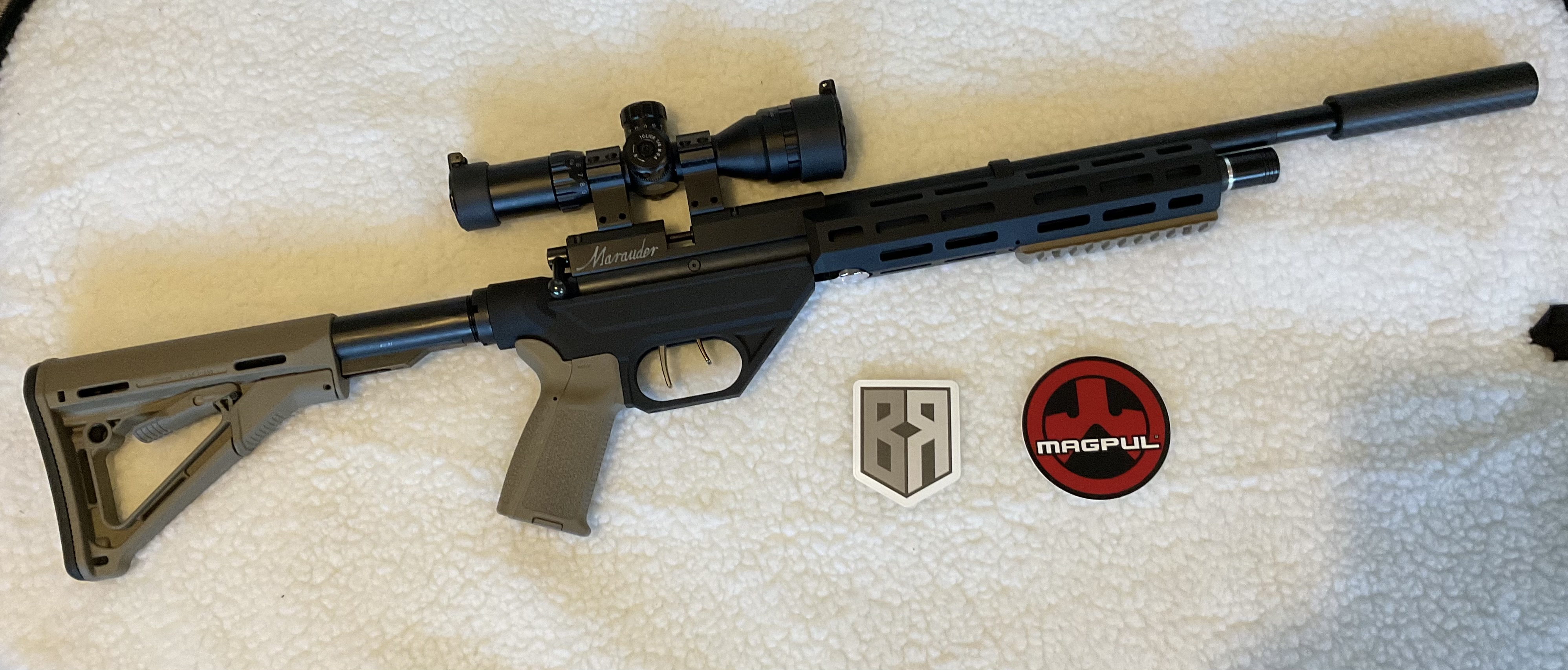

I’m just finishing up my P-Rod build, it’s amazing what’s out there for these and the Crosman variants, needs a nice scope, it’s just a Amazon £50 special on there at the mo…
I might jump down P-Rod rabbit hole this winter. Looks like there are so many ways to mod them. I have also been looking at the finished product from AR. Looks timeless.
