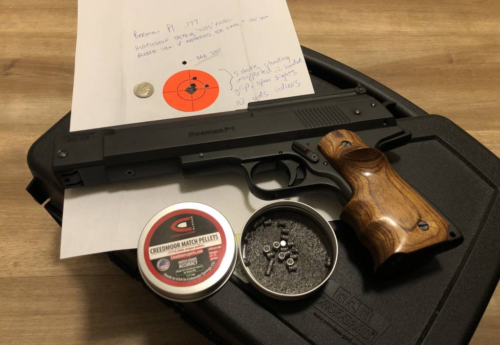

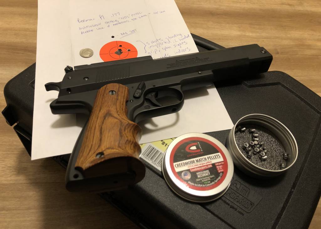

The gun is a total joy to shoot!
Before settling on these particular grips I tried several including Hogue (2 different styles), Pachymayr American Legend hardwood panel grips w/ rubber finger grooves, Beeman"ish" combat grips with finger grooves and various combinations with the Pearce rubber finger grooves.
The grips that resembled the Beeman combat grips worked very well for me, but I prefer the ones I have now much more. They do require a bit of shaping (sanding/filing) for best fit and comfort, however.
This 5 shot group was shot with a Beeman P1 .177 at 10 yds, standing, unsupported with a 2 handed grip using the open sights. 8gn Creedmore Match pellets used.
The shot that slipped high (shot #3) was me holding the pistol with too light of a grip. Shots 1, 2 and 5 touching on the center black of the target.

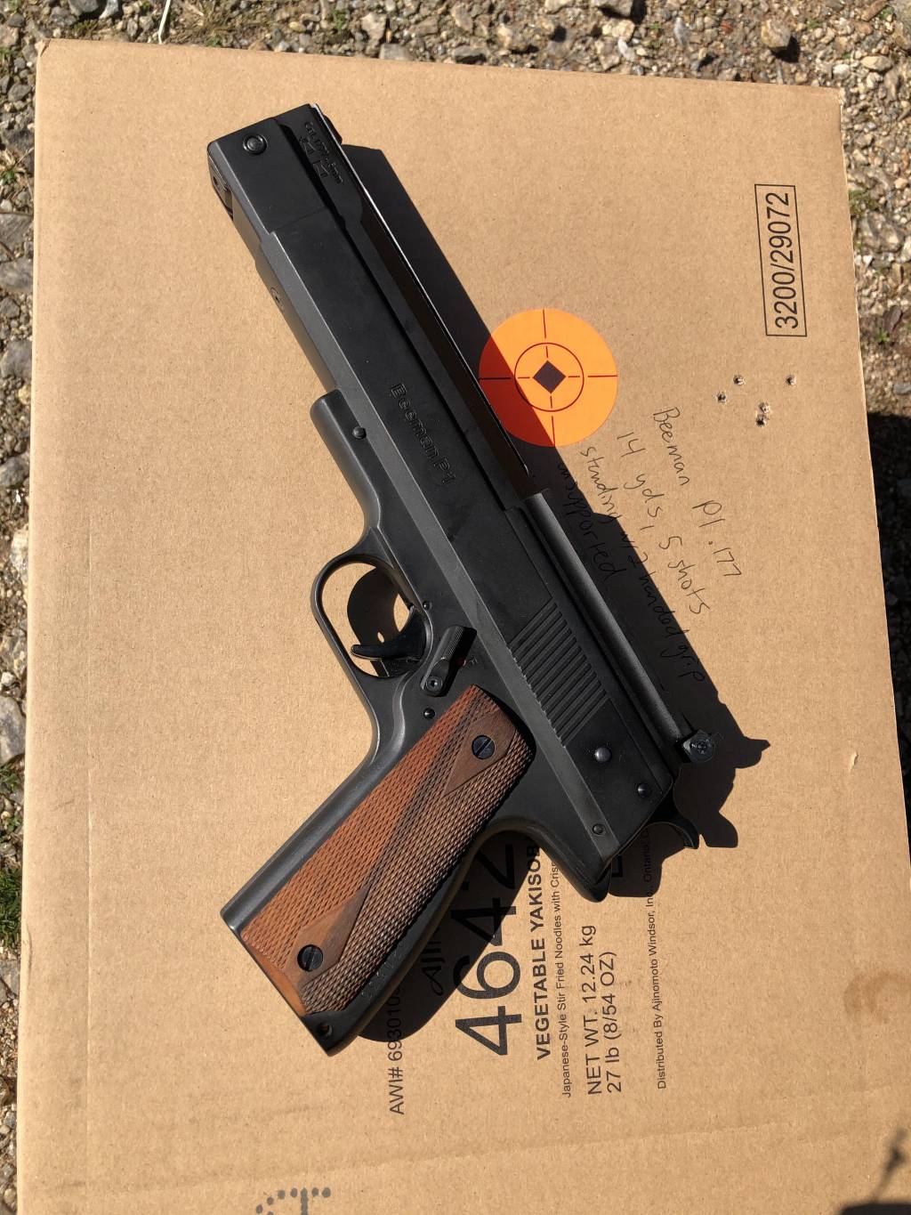

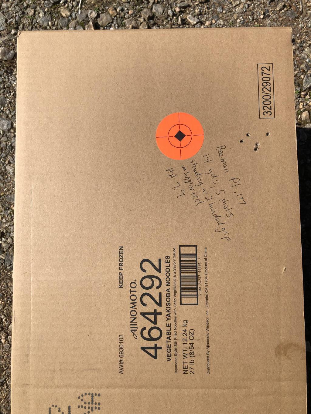

Here's a 5 shot group from last week, 14 yards outside, standing, unsupported, 2 handed grip, factory grips, outdoors in moderate wind using AA 7.9

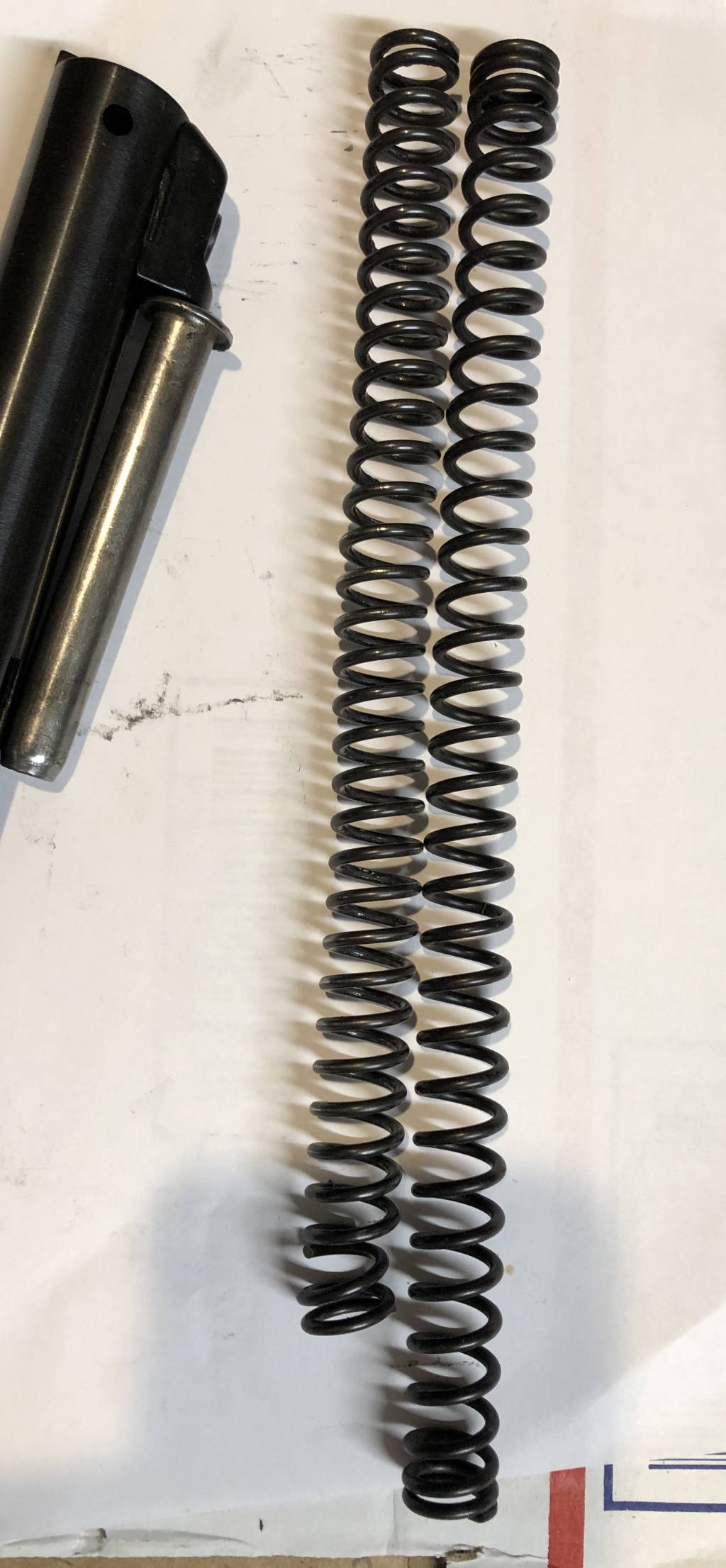

The HW45 does have a very long mainspring, indeed its shared by the HW25 air rifle. It does mean it is prone to slight buckling.
I should have snapped more pics while I had it apart for the tune but I was "in the zone". I did manage to take a couple pics. You can clearly see where the spring broke (one clear break) near the load bearing end. A pic of the new ARH spring next to it for reference.
Did you really say that (in bold above) ?
It's a "spring", the whole freaking thing...is "load bearing" !
Seriously? Come on man.
Thanks for letting me know it's a "spring".
