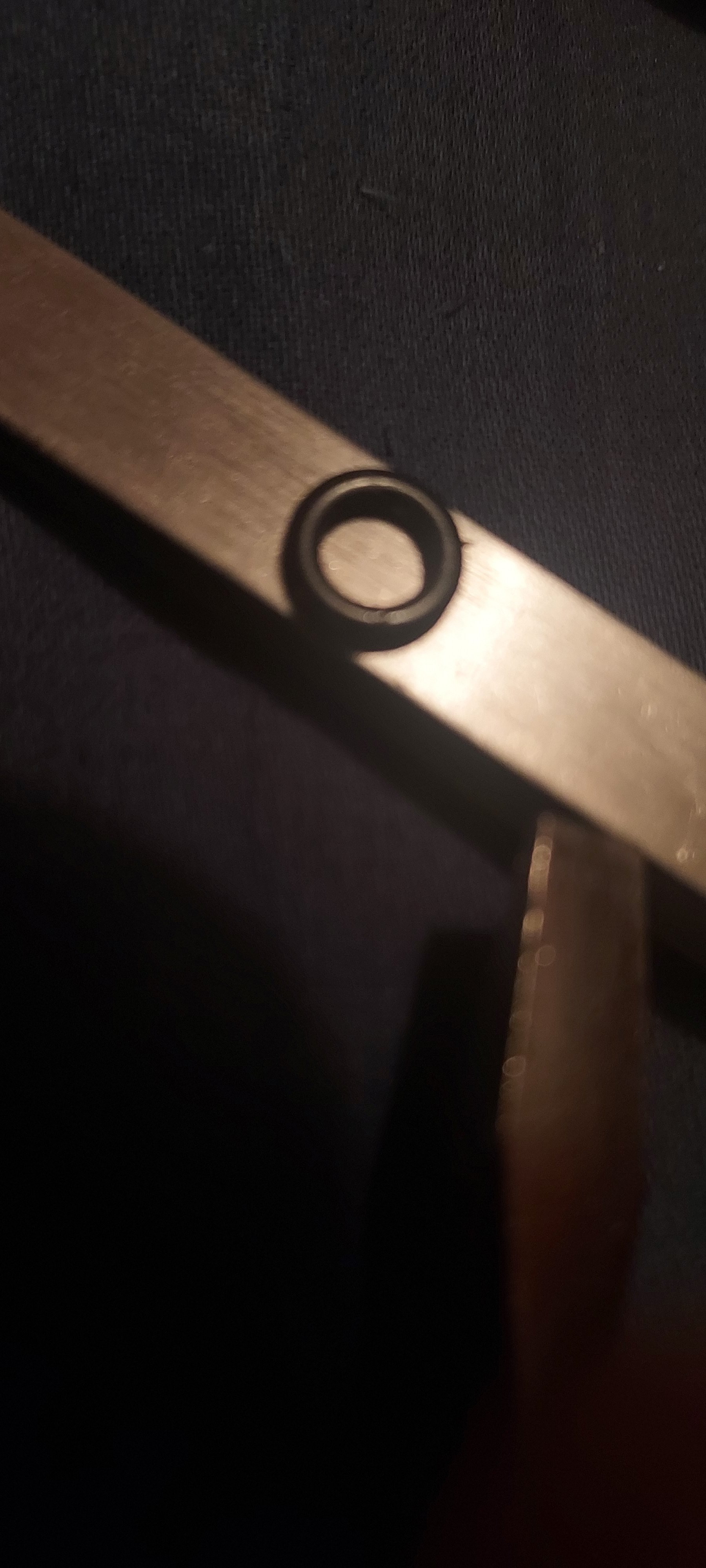

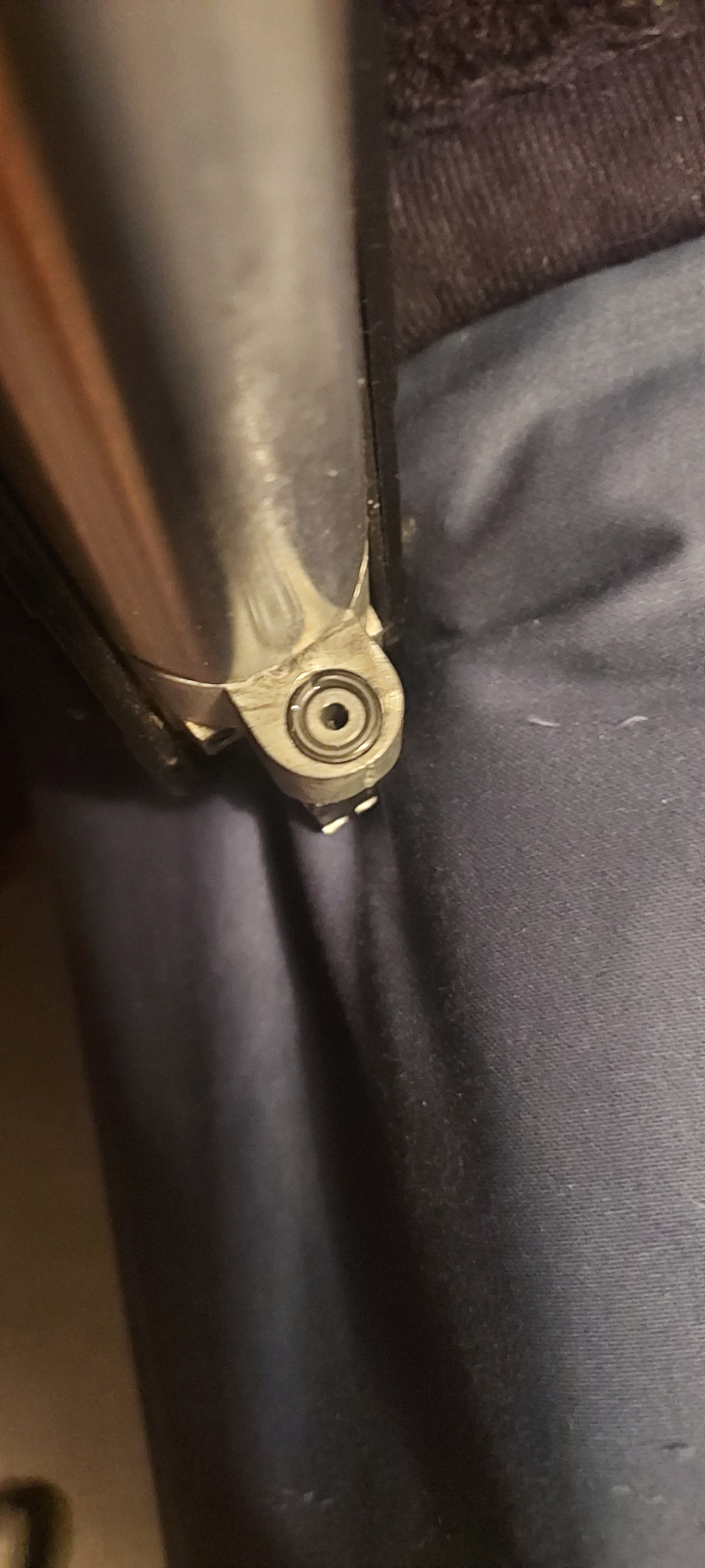

Doing maintenance and spotted a poopy o ring!
Wondering if anyone already has the info for this little bugger
Thanks in advance

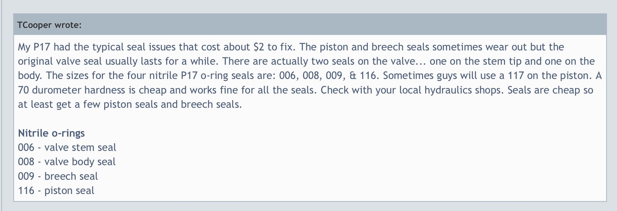

Thank youuuuuu!!!!!! Wasn't by any of the stuff at posting and searching time nor now lolFrom my saved parts list found on line It’s a 009 ring. 7/32 ID. 11/32 OD. 1/16 Wide. 70 durometer

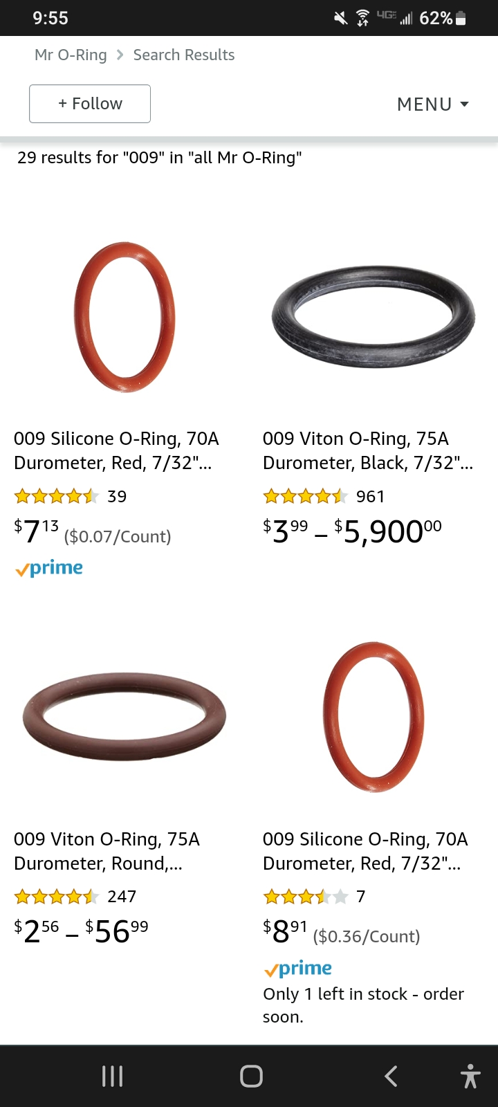

What material? I got this for optionsUse some calipers to measure the dimensions and order a pack from Mr O-Ring online for like next to nothing
Silly cone i can see but viton or buna no prob.. ( for me)Either Buna-N or polyurethane.
Neither Viton nor silicone are especially good for this application.
