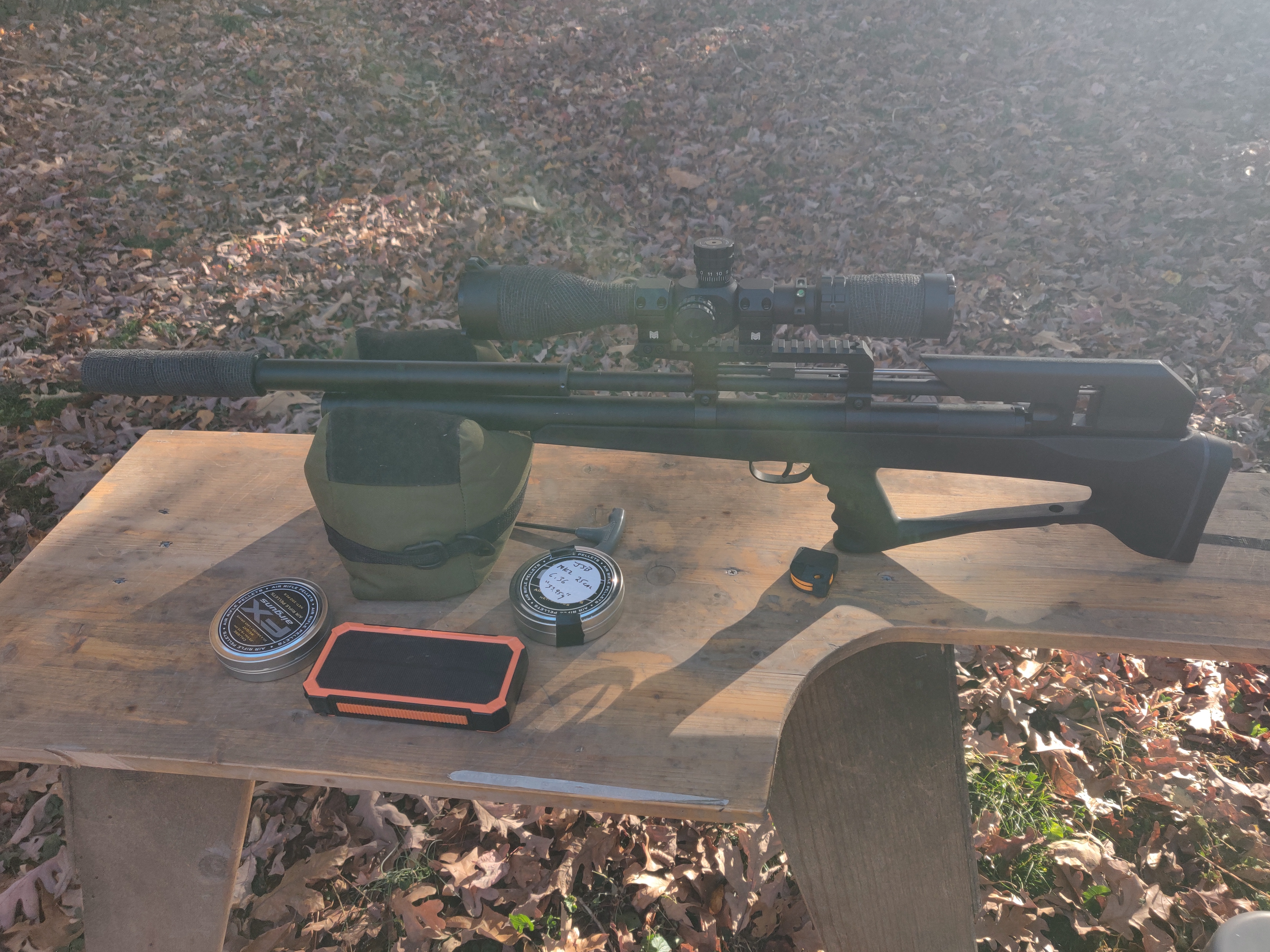

Got my alpha precision barrel and plenum in for my .25 P35. Should have some chronograph numbers tomorrow, I'm wondering what a difference the 23in barrel will make.

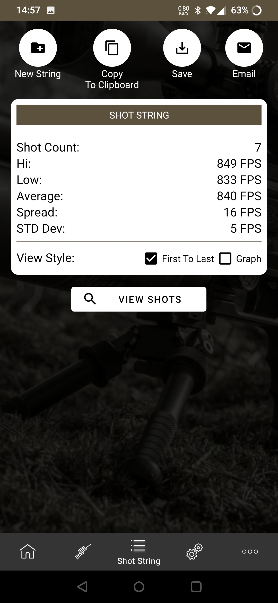

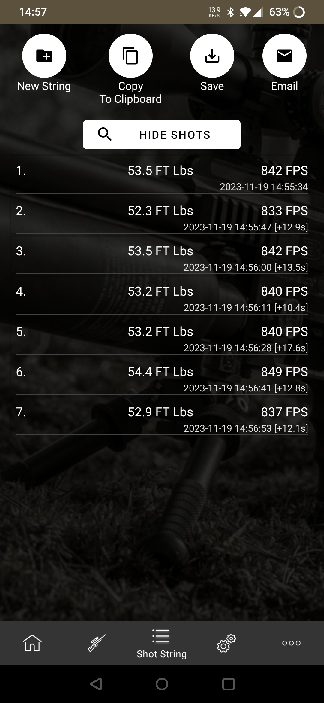

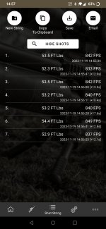

Got a chance to chronograph it today was around 950fps w/25 grain and 840fps w/34 grain @ 120 bar on the reg. I took 1 coil off the valve return spring. The last shot was off reg so it kinda jacked up the string.
I still have about one turn on the hammer but I don't want to damage the poppet till I get some more in.
Not to bad and I got 5 full mags before it dropped off the reg for 50 shots. Excuse the messy yard the leaves are killing me.
