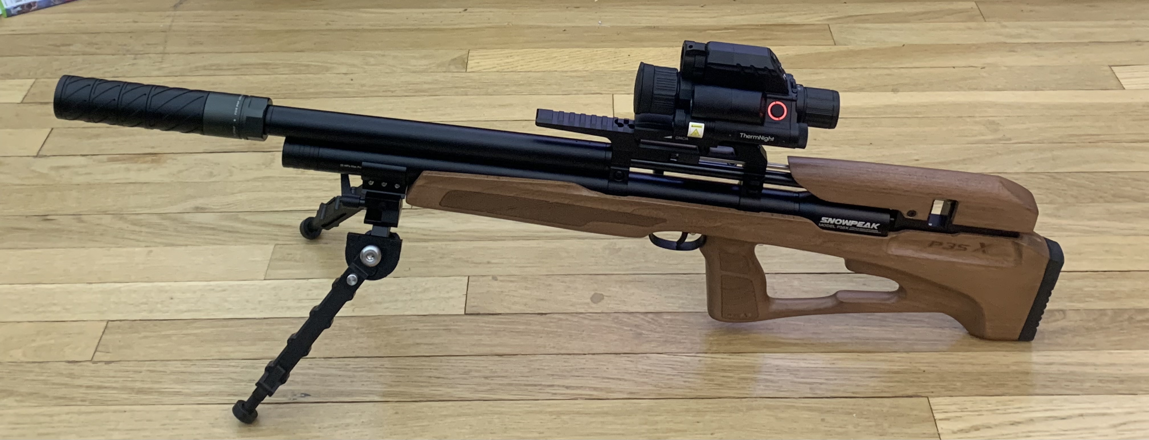

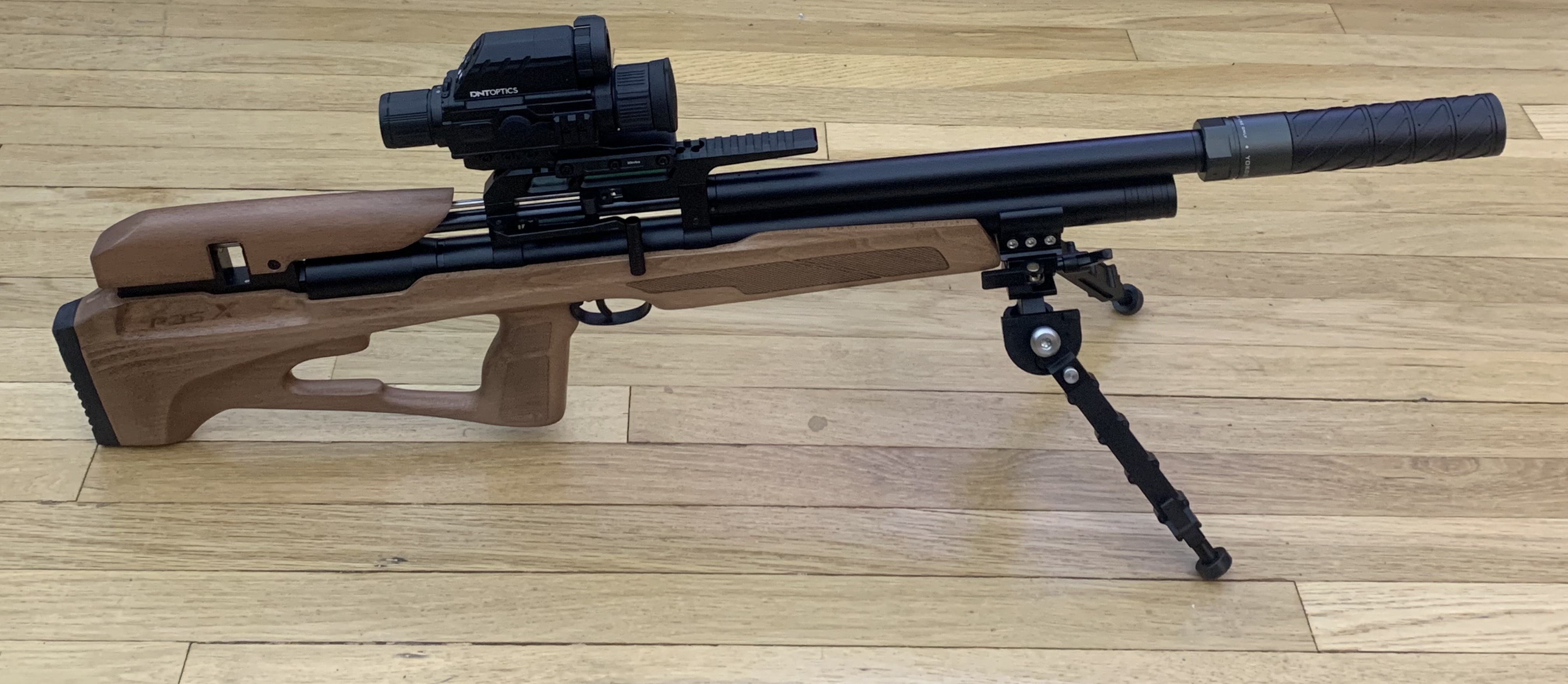

The box arrived in good shape. The barrel needed the requisite cleaning, lots of crud in there. The wood grain is attractive on my example. I mounted a DNT ThermNight 225, a DonnyFL Yokozuna, and stuffed the foam from 3 foam hair curlers over the barrel in the shroud to slow the air coming back out the perforated shroud. It is stupidly quiet this way, the action is much louder to the ear than anything else in the shot cycle.

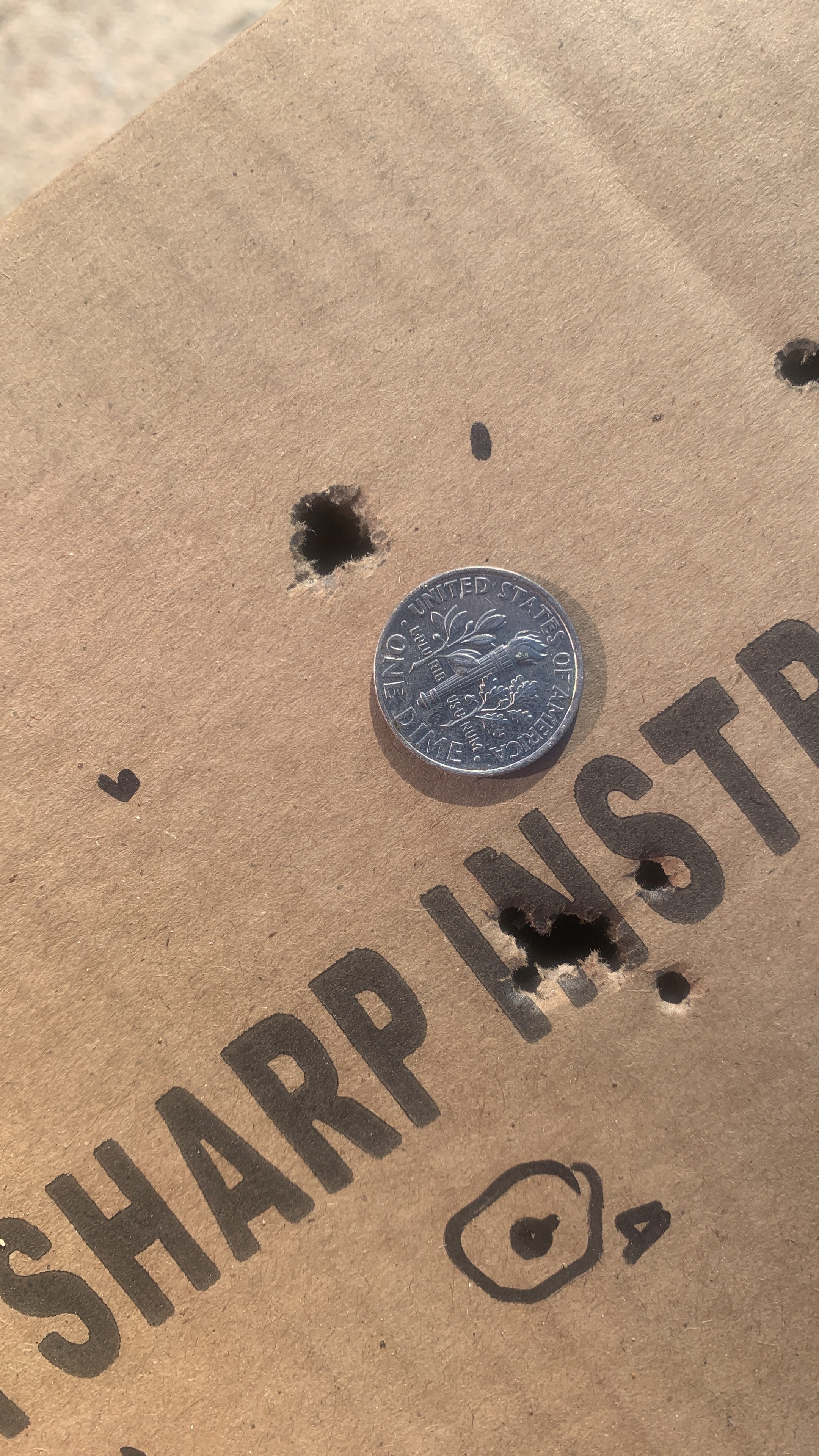

The JSB KOs shot very well. However, the H&N 20gr really shined. The first 4 shots all went through a barely enlarging hole and the following 7 whittled that hole a bit bigger except one shot that wandered just enough to oblong the hole - probably me. Shooting at 25 yards has me shooting sub-sub dime sized 11 shot groups for everything but the 15gr NSAs, it appears this barrel does not get along with those slugs, at least with this tune. In my experience with SPA barrels, they tend to like either the super-light or super-heavy stuff. Someday I’ll write up my experiences with my loveably schizophrenic Notos.

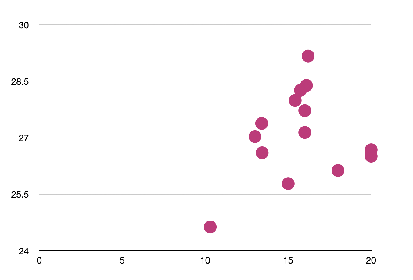

In the graph you can clearly see the slug weight versus energy curve is significantly behind the pellets. I conclude from the chart that we’re best off if we have projectiles in the 16gr range. Sometime this winter I’ll open it up and see if I can get that 32fpe with 16gr at around 950.
