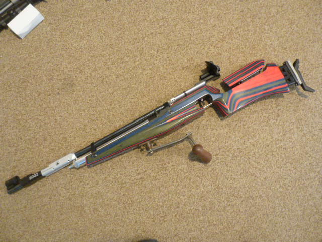

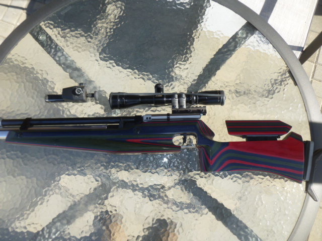

I've had this P70 for years.In excellent shape,has an in barrel suppressor so shot in basement during winter. With on going back problems will be selling. A fair price to sell? I used a palm rest last time I shot it,to help with the back issues,and three operations ...time to sell at 71 years old !. The grip got cracked before I bought it and whomever did A good job in fixing.Have had no problem .Does have an after market AZ air tube with quick fill nipple. That i addedThankyou
This gun shoots 7.9 gr pellet @ 600 fps
8.44@570 fps

Bad picture of mine.
Loading gate cut down.no scope base slot on barrel ala AZ. 8 grainers at 685 consistant.Mount double rings behind gate for scope.
