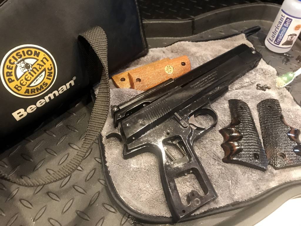

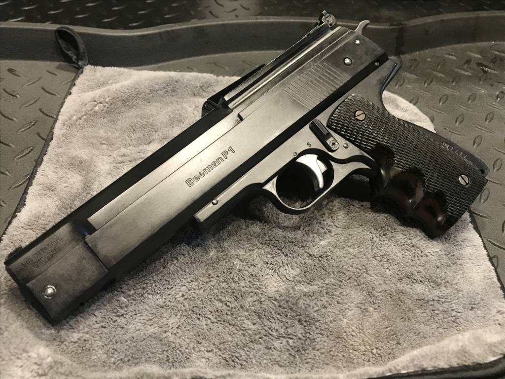

packed away for years, new2me Beeman P1, pre-fire questions
Today I scored a pistol I've had my eye on for a while.
It's been a while since it's been fired. Perhaps decades.
I'm no noob to airguns, at the very least it'll be cleaned, lubed, and visually checked.
Buuuuuut anything I might want to especially keep an eye on before loading it up?
Thank you!
#pdxfrank
thanks for the interest, i'll share more pics later. perhaps some targets :)
yes, .177. so far, really clean, zero rust, and nothing looks as if it won't shoot.
reviewing a couple youtube videos too.
i never really thought i'd get one, long on my bucket-list. but got lucky in a local deal.
picked up a few others too, part of a set. but eh, this is the one i wanted.

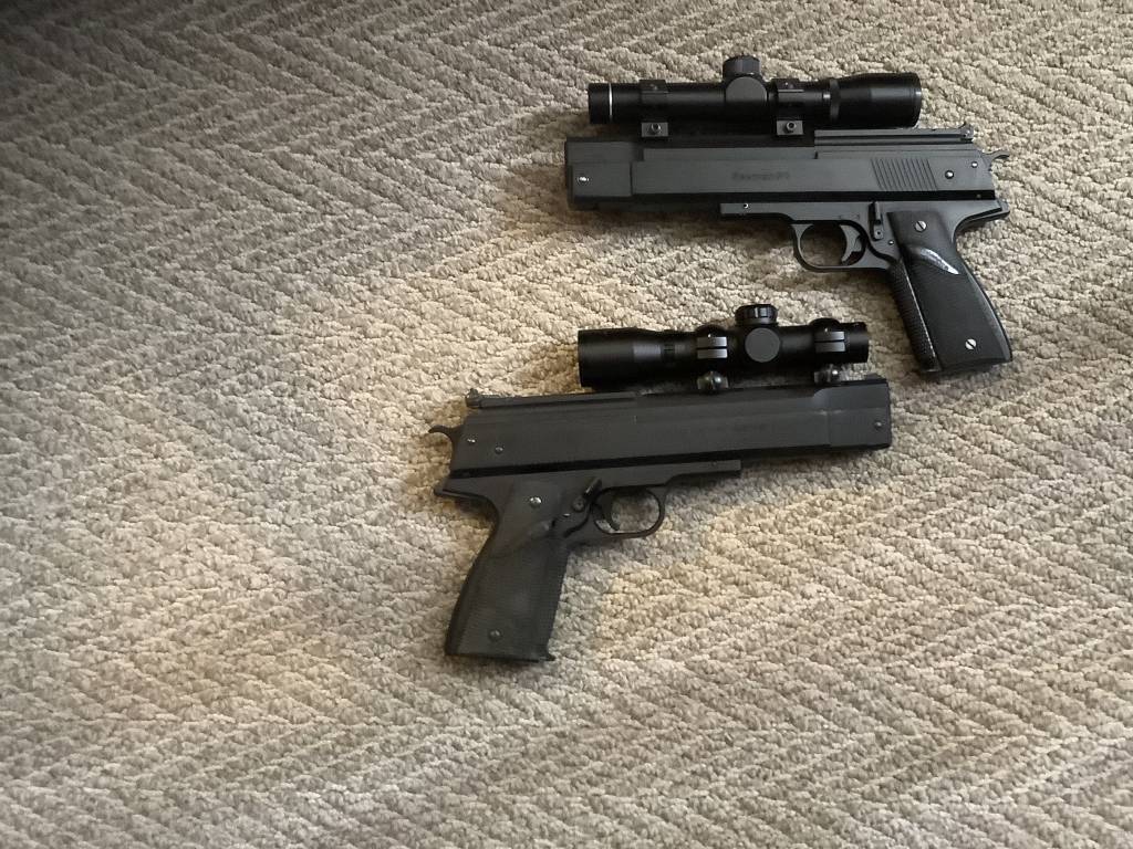

So I sold my P1 in in .22 cal I just didn’t like the way it cocked and shot.it was one of the new ones with the white lettering. Well a couple days ago this one popped up on the auction sight, turns out the guy lives local. I picked it @ a good price and it came with both a Beeman pell set and pell size along with a bunch of pellets. I have been shooting it open sight and really enjoying it, might not scope this one.
