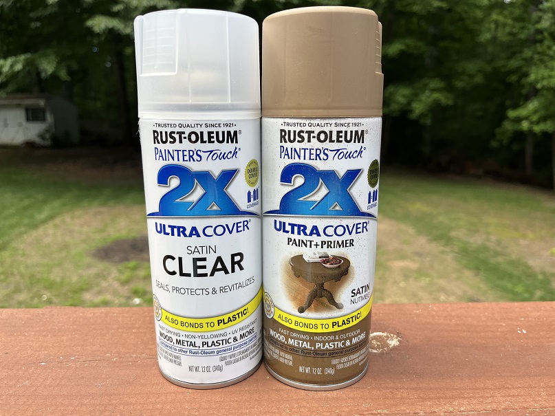

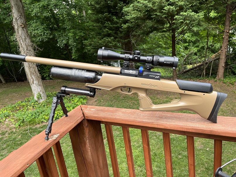

I bought Rustoleum at my local ace Hardware. Cleaned the stock thoughly with alcohol before painting. I applied 3 light coats of paint then 3 light coats of clear coat.

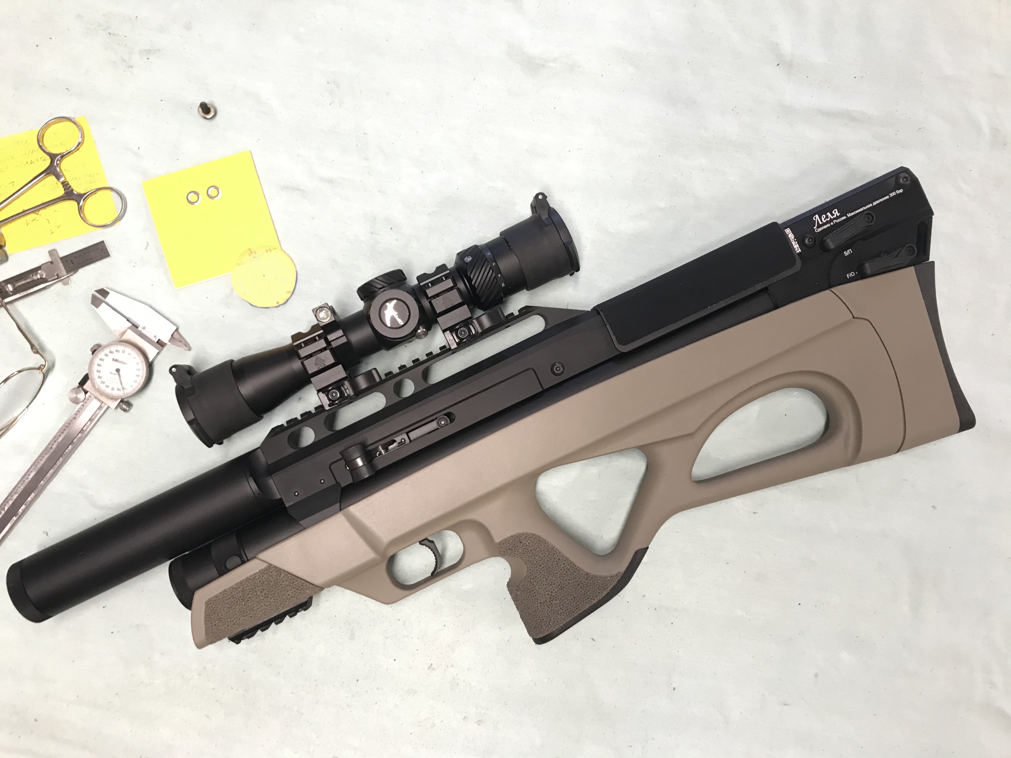

James, I went to my local paint store(not a box store)that had a section for custom automotive paint(catering to the hot rodders). I told them I needed it to be flexible, so they targeted paints for like dash boards, consoles, etc.
I brought in a Monstrum scope in FDE and they matched it in a spray can mix. Along with that I picked up adhesion promoter, plastic primer, cleaner degreaser for plastics, along with a few tack cloth wipes to really remove any fine particles prior to painting.
