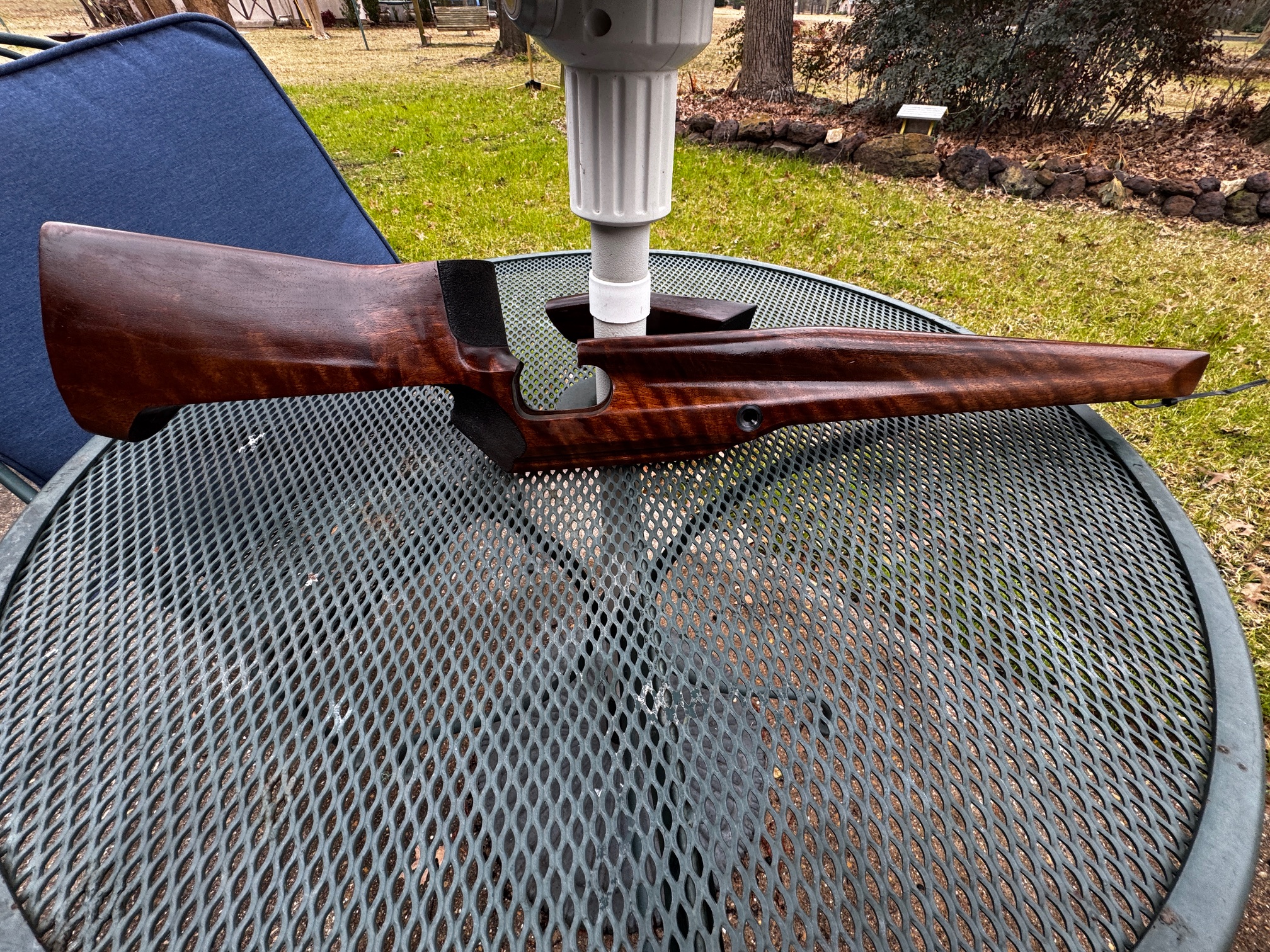

Made a trip to the hardware store this morning and picked up some paint stripper. It really made the job much quicker. A little bit of scraping with a single edge razor blade, then wiped excess off after a few minutes then went over it with some coarse steel wool and repeated a couple of times. That old finish was thick and tenacious in spots and still took some scraping. Ended up with a light sanding with some 220 then 400 grit sandpaper followed by an application of Minwax red oak wood finish. I was really looking for a straight stain, but just shook this one up no stirring so no signs of a lot of pigment like some of the old oil base stains. Wiped it off after a minute or so and got a nice red brown color. Will apply another coat in a couple of hours per directions, and will try to get some pictures in a couple of days.
A couple of pics after stripping, an application of Minwax red oak finish, and one application of boiled linseed oil. Will repeat linseed oil daily for at least a week. The area along side the rail, especially that topside had what appeared to be hundreds of dents, fortunately they were in the old finish and not extending down into the wood, The oil is really bringing out the color and grain in the wood.
