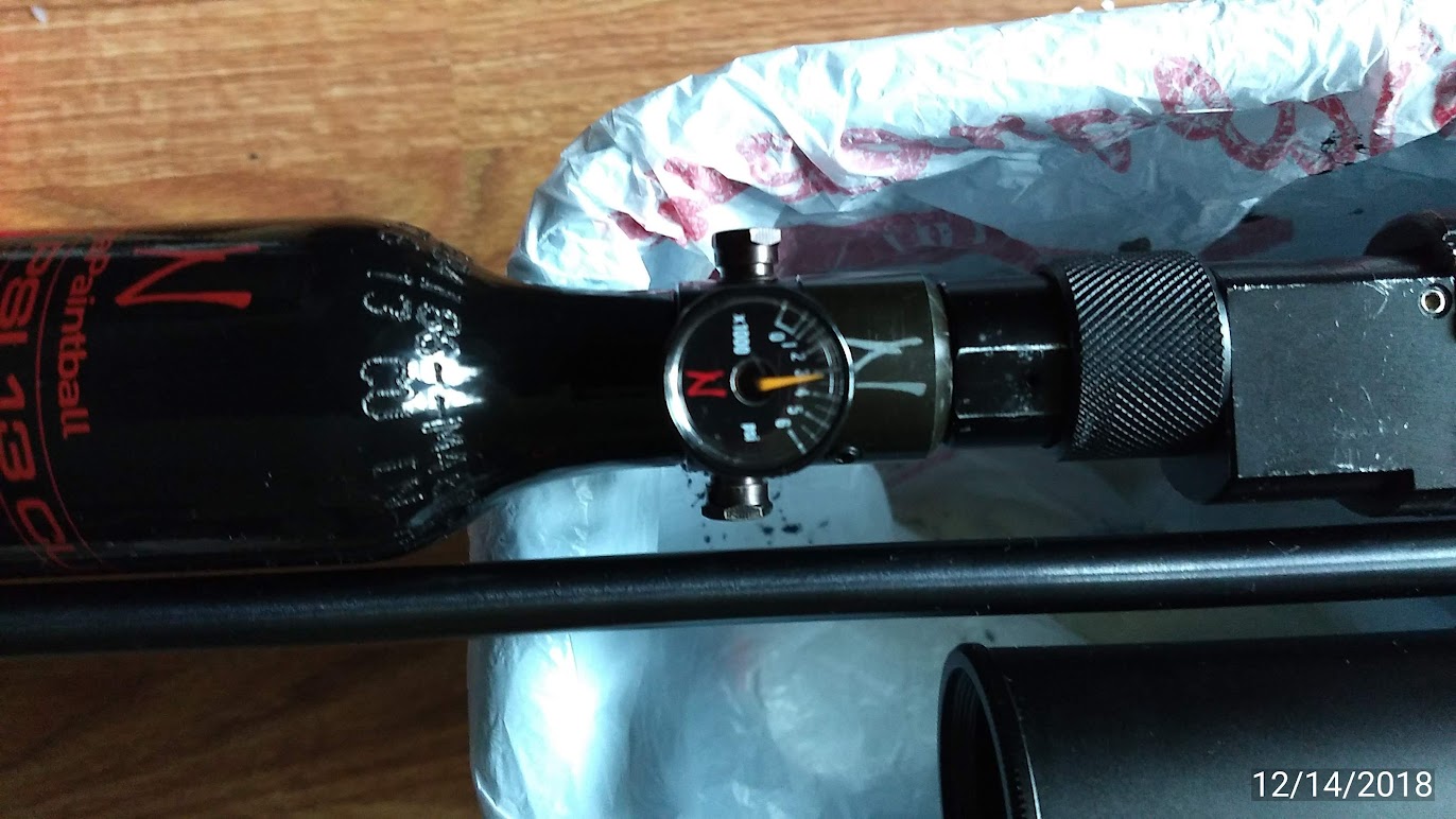

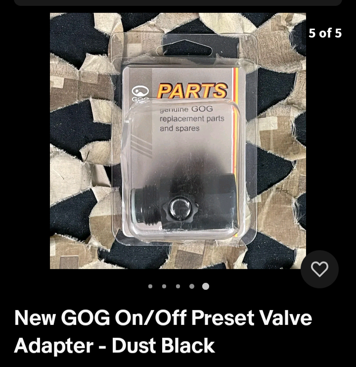

I'm looking to add an on/off valve to my QB 79. I'm using air and not CO2. The valve will go between the regulator and the rifle. Any safety concerns I should consider? I see a GOG paintball on/off that looks reasonable.
If the valve is exposed to the full bottle pressure of 3000+ psi, then I would want confirmation from the manufacturer that it was designed for that. If the valve is exposed to regulated pressure of 1500 psi or less, then I'm certain that it would be ok since it was designed for paintball use and there are safety margins built into the valve. I think, that realistically, there is low risk of the valve bursting at 4500 psi but that the internal valve seat may develop leaks if it is over pressurized. But again, we need to know the manufacturers design pressure to know if we are over pressurizing it or not...
