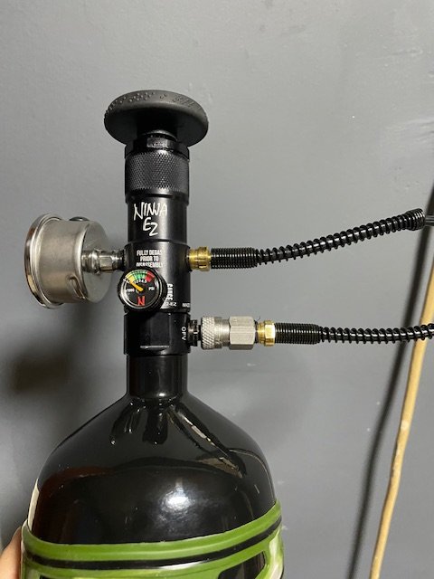

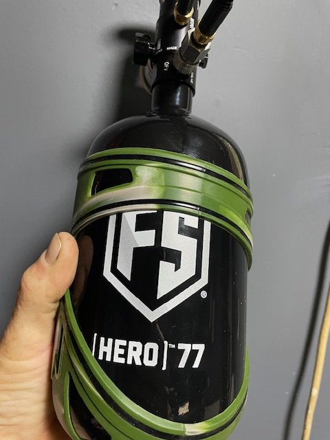

77 ci paintball tank with Ninja EZ fill.
I use one of the Benjamin small tanks, 90cu.in I think. Filled to 4500psi and filling a 3000ish psi tube gun, it gets more than "a fill or two". I would say several fills, with more partial fills. Quick to refill is another positive of the "Guppy" size tanks.
The Ninja system I remember was regulated to a 3k psi fill. It appears that one^ will fill to any pressure. Yeah, that's a no brainer since you already have the PB tanks.
