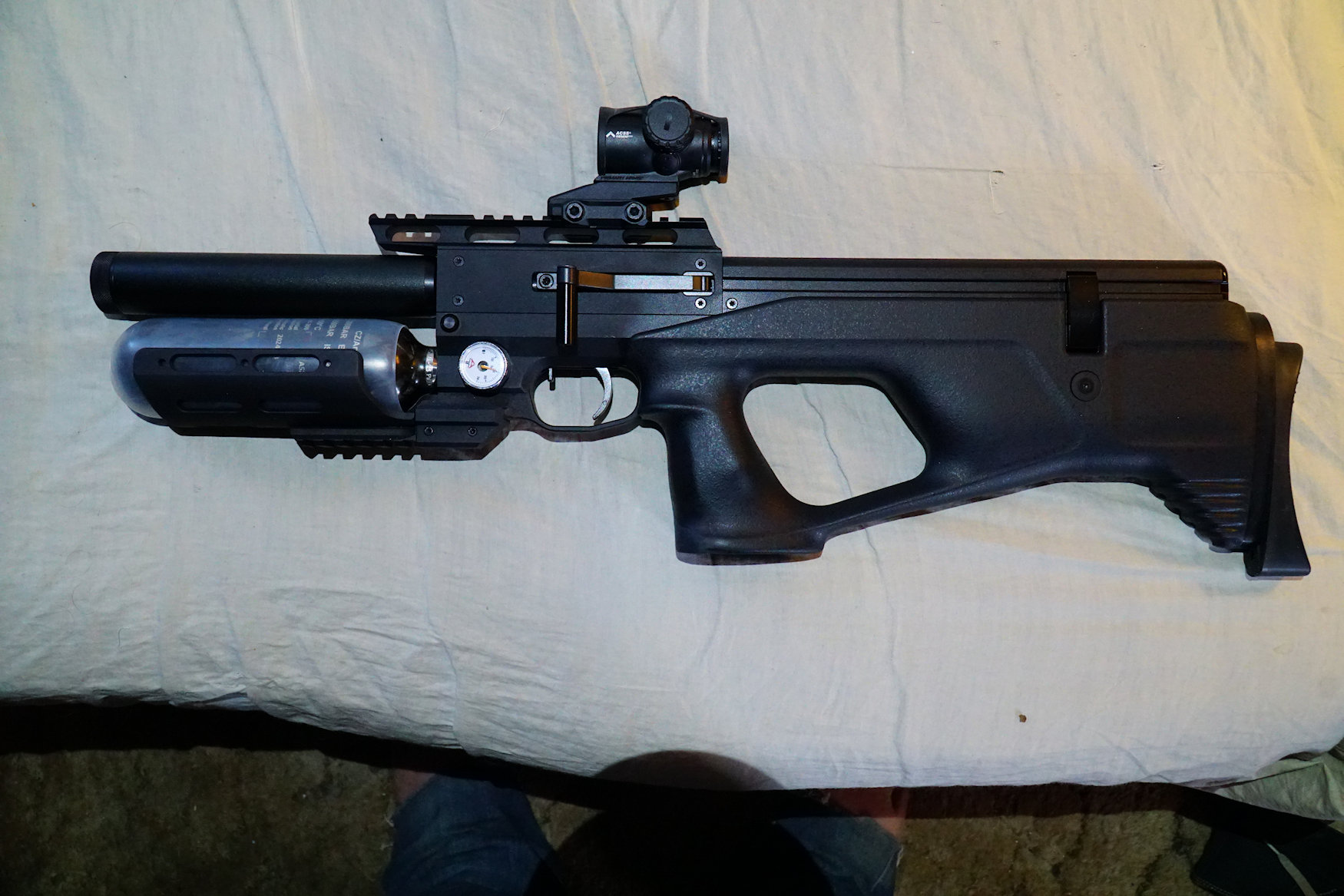

I've covered a few of mine in clear (translucent) Shrink wrap, if there's enough room between the cylinder and the barrel. Mostly for protection. I covered this one, "before" I got the hand guard.
Mike
