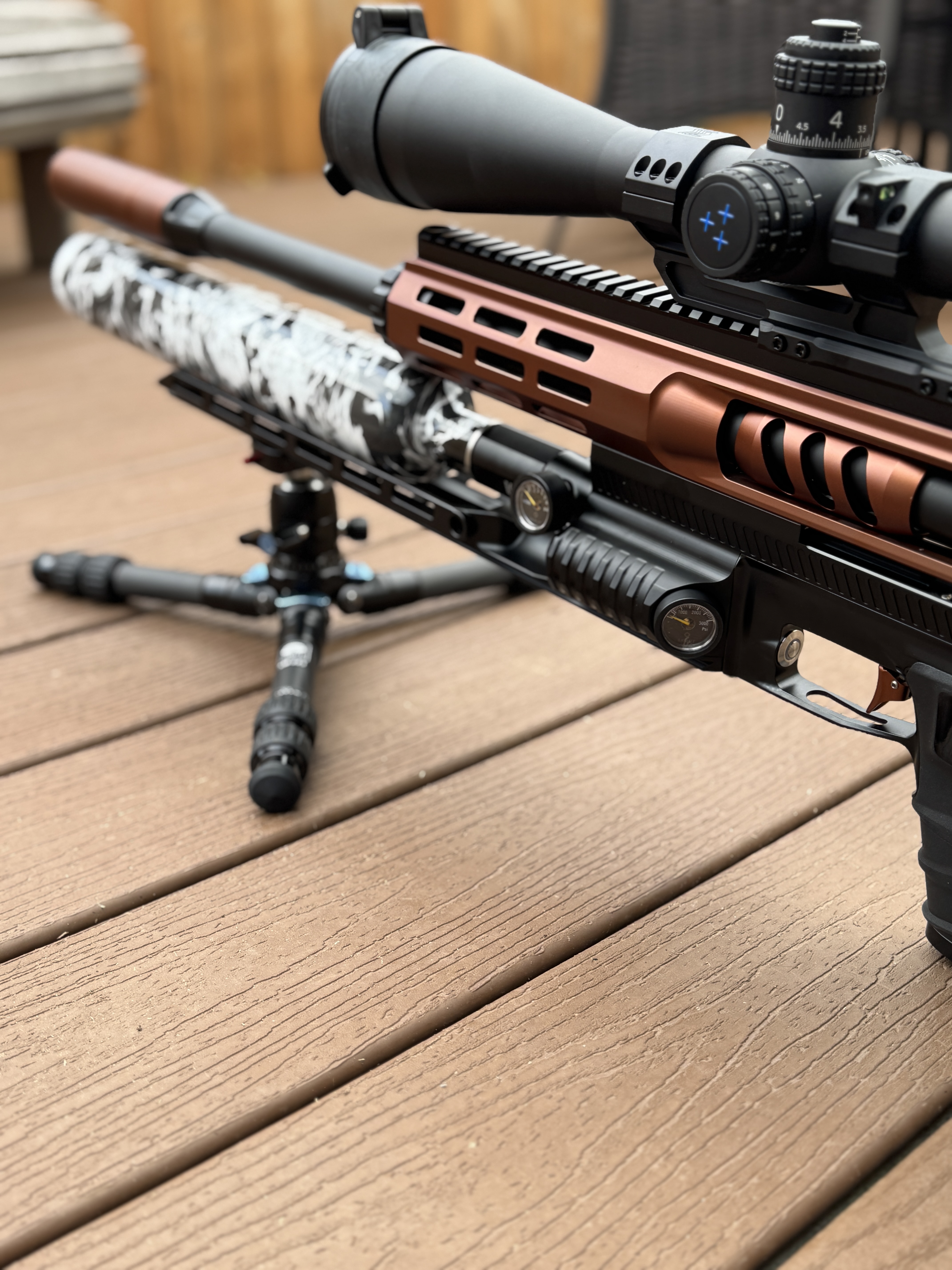

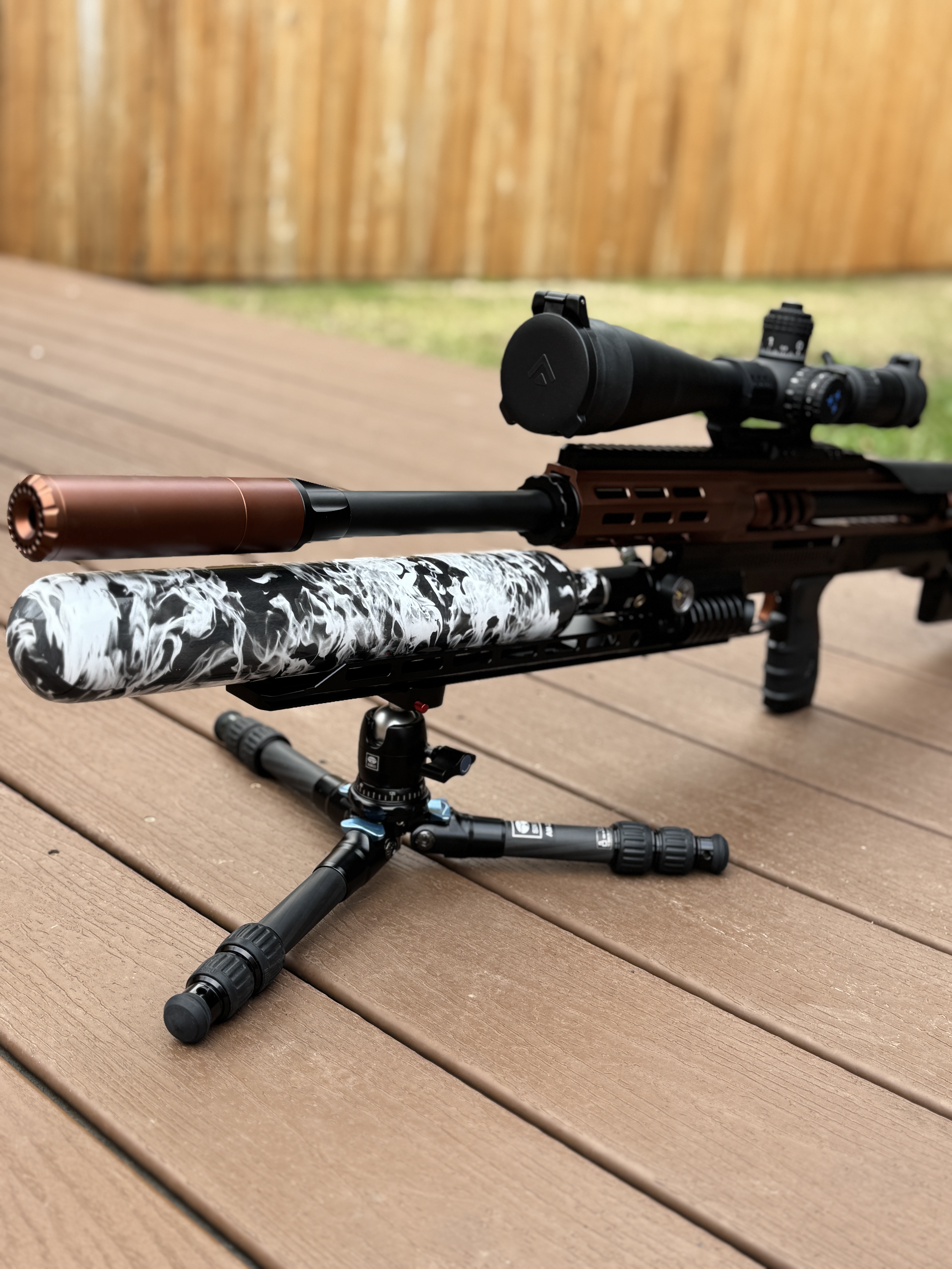

Well everyone here she is in all her glory with my custom tank.
