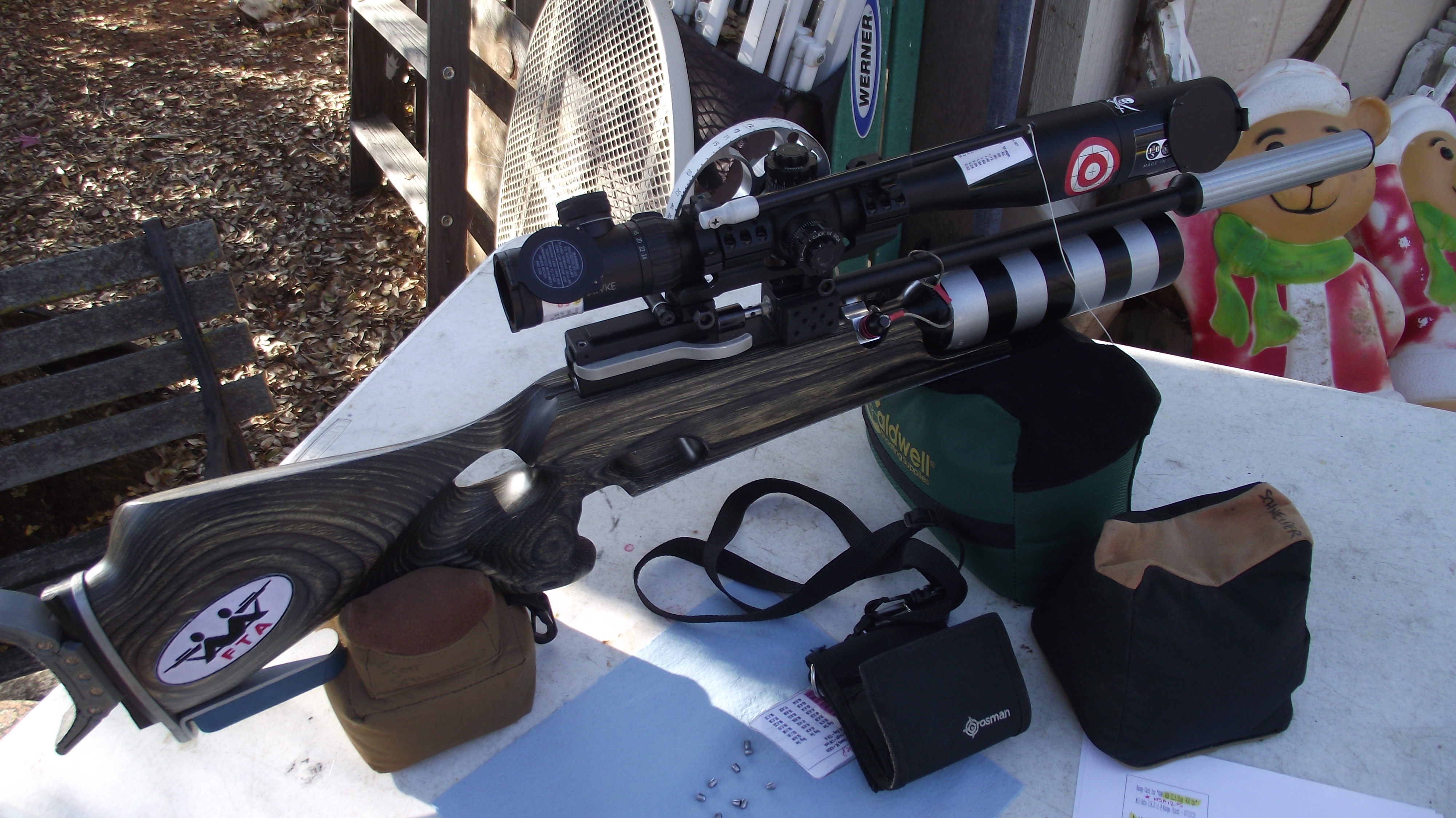

Done painted too ... Tho on Aluminum where some scuff prior to paint can be done. Not so sure I would be comfortable scratching up an CF wrap bottle for painting :oops:
Reactions: MSR Workshop
Lightly scuffing the clear coat will do no damage and your paint will adhere. I would not do that as I prefer seeing the CF tho a ding or deep nick should be visible.
Can sure see by the posted cut up bottles that Alu. liner is relatively thin, yes it looks pretty husky until the pressure is considered. The reason the SCBA bottles are clear coated is the ability to inspect the exterior for damage to the CF itself. I Iike my survival suit bottle sleeve a lot. The bright red color is good too.
I'll wager that the main strength of CF tanks come mainly from the alloy and most of the tanks supplied only have a minimal layer of CF over the top which will give extra strength, but I doubt they rely on that, and looking at most tanks the transfers that have been applied will have to have something over them and I would be surprised if it wasn't just a coat of 2K clear or matt.

The epoxy resin in the CF tank should be fine for any type of paint you can buy including automotive. What I am not sure about would be the clear coat over the tank. Epoxy paints are not UV resistant thus they typically use a clear urethane or lacquer to protect from UV radiation. They may not do this on airgun tanks thinking they won't be in the sun long. Anyway I would use a polyurethane paint along with a catalyzed clear. Though in reality any rattle can paint would work just not as durable.
You are probably correct, but at 4500psi, the words "Should be" rate right up there with "Should have".
Paint it and probalby never have a problem, but I will just leave mine as it is. I am not entering my gun in a beauty contest.
Reactions: Sicumj
We are repurposing a highly engineered product. The manufacturer has good reason to use clear coating. The clear coating permits exterior visual inspection of the reinforcing fibers that give these thin aluminum bottles their strength. Consider a fabric removable cover rather than paint to permit that important visual inspection. The clear coating allows a very good view of the underlying filaments.
