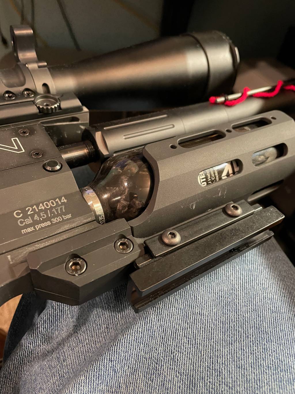

I'm hoping this is the year I will be able to get into FT a bit. I'm setting up my Uragan Compact .177 for the task but not sure what to look at for a palm rest setup.
There's a small pic rail between the air tank and rigger. I currently have one of the small Saber ARCA adapter on it. I also have the UC aluminum handrail which give a bit of a longer pic rail on the bottom.
Where I am struggling is that all of the palm rests I see are designed to attached either directly to a stock or to a UIT/T-Rail. I've tried to find an adapter that will go from either pic or Arca to a T-rail - but I'm not finding anything.
I'm open to getting creative and was thinking maybe there was a way to attach an arca mount to a palm rest riser somehow?

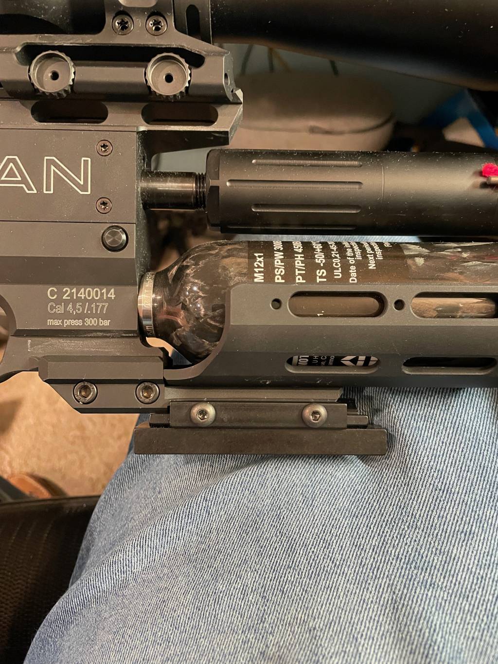

Did a quick search and I found a Pic to MLok adapter and a MLok to UIT adapter so going to pursue that route before pulling out the drill.

I got some parts in this week and would like to reiterate my thanks. The two adapters together give me a nice UIT slot.
