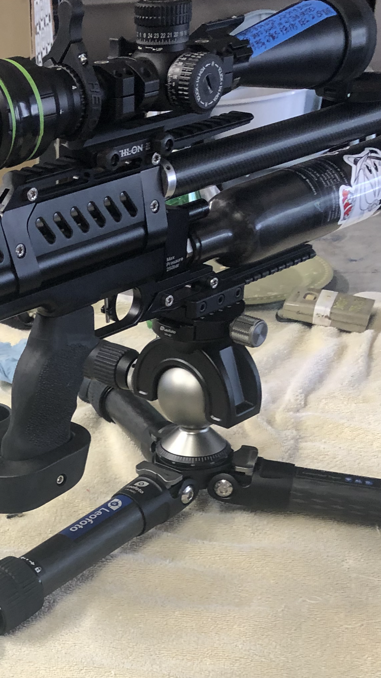

The US price on the Innorel N52 is about $100. Rock solid choice.This ballhead
With this tripod are both similar to what I have. This tripod might be a bit better quality than the one I have. Canadian prices if it shows C but might auto adjust to USD if you look at it. Would be a great setup will have no issues locking tight with any weight airgun (within reason) and light with the cf tripod. I love mine.

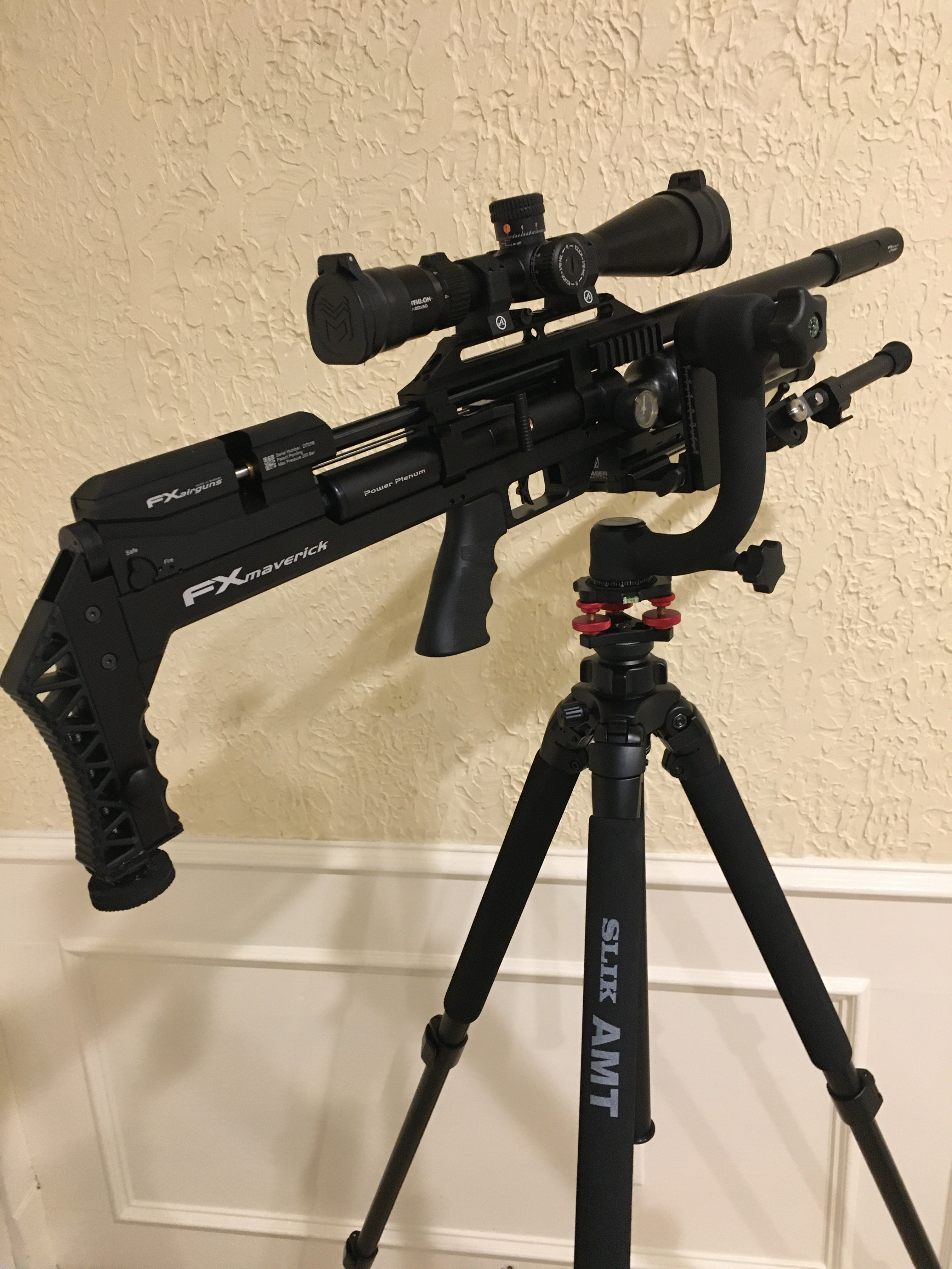

You set your tripod legs into plumb, and with gimbal you can run around the tripod 360 up and down hill shots, the bubble stays.... Honestly never even looked at gimbal. ...
Of course there are pros and cons with every solution, ballhead, panhead, levelhead or gimbal...you work your way out for your hunting games.

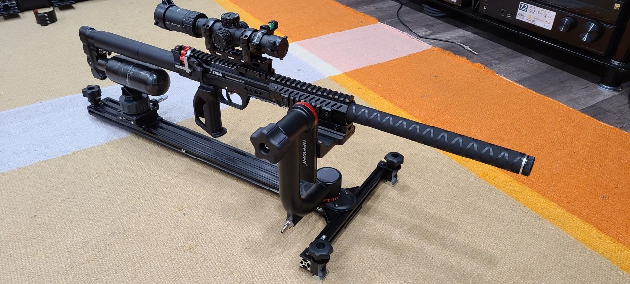

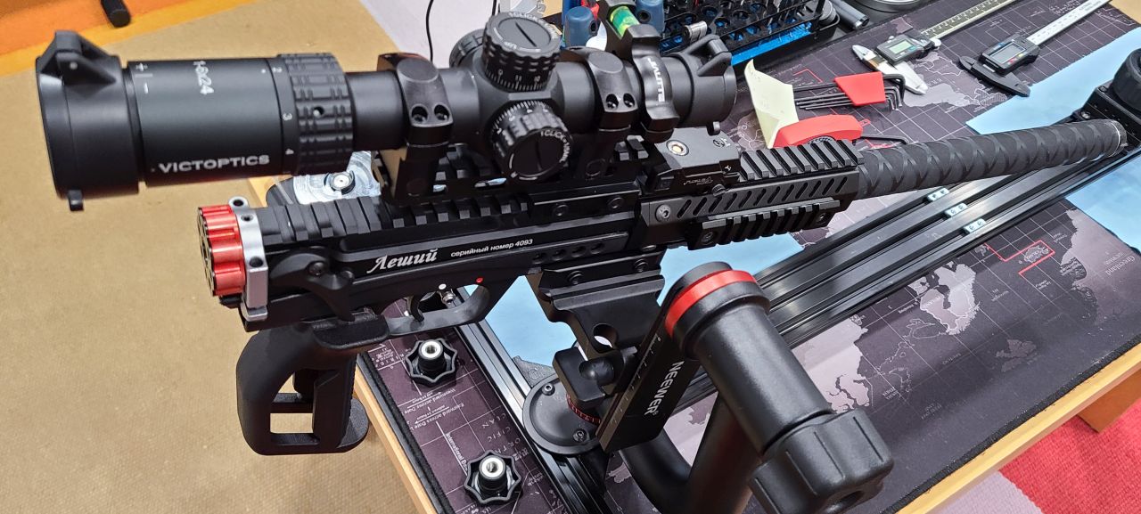

Yes, I am using my L2 with a tripod and levelling head,What about for a Leshiy Classic or a Leshiy 2? ....

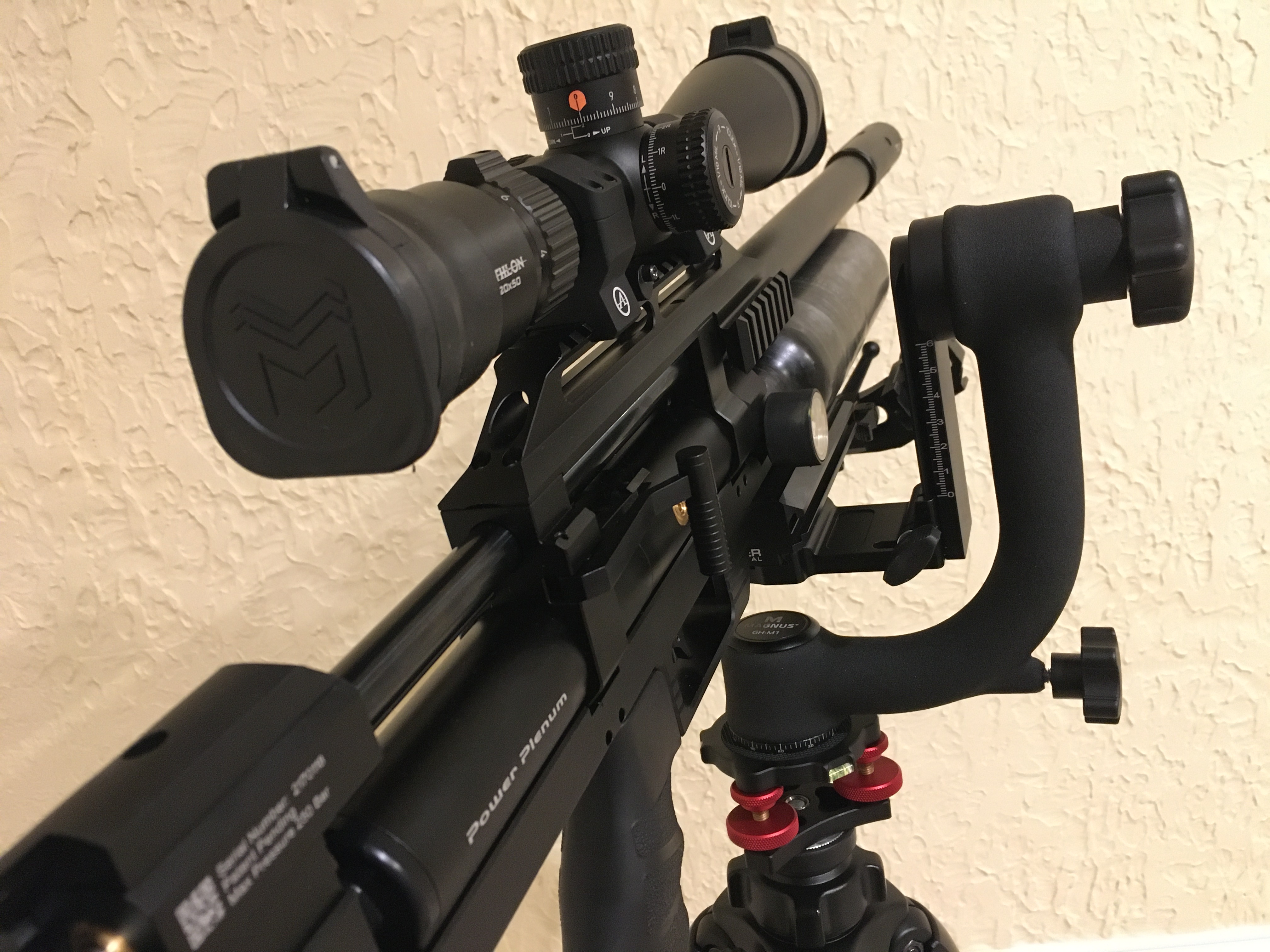

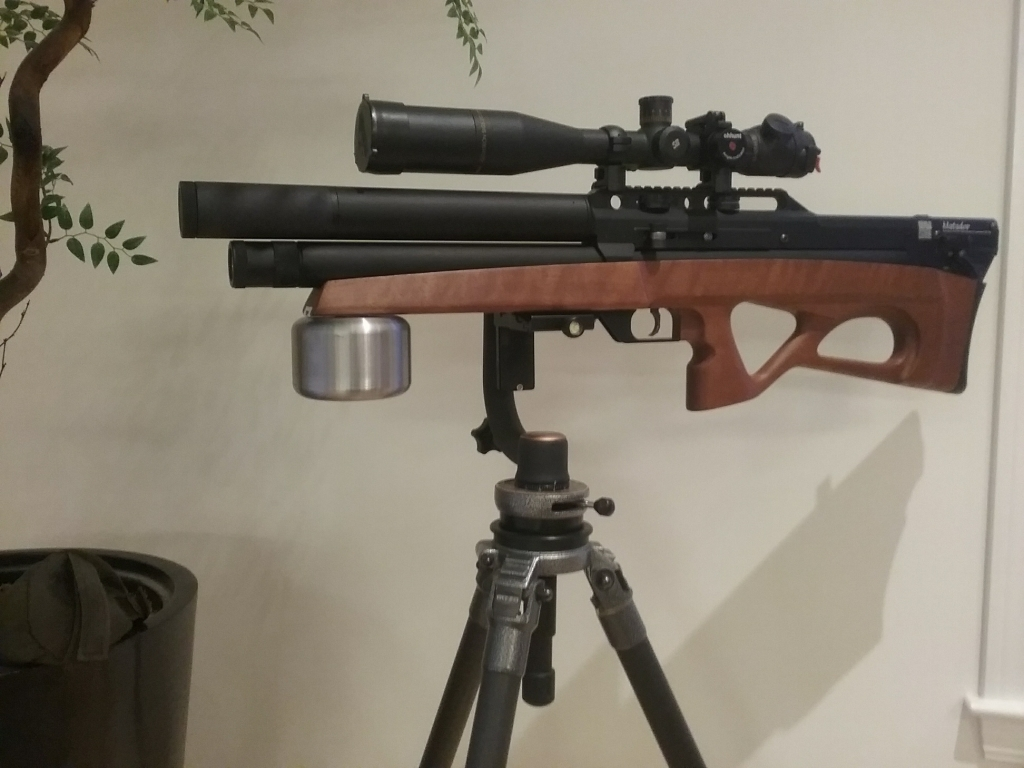

If weight size and portability is not an issue IE your are stationary, I would vote for a tripod with a leveling base with a gimbal head. You can balance the gun so basically weightless moving in any direction plus once you level the head you never have to worry about your gun being canted.
But isn’t that what our anti cant levels are for? To check for and prevent cant?The problem with ball heads, the MH-35 included, are that the gun's center of gravity is above the pivot point. So the gun will have a natural tendency to tilt either canting your rifle or moving the muzzle up or down or both. Each time you loosen the ball to reposition your aim you cannot ensure that gun isn't canted. Using a leveling base and gimbal you can position the rifle so that the pivot point is at the gun's center of gravity so I will not move even if it head is loosened. Also the gun will never cant even if you pan 360 degrees or 2 Pi radians. Before the gimbal I used a ARCA B1 I had for photography, it a high end ball head and it sucked in comparison to a poopty made in China $70 gimbal head for stationary tripod use. Now a high end gimbal with good fitting bushings or ball bearings would be even better but $$$.
