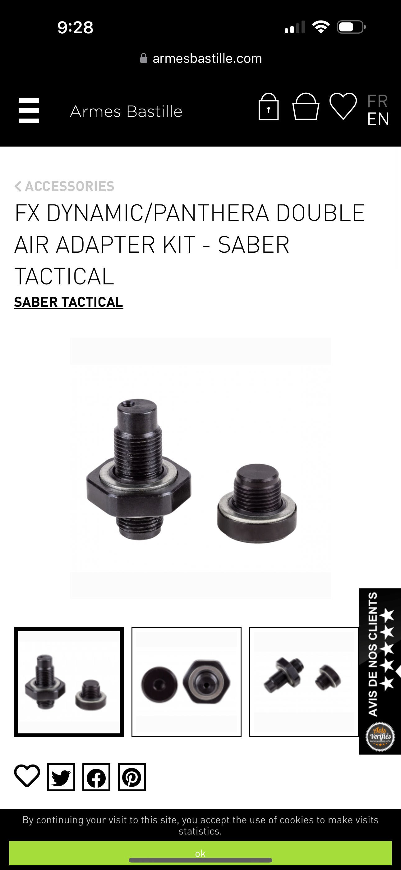

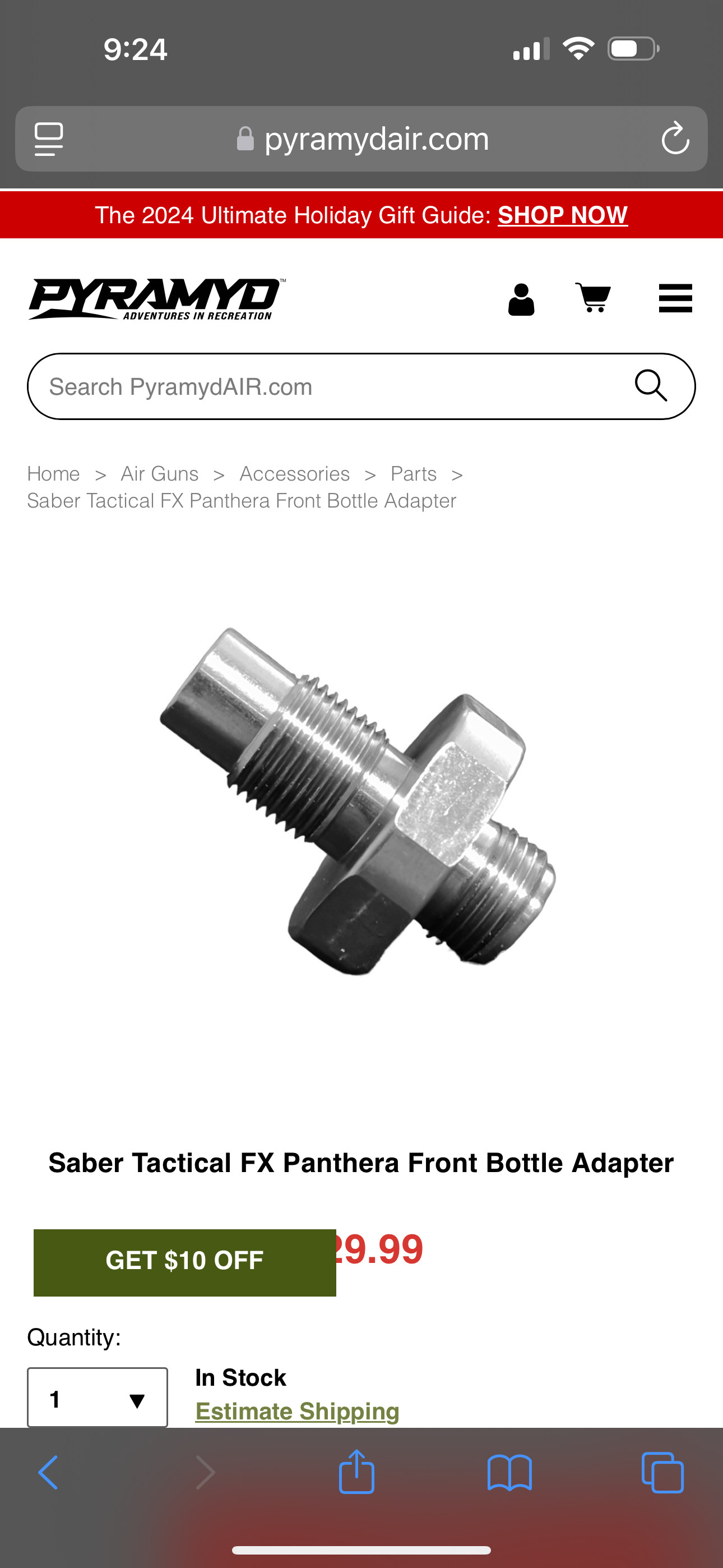

Hi racer just to clarify this is the piece that you need for both ports, correct? Depending if you already have it at front or back this is all that’s needed pic with one adapter. Since I have the Panthera Hunter compact the port not used already has the circle plug such as the picture with two pieces. Sorry for the confusion just trying to buy the right parts.
