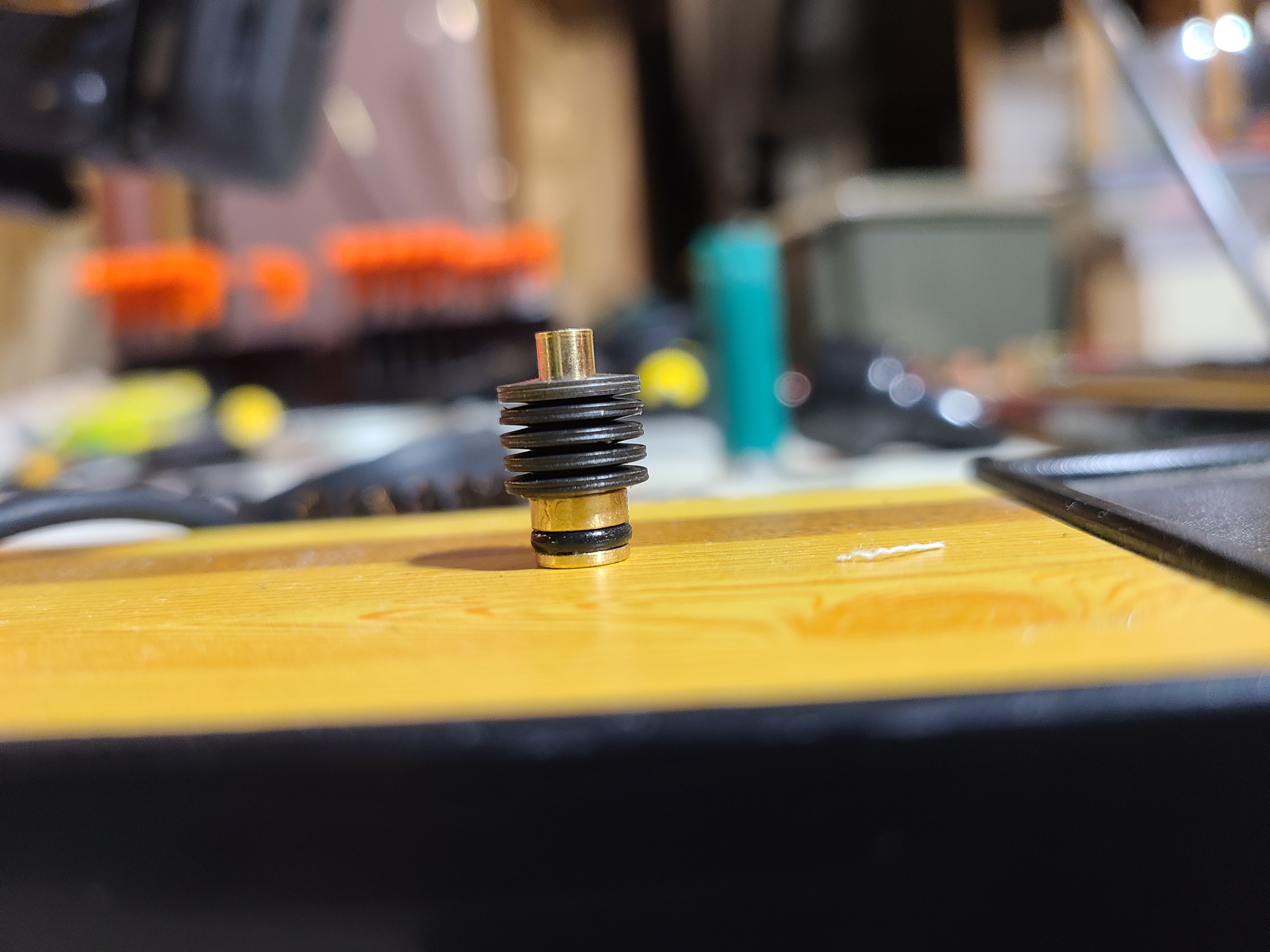

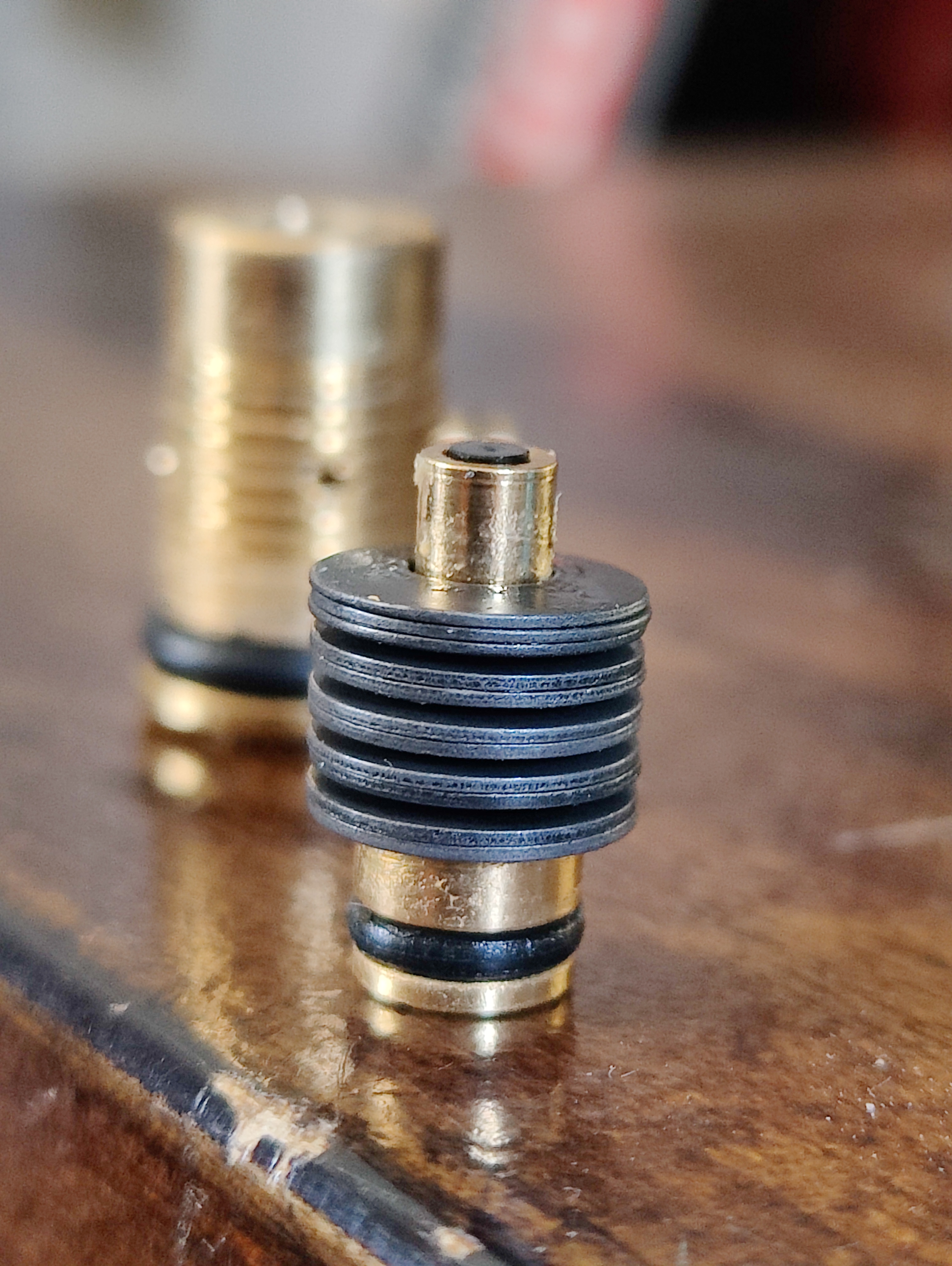

5. Photographed the piston and washers and inspected the arrangement for reassembly:
From the base there are four pairs of darker, thicker washers in the arrangement ()()()()
On top of those, moving upwards, we have three lighter washers in the arrangement ())
6. Inspected all orings and found no issues. Wasn’t expecting any given that gun is new.
7. However, the delrin face on the piston was dimpled (sorry couldn’t take a good pic, really hard to see). That’s totally consistent with the problem.
