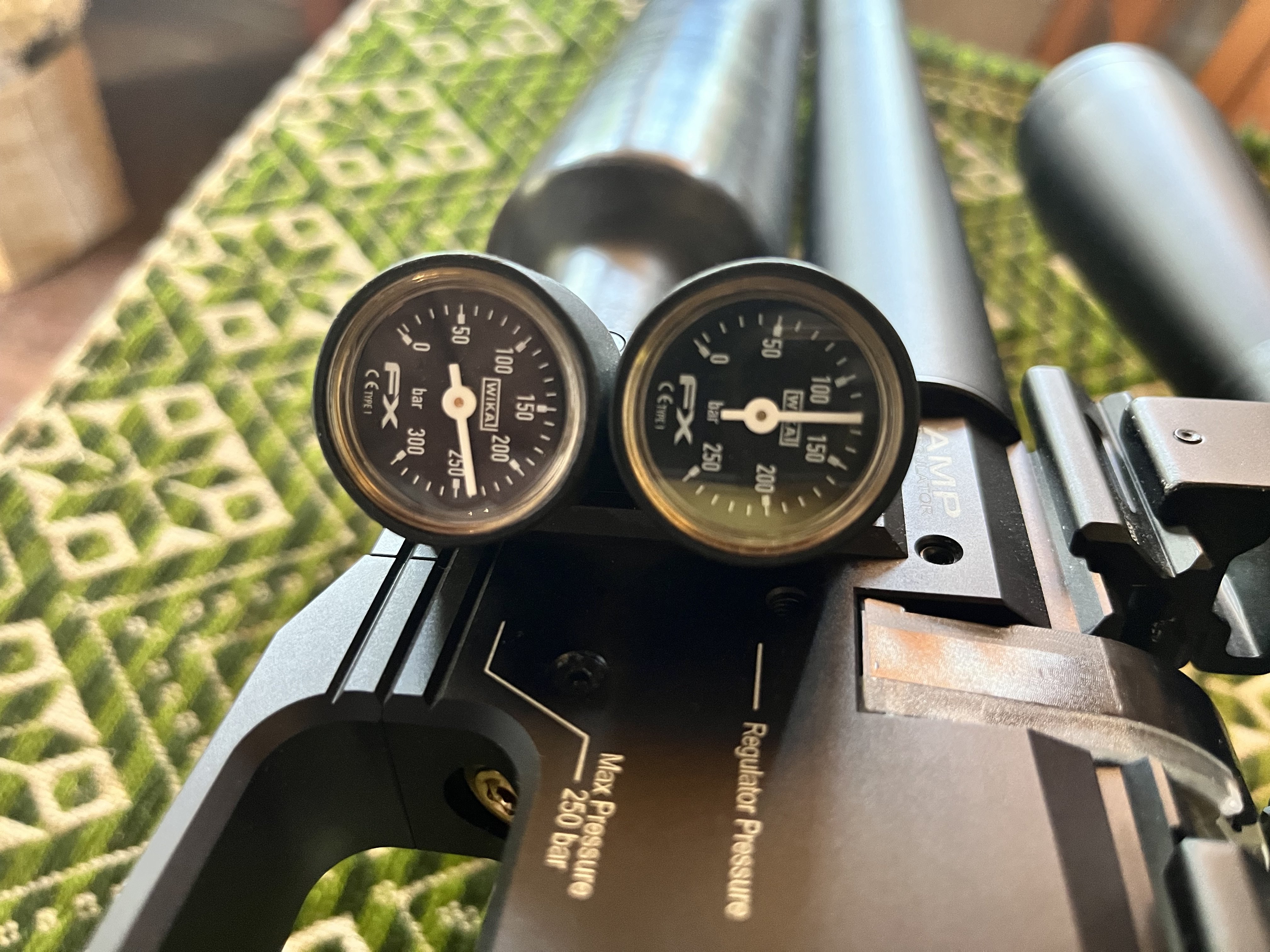

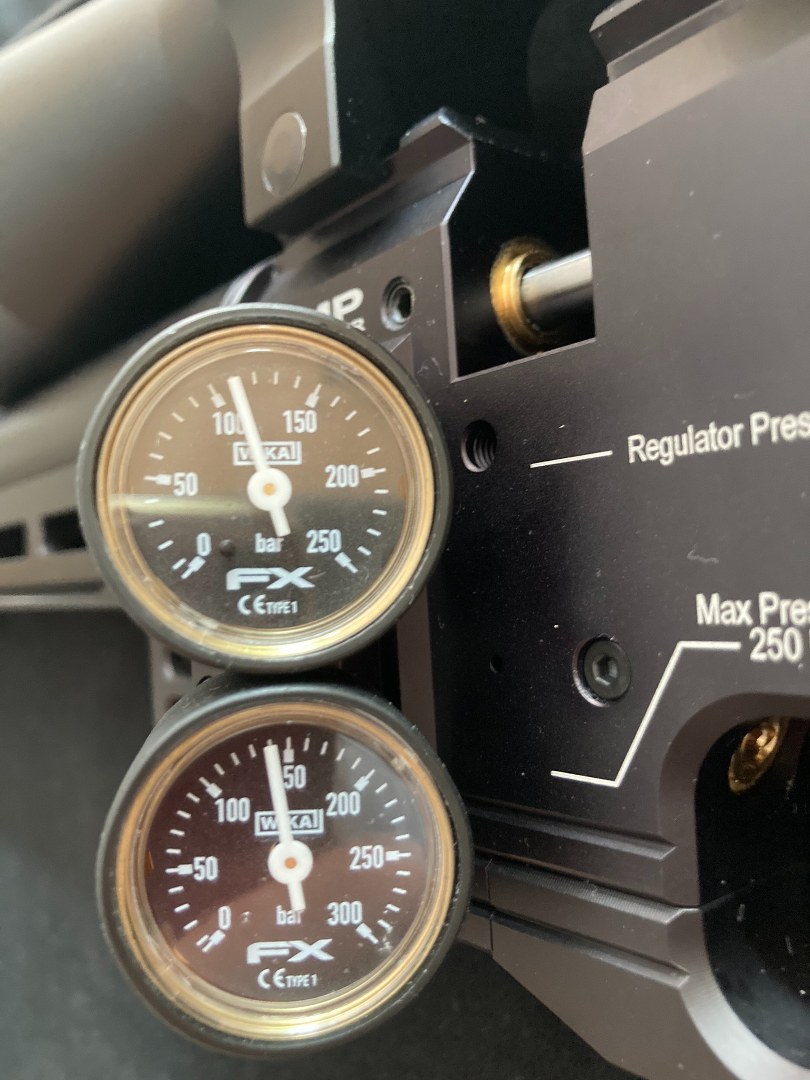

Regulator pressure was set at 110 bar at the factory so I let the regulator alone thinking FX should know what they’re doing. Turning the power wheel to 13 and slowly increasing hammer spring tension with the barrel adjuster got me to 194 m/s with FX 25.4 gr pellets. At home I’m shooting at 25m and the accuracy wasn’t all that great. At the 50m range it fell apart even further. Weird flyers and pellets wobbling through the air. A single 250 bar fill barely made it through two magazines (32 pellets). Back at home switched to the heavy 34gr FX pellets. Accuracy leaped forward, although one pellet every magazine managed to stray every time and pellet speed dropped to 261 m/s with these heavy pellets.
After a few days of turning knobs I finally gave it two clicks less on the barrel adjuster and landed at 260 m/s average speed. Air consumption went down as I can now get two magazines with room to spare off a 230 bar fill (divers tank dropped to 230 bar). And the gun is a bit quieter now.

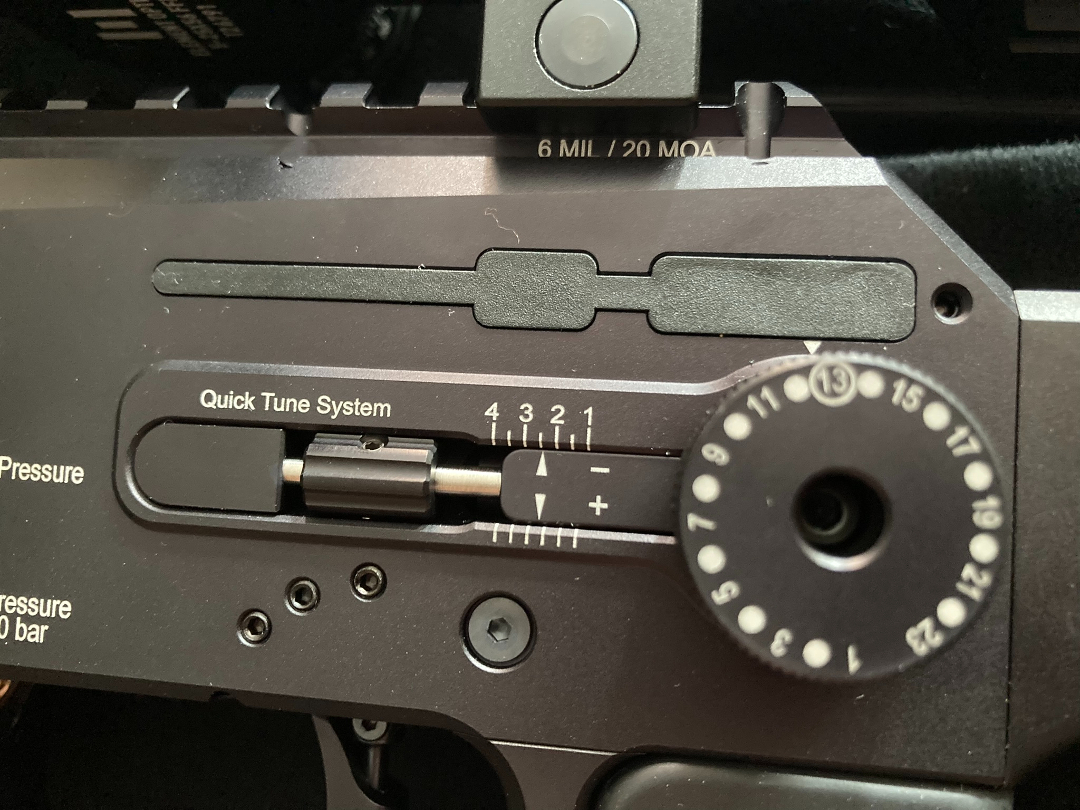

Tune settings:
Tune settings:
View attachment 372153 View attachment 372152

I have been tinkering with my 500 a bit more today, setting the regulator at 115 bar and upping the hammer tension. The gun now shoots at 267 m/s average with an ES of 4 m/s and an SD of 1.4 m/s, resulting in just under 80 joules. Perfect for shooting outdoors in windy conditions.

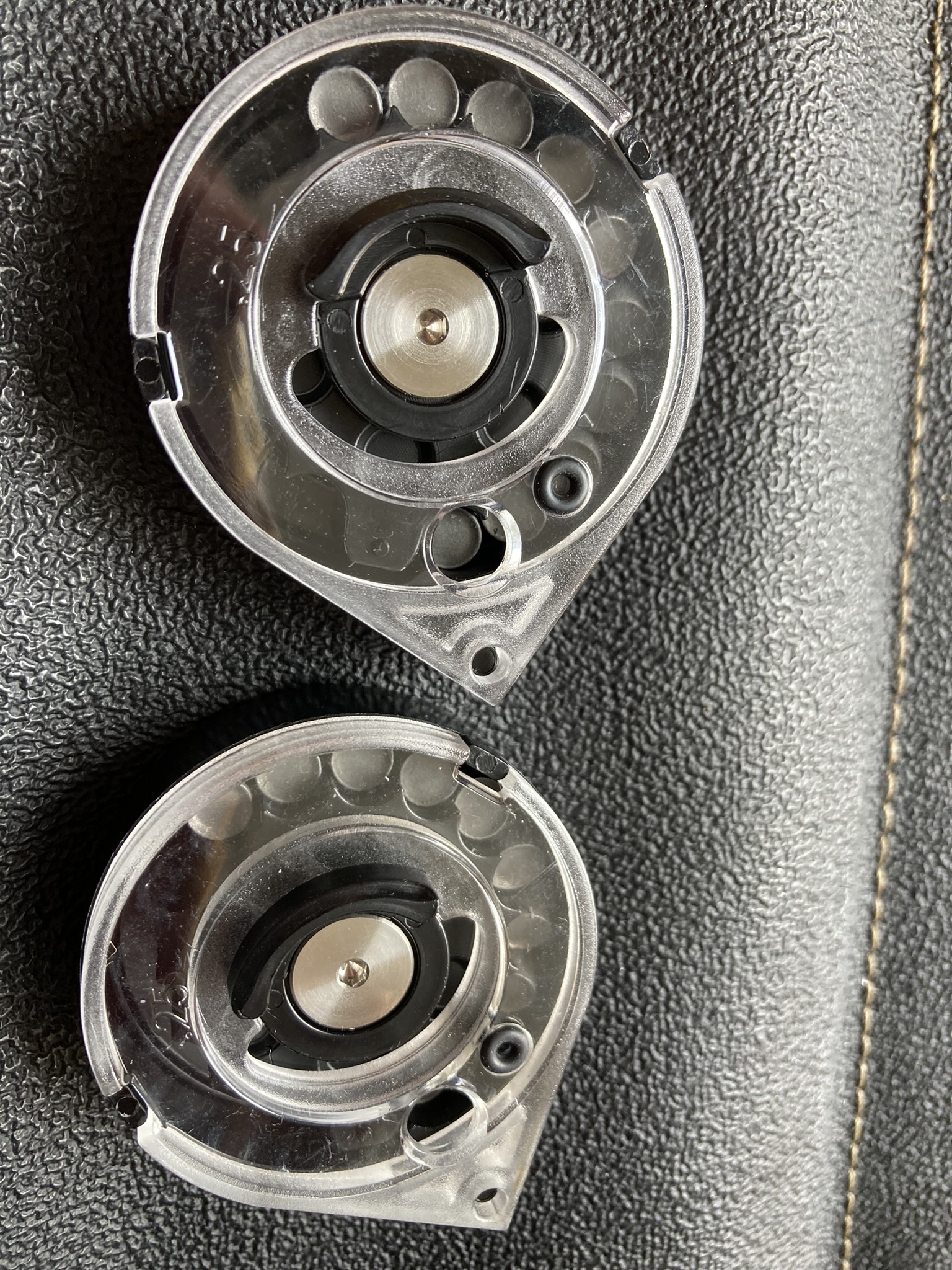

Results weren't great. The ZAN slugs looked weathered and even a bit corroded. The 26.5gr variants locked up the magazine several times due to poor fit (photo bellow) and failed to feed about 2 to 3 times every magazine (10 shots). They also gave the poorest results, barely hitting the 14cmx14cm target.

If your reg is to low you will waste air because the valve is opening to much at the hit of the hammer. If your reg is to high the fps will decrease because the spring of the hammer will not open enough the valve.

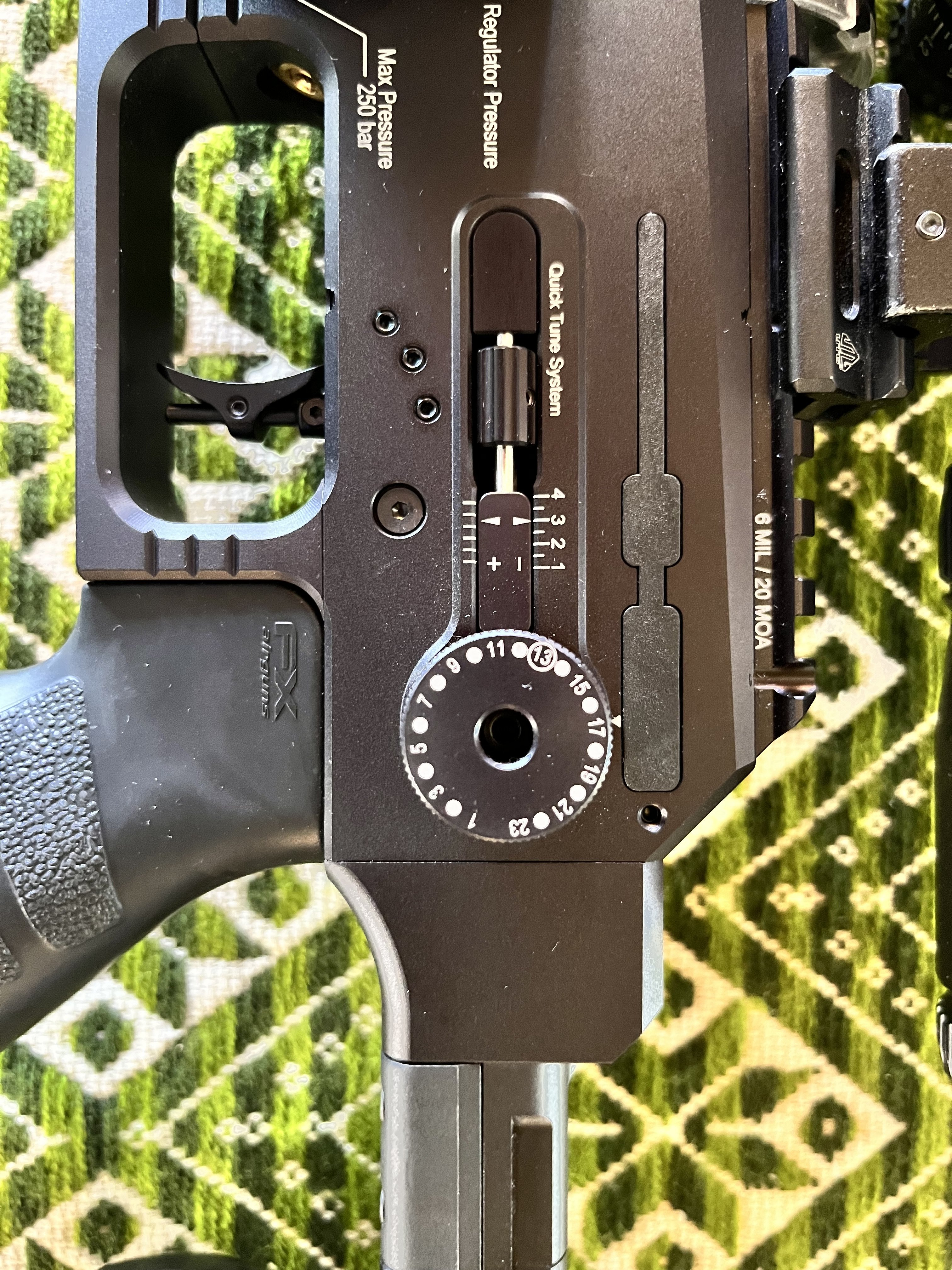

This is the setting where my Panther hunter .25 Cal lives:
View attachment 377950View attachment 377949
Do you get some consistency with your Panthera at these settings? I couldn't get any consistency or accuracy with mine at 120 bar in combination with 34gr FX pellets. Turning the micro adjust above 2.75 didn't give me any extra velocity, only erratic POI shifts.

I guess so. Back at 115 bar with the micro just over 2.5 and everything is back to normal. The velocities aren't as consistent as before, but everything needs to settle down for that.
