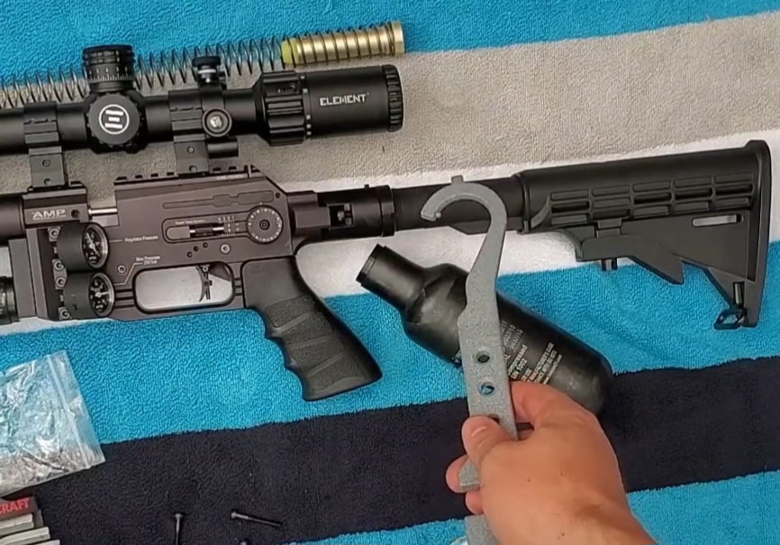

Attached a pic just for reference; bipod on it now is a place holder. Will put on a cyke pod or atlas.

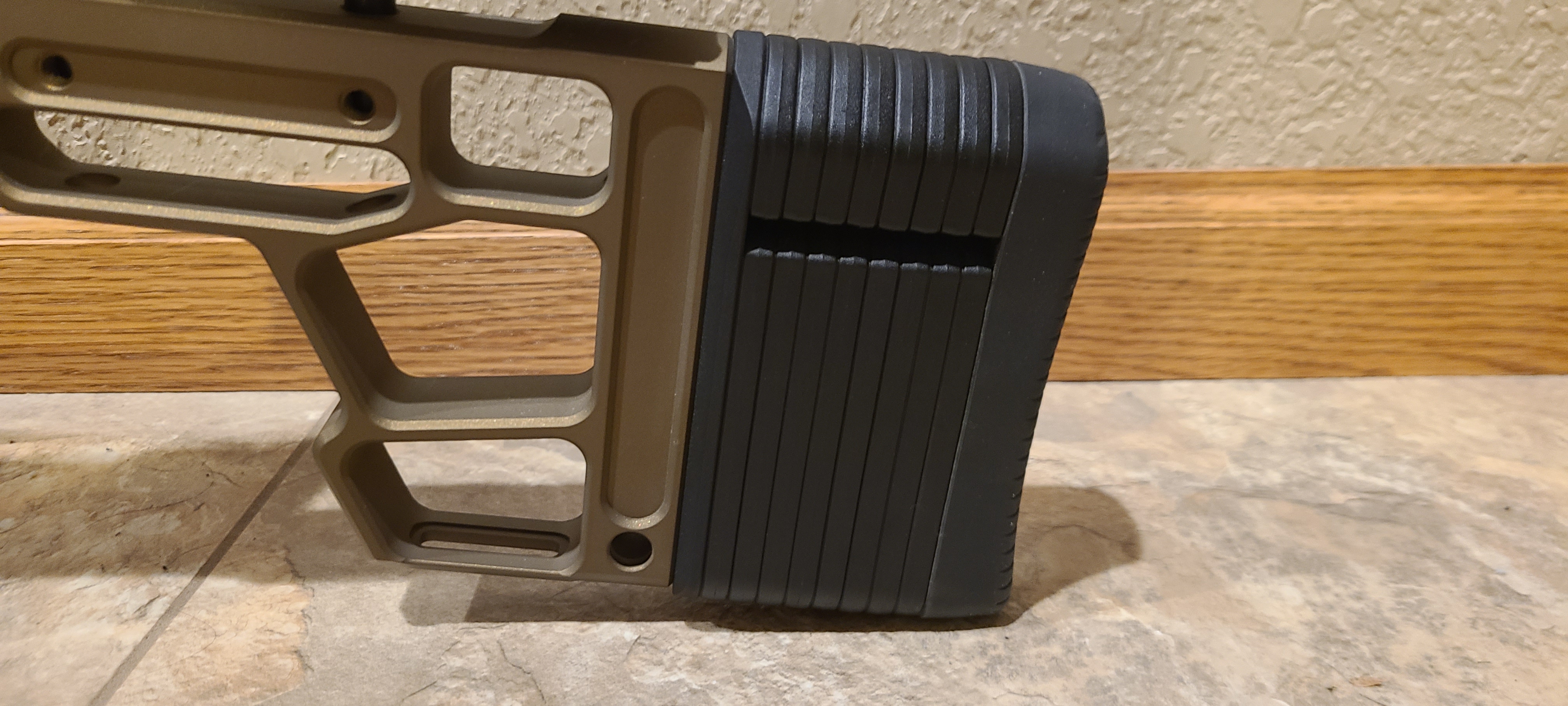

I have the same issue in that I'd love to shorten it by at least an inch, but I can't find a way. I removed the Dynamic rubber butt stock and taped a piece of foam in the hole, which got me a 1/2" back ¯\_(ツ)_/¯

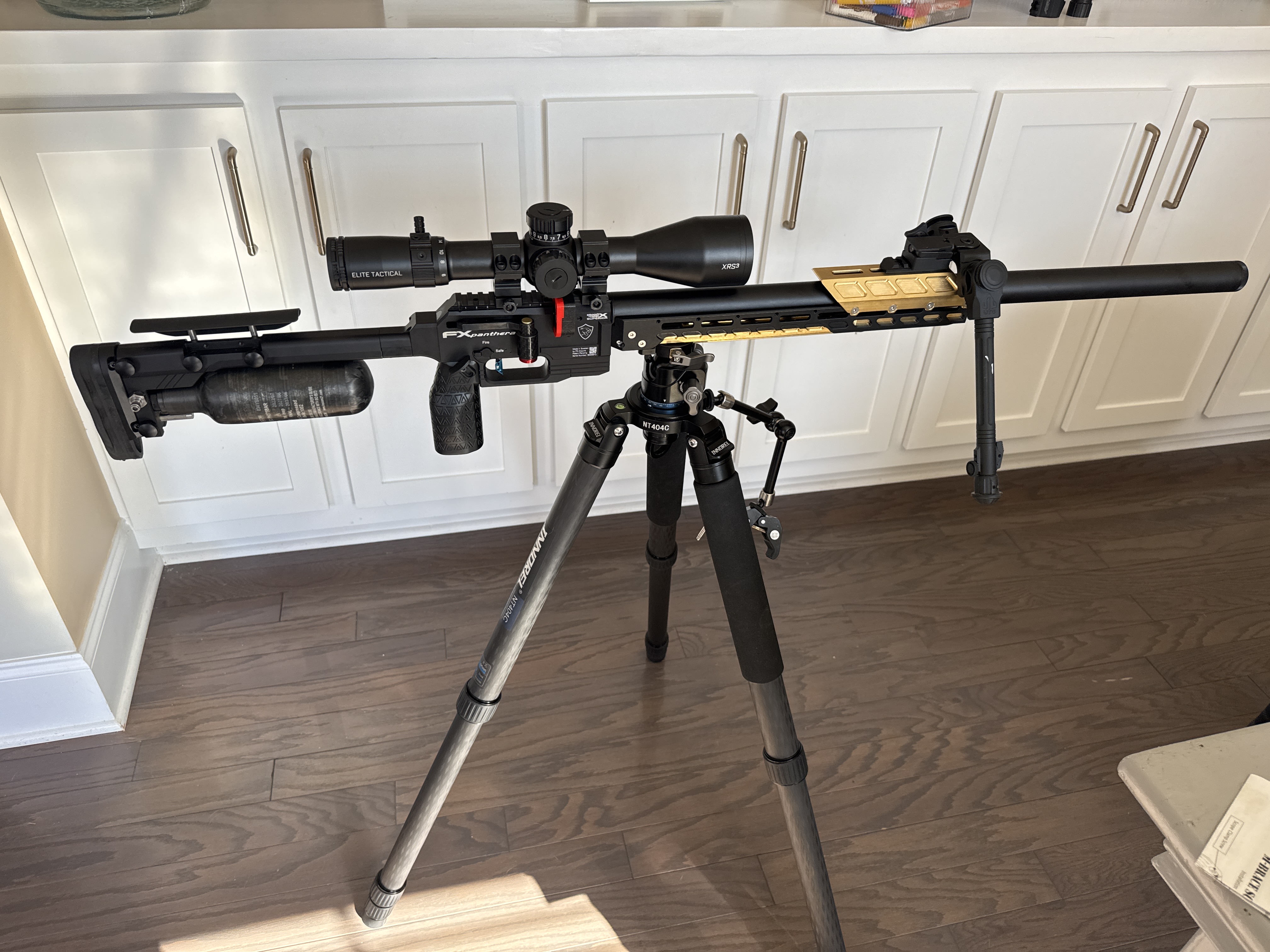

I can't tell exactly but are those LOP spacer shims on your gun?! If so you must be very tall.
I had the same issue as you when it came to not being able to get my scope far enough away from my eye on the Panthera platform. The solution I settled on was a pair of offset rings that might be hard to find atm since they were recently discontinue. The rings are the UTG accusync model air422s (34mm). The front ring will have to have the front most lug machined off of it to fit the picatinny section forward of the magazine. This shouldn’t be hard for you since you indicated that you have the needed skill set. I lapped the pair I installed and they haven’t given me any problems.
If you use a 30mm tube scope, and if you don't care how much you spend, and if you are lucky enough these would move you far enough forward and not interfere with the magazine, and if one of the two heights available would work for you.... A lot of if's... You could buy BOBRO aimpoint pro single ring cantilever mount, two of them, at over 150 each, 180 or so on the manufacturer's site. I've seen one in the wild, very well made.
Also, larue tactical makes one, only 1.7" above rail centerline on theirs, and they are 200 a piece. Unfortunately, ADM quit making theirs, a much lighter option, and the last clearance ones are all gone, they were only 75 a piece on clearance, 150 normally.
